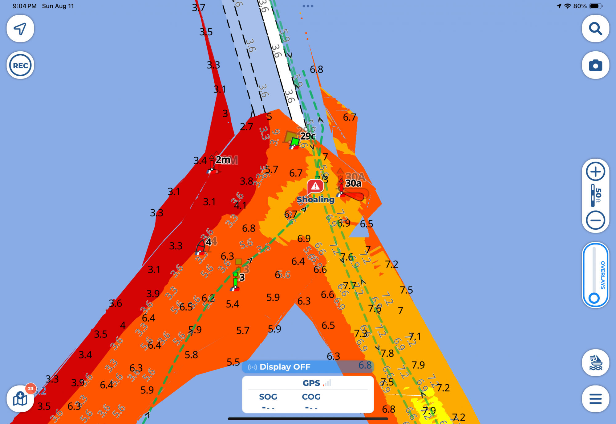

I went through there in June and this is absolutely correct. But the channel is generally around 7-10 feet or more. Around Roanoke Island and south of it you MUST stay in the channel or very likely run aground immediately. The buoys are moved frequently to keep pace with the changing shoals, so while you should use your charting app to “stay in the lane“ you should prioritize buoys over charts if any conflicts are observed. The same goes for buoys that have a number and letter. Where there is a numbered marker-post you might see a buoy near it with the same number but a letter added (e.g. 6a should be followed instead of the nearby 6 buoy or daymarker). Call the local towboat operator for local guidance - I haven't done it often but the few times I did they were more than happy to help with up to date local knowledge. (These guys really want to help people, and they know all the trouble spots.
I highly recommend anyone doing the ICW to subscribe to the highest “unlimited tow” package with TowboatUS or SeaTow - or both.
One trouble spot is the channel junction at the entrance to Manteo. Buoy 30a and 29c were VERY close to each other in June, and it’s critical to go between them. The 3.x ft charted depths are outside the channel - there was at least 7 ft of water in the channel north there and going around the top of Roanoke Island.
It’s also critical to know that buoy 29c is part of the N-S channel and is NOT part of the Manteo entrance. If you keep that buoy on your port as you turn into Manteo entrance channel your boat will stop immediately! (This is sandy bottom, but it can still ruin your day). Green 3 and red 4 are the pair marking the entrance - stay away from the red and favor the greens all the way in. (The green dashed lines are my tracks).
edit: Chart shown is from Aqua Maps with USACE depth survey overlay displayed.
