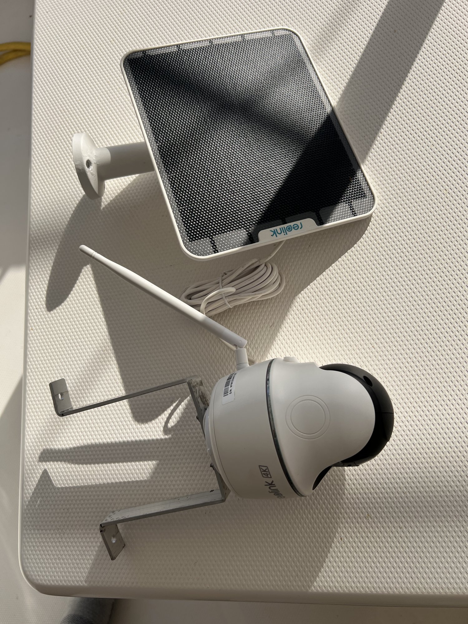

REOLINK Argus 3 Ultra, 4K Solar. The solar panel is mounted near the cam on the side of the mast, and the cam is on the masthead top plate on an aluminum bracket I made using stock aluminum bar 3/4” wide x 1/8” thick, bent to form a bridge that raises the cam just higher than the anchor light (so the light isn’t occluded by the cam).
Reolink is the only wireless cam brand I found that doesn’t require an internet connection to function. If the viewing phone or tablet is on the same local WiFi network router you can watch the cam without using Internet. That translates to lower latency, and higher availability in remote places. Cheaper connection costs too if on a metered network (e.g. prepaid SIM card).

It is worthwhile. The first cam that I used was the Argus PT 4k but I found out the hard way it could not be mounted upside down because that inverted position defeated the waterproof design. So that was a fail for me. No simple way to mount PT above the anchor light in the waterproof orientation.

This was the original design that failed because the camera cannot be mounted in that position without flooding from rain. The Argus 3 ultra 4k can be easily put on this bracket without that problem.
if you designed a bracket that comes up wider and higher, mounting the PT camera beneath the bar, and you don’t mind the occlusion of the camera lens in two positions of your panning radius, then a modified design could work for you
Don’t forget that the PT camera has a fairly wide field of view, so having the legs in the picture would affect a large range of angles.

It is necessary if you want your anchor light to be seen all the way around. Just another thought; you could use a straight bar coming up from the side of the masthead and mount the standard wall bracket that comes with the camera onto that bar, positioning it a bit higher than your anchor light, so your light can be seen.
Or two thinner bars, for better anchor light visibility
