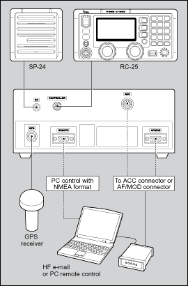

Hi all,
I have had an Icom M802 aboard and I’m looking for options to connect it to GPS. I have a Furuno GP39 that is wired to the autopilot and wondered if I could link to that? The other option would be finding where the VHF is getting the Lat and Long from. This should be simple if I can locate the little wires behind the navigation panel.

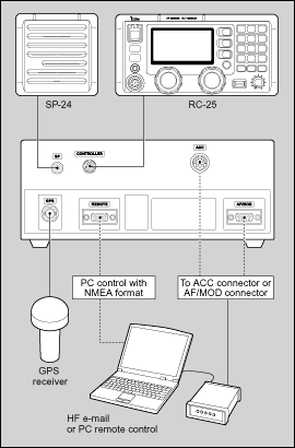

Yep, saw this diagram and wondered how to do the connecting. The GPS unit should have a 0183 connection port. Or a bundle of little wires that connect using one of those little connecting bars.
I just checked the Furuno installation guide and it has 1 port “NMEA0183 V1.5/2.0/3.0: 1 port, current loop USB: 1 port, USB2.0”. So I should be able to find where the little wires are hidden.
On the Icom diagram, would these wires be the ACC port? Or just use a coax from the antenna port?

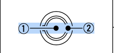

24,760
GPS CONNECTOR [GPS] (pp. 55, 64)
Input position and UTC data from a GPS receiver for DSC operation. (NMEA0183 ver. 3.01 format)
• An NMEA ver. 3.01 (sentence formatters: GGA) com-
patible GPS receiver is required. Ask your dealer about suitable GPS receivers.
GPSPinPin nameDescription
1NMEA +NMEA0183 ver 3.01 (sentence formatter: GGA) data input +.
2NMEA -Ground for NMEA data.

I found a download from Icom with wire pairings for different GPS units, not Furuno but I could just match them. I’ll check with Furuno tomorrow.

After chatting with the Furuno tech, I followed the wires from the GP39 gps unit to the buss bar that was labeled with the pairs of wires. I added the pair I made with coax from the Icom gps port following the + and - diagram. I now have Lat and Long on my SSB radio, but the time is off by 1 hour. Close enough.
