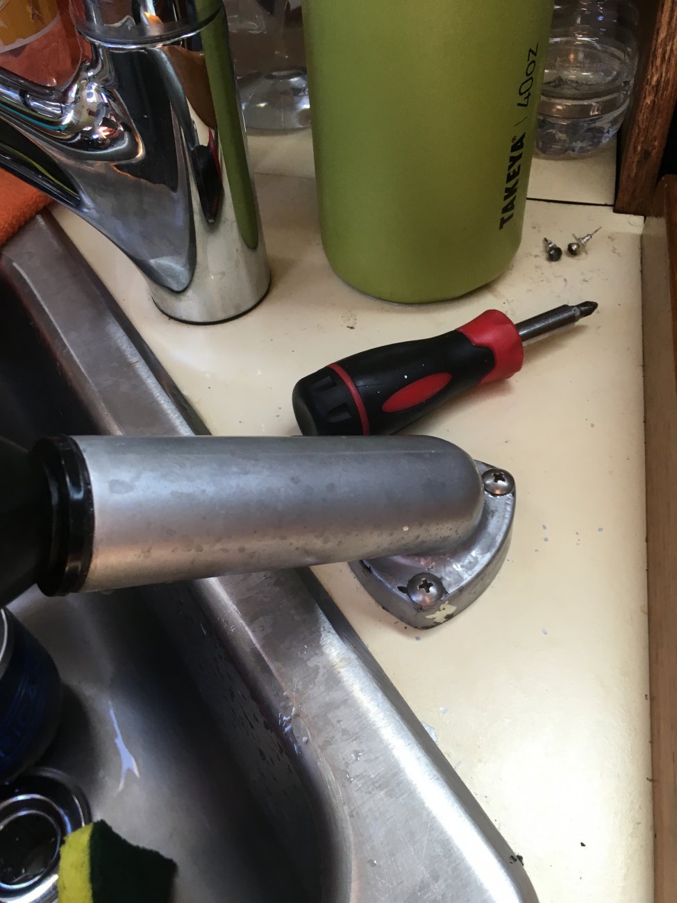

My icebox/refrigerator drain pump is on its last legs. I've have searched every site I know of but can't find either the pump, or a rebuild kit(the diaphragm & related rubber is just about gone) anywhere. Pump still works, kind of, but I'd like to replace it sooner rather than later. I've attached a pic of it. Any possible sources would be appreciated. Thanks!

What I eventually found on mine was that the rubber is shrinking. I use to put soap or a lubricant on it but found it was just not doing it. Finally I dipped it in real hot water and gently streatched the rubber cup-like plunger ( don’t know what you would call it) outwards....... didn’t want to damage it. In my case that did the trick.... when I first bought my Pearson the pump worked fine and at that point I saw a replacement. However when it started to give me issues I could never find one of same style..... I was contemplation a new style pump before I sold her.....
good luck

Thanks for the idea - I cleaned mine up but thought to heat ot and stretch it out a bit. I'll give it a try.
