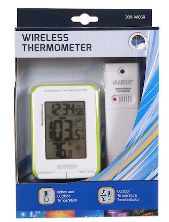

I also found a picture of our remote readout temp. device which was sourced from Camping World.

Our system T-stat tube is clipped to the evaporator per the install instructions, and I see that I might need to seal the four little openings in the bottom of the stock evaporator housing... to sort of allow it to 'fill up' with colder air.
It occurs to me, a bit late, that I should also check directly on the temp. inside the "oval" by parking the transmitter in there. Obvious, suddenly!
The compartment is vertical, and their install instructions said to put the little flip up door on it. I might also want to revisit that idea, too.
