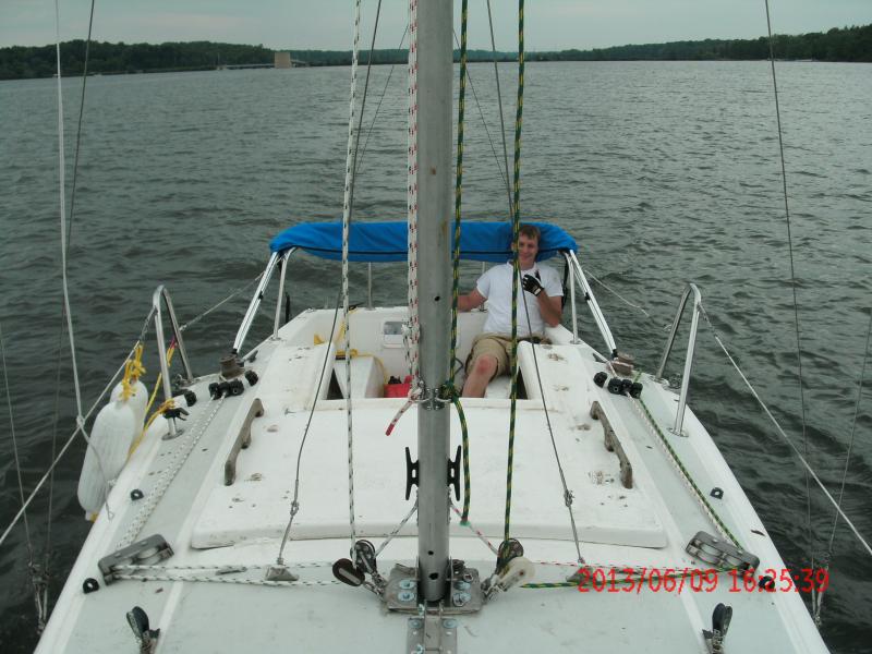

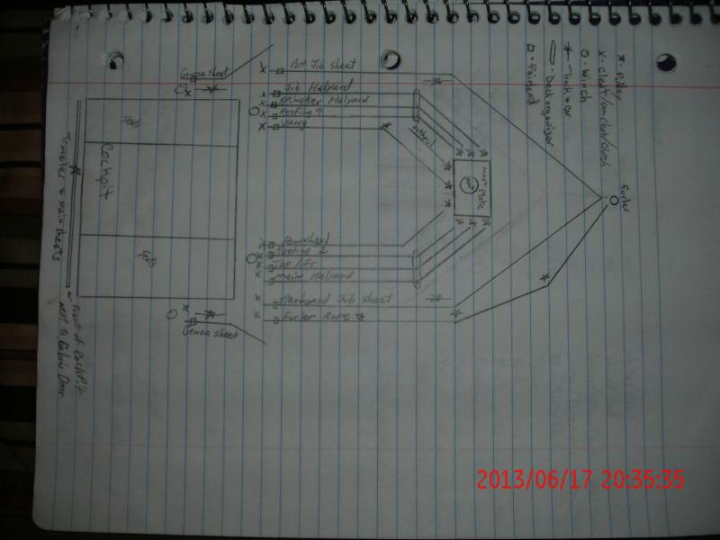

ambitious project.... I had a Mac25, that I brought all the line back to the cockpit... made it easy for solo sailing.... under the mast plate, I installed a block plate.... to the block plate I attached blocks to handle all the lines.. after the block plate, I used a deck organizer to turn the ropes and head them for the cockpit... on the cabin top near the cockpit, I used powercleats and winch to control them... here is a picture drawing of how I set up my ropes on my boat... also a picture of the deck layout with everything positioned... I do not have all the ropes in place yet in the picture... on my new boat (kittiwake), I plan to do something similar in fashion to set it up for solo sailing...

Thanks Jess, that looks like what I want to do. Your organizers are where my ventilation horns are so may need them forward of the mast before coming back to the clutches. I won't be doing too much soloing but want to avoid having to climb on the cabin deck if it gets rough. I hope I am on Santa's good boy list since it looks like an expensive upgrade.
