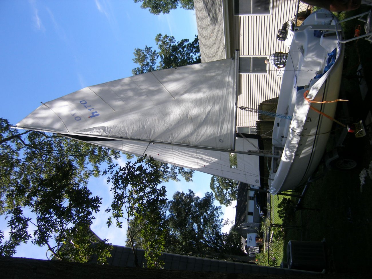

So I did a fit up in my back yard. Kind of had to make some educated guesses and learn as I go.

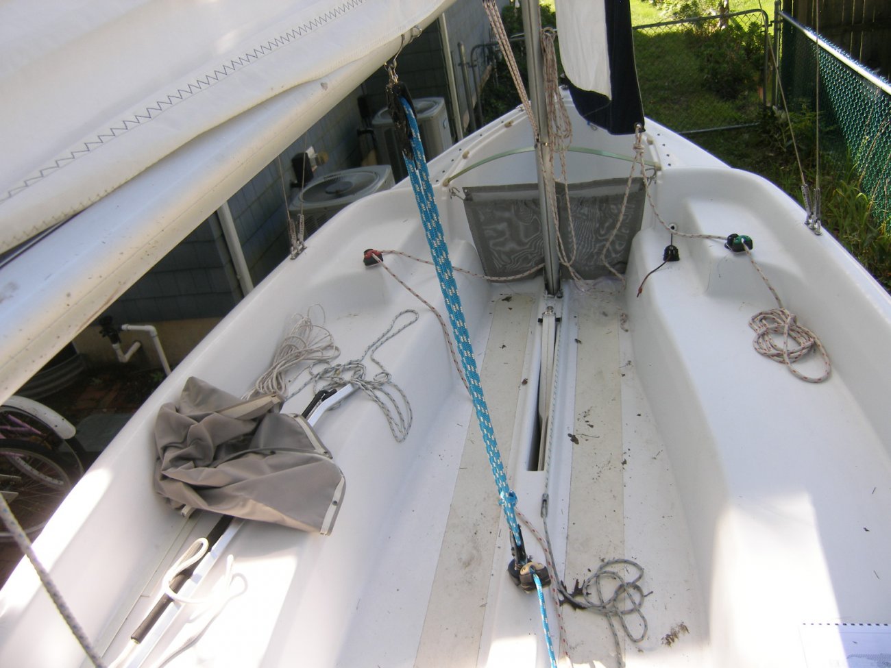

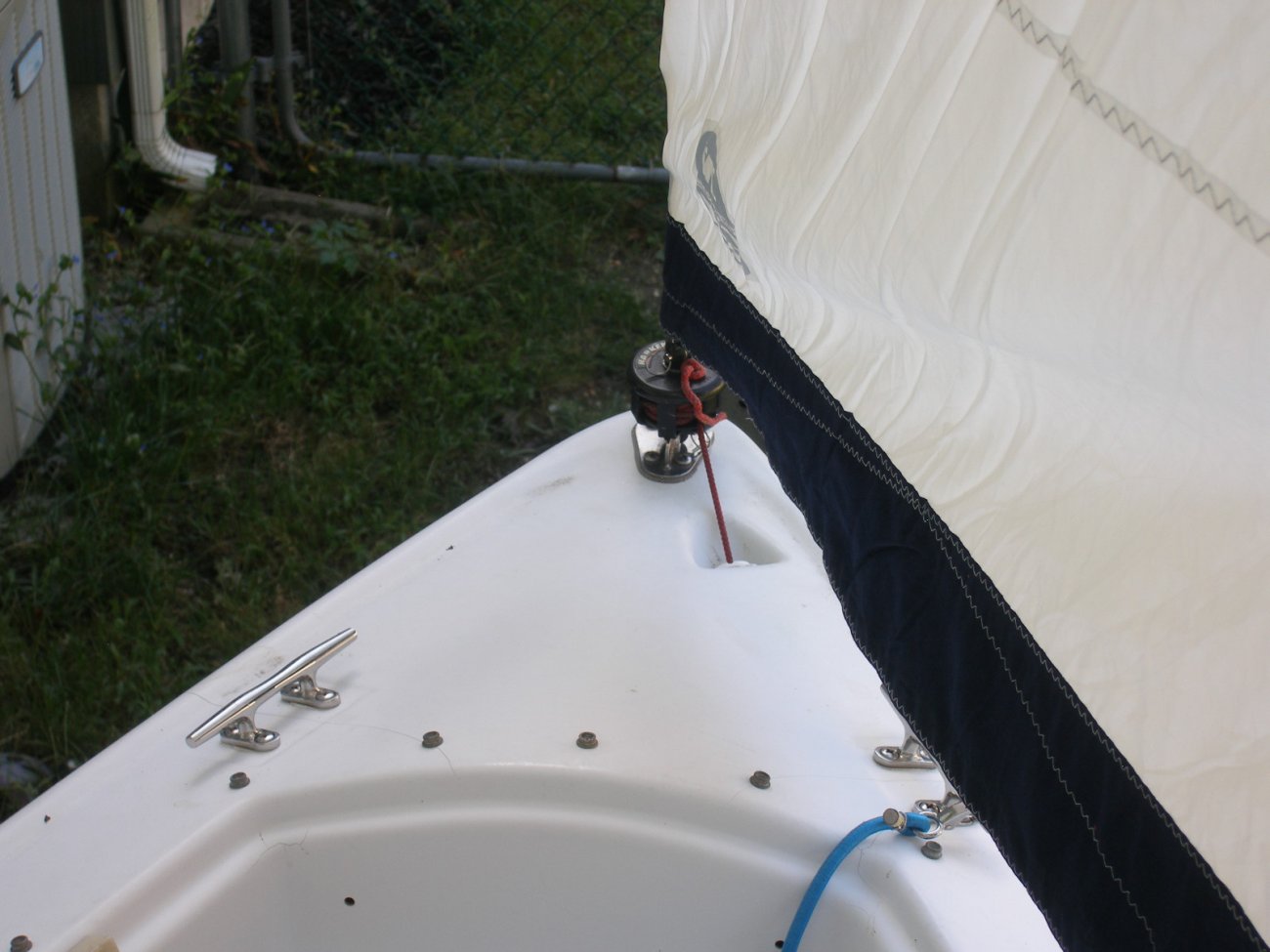

Jib set up, what order is it done in and how tight should it be wound? So I put the line in the roller foiler base, but how tight does the sail have to be? Should I wind the rope 1 turn around before going through the hole? Is there a quick trick to getting the rope through the hole?

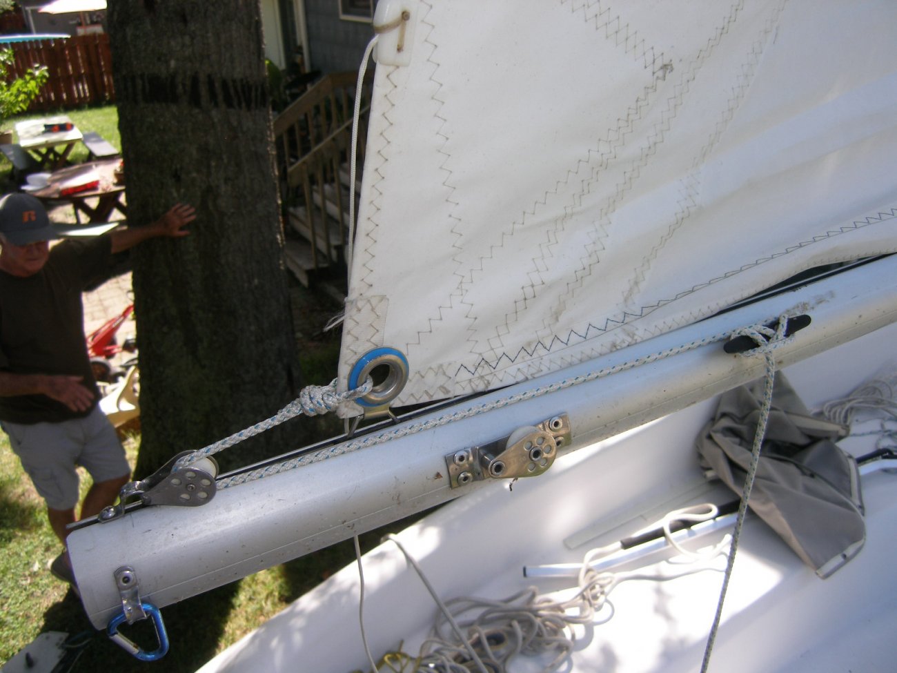

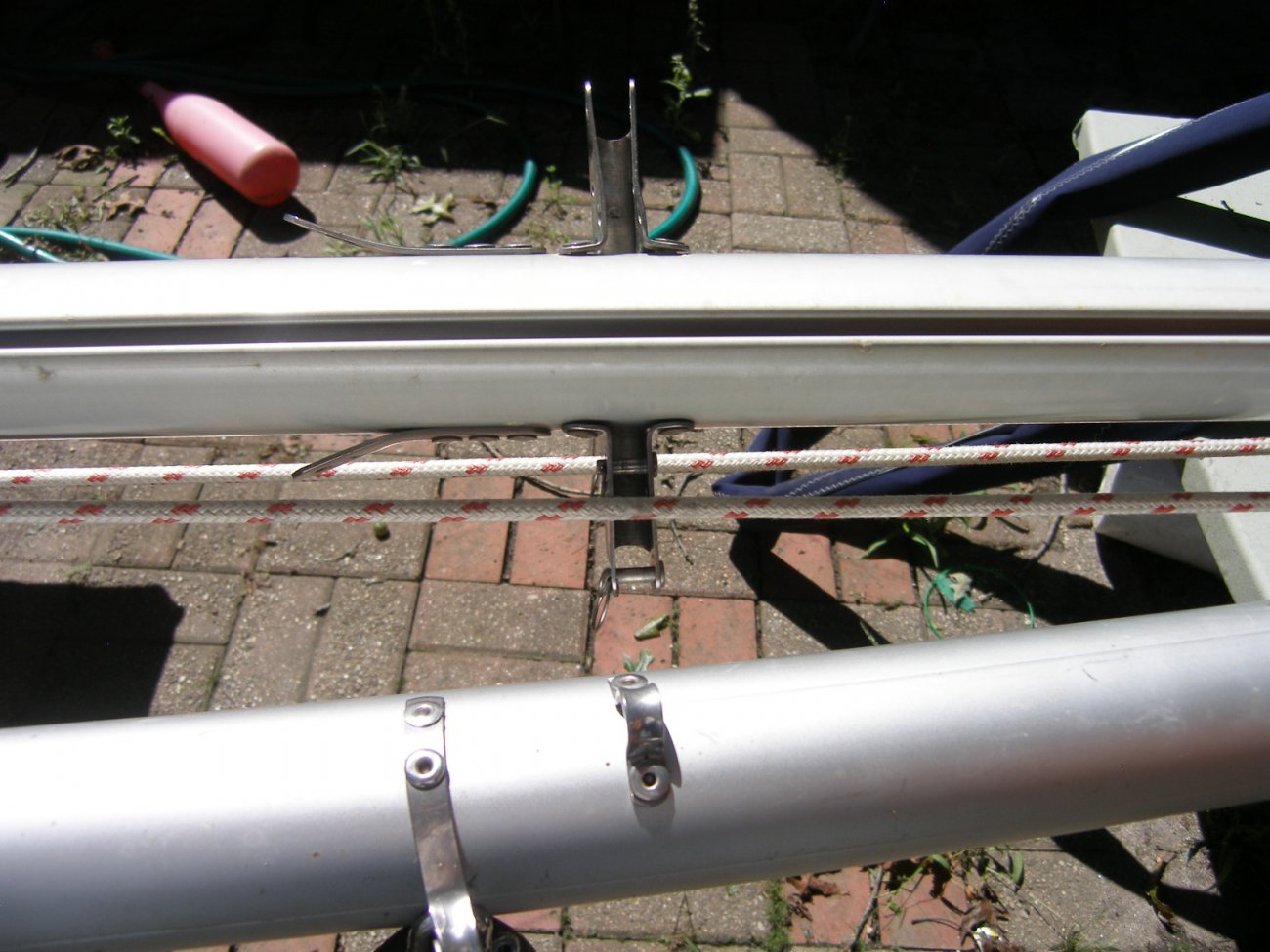

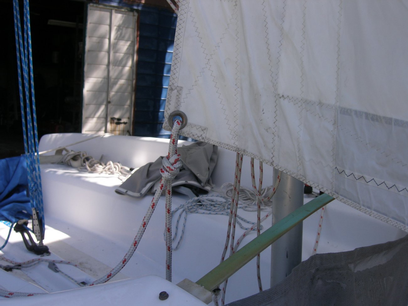

Did I do the clew line right? Does someone have picts of the boom setup to sail and setup on the reef?

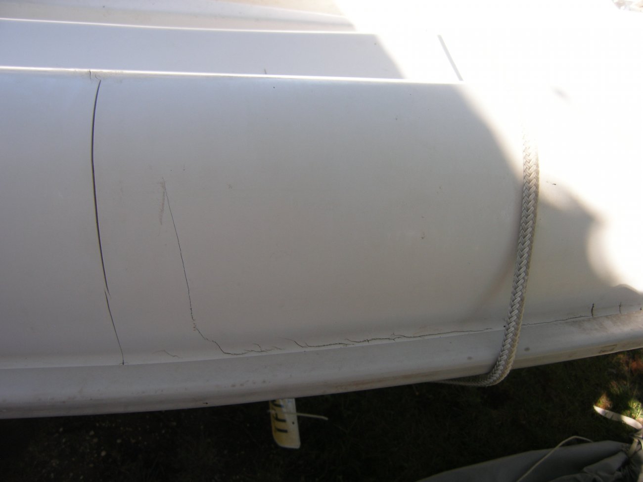

Found a crack on the hull bottom in the middle of the transom. I will do a repair to it before it sees water. Should I flip the hull upside down so the epoxy stays in place? Or just tape over it?

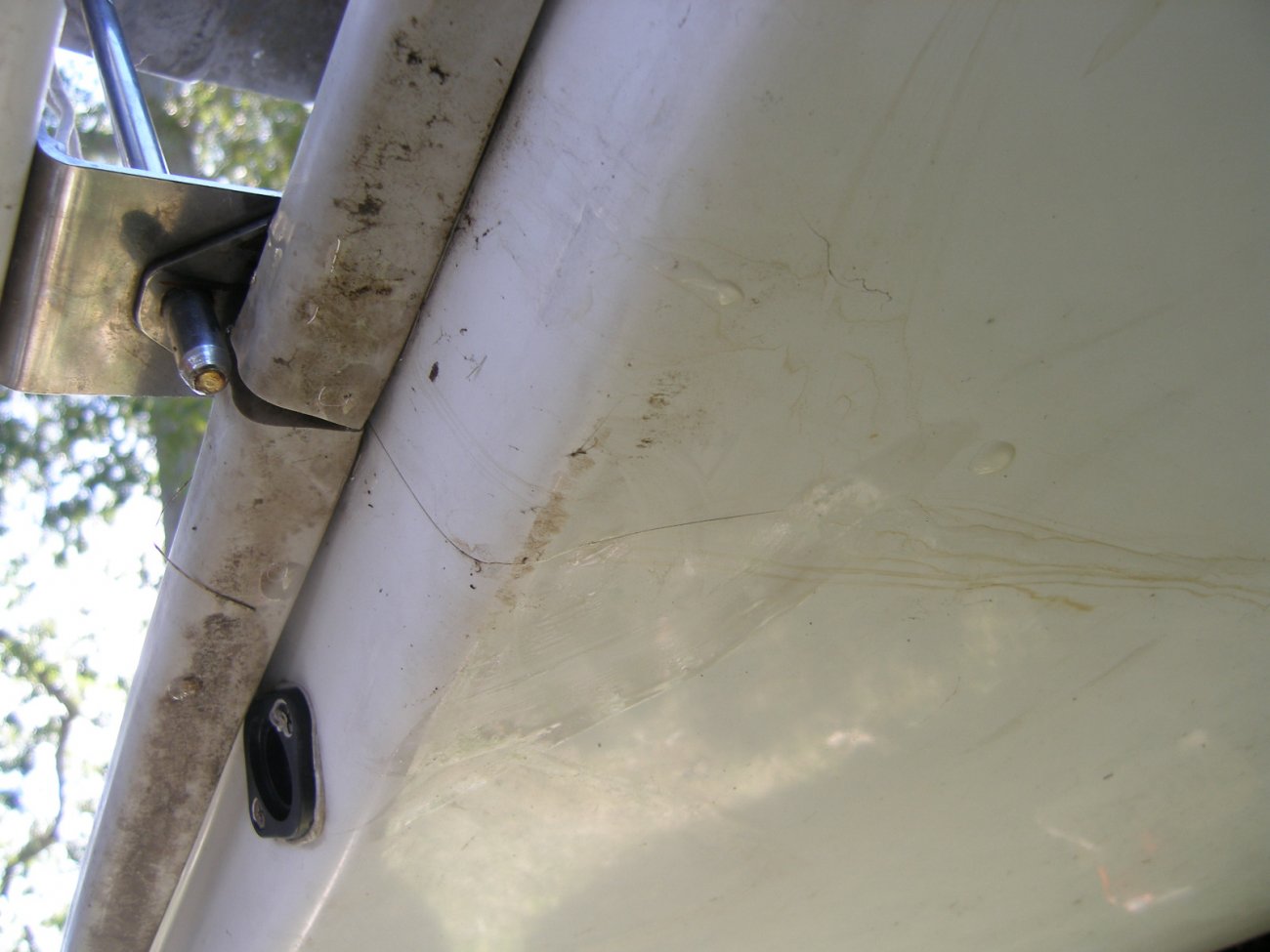

Found some cracks along the area where the grey rub rail is. How hard is it to take the grey rub rail and how do I do it?

Had my neighbor come over. He has years of Hobie cats and larger mono hulls. But older rigs. He was not sure about the stuff on the side of the boom and how to rig the clew. I certainly have it set up well enough to go for a sail. I will figure out the reefing eventually too. The boat is inside and I am not in a rush.

I have all the fancy tools to do car autobody work including a bunch of airtools. So I expect I will be able to zip through the crack stuff once I get the hang of it. The biggest question I would like answer is about the grey bumer the surround the top/bottom seam. How is it attached and how hard would it be to get off. There is one area I would really want to take it off to get in and do crack work.

This shows the boom hardware that you appear to have. The pictures show some slight changes versus the manual. The manual doesn't show any reefing instructions. I had to figure it all out by googling and averaging a dozen or so images and watching youtube on how to reef.

* How tight is jib. If you sail under 10kt winds just tight enough to pin the jib. The shrouds can be flimsy. I use adjustable shroud adjusters so after I pin the jib i close the levers. When the levers are closed the shrouds have no slack and just a tad of tension.
* Jib furler should have 4mm control line (harken small boat furler #163). Put 3 turns on it before pinning jib. While jib is rolled up and pinned wrap jib sheets another 3-5 wraps before leading to jib sheet cams. Test unfurling and furling while still on trailer or at dock. You shouldn't have to unstring the furler ever. The furler stays with the boat. In other words, when removing the jib, don't take the furler off the boat. I take my jib off at every tear down. This means the furler is still attached at the bow and there is no line left on the drum. Just the knot at the end of the control line so it doesn't slide out. When I go at set up I uncam the furler line, put three turns on it, roll the jib up tight, then attach. I test by pulling jib sheets slowly (this winds up the drum), then pull furling control line to roll it back up.

* Mainsheet can be attached with buntline knot or bowline.

Would not suggest using air tools. I suggest a Dremel with various speed options for better control dealing with a 3/16 plastic ACP cover

I did some experiments on a piece of 1/4" lexan I have. I have both a Dremel and a Fordham rotary tools. I put carbide cutters on each. The Dremel did fine, but was slow. The Fordham has much more power and with the flexible shaft it gives a lot more control. I can cut many times faster with the Fordham and keep the tip right where I want it and control the depth. The Dremel is light and wants to jump off track, it always has.
I was going to use a 90 degree die grinder with a sanding pad to relief the area on the couple of longer cracks as per the Hunter repair guide. I have a lot of experience doing detail work from making metal panels and welding them in place in the restoration of my 1931 Model A Cabriolet. I will also do some finish sanding with my low throw orbital air sander which is made for finish sanding. That along with the Fordham some of the really expensive tools I bought with some luck really really insanely cheap at a flea market or garage sale over the years.
