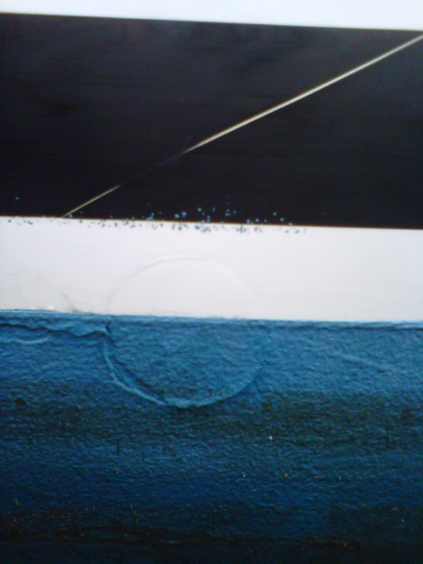

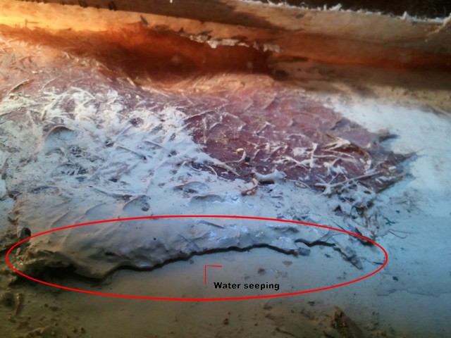

I've ran into an issue that I need some advice on how to address. For the pass year I've been trying to track down a small occasional leak in my Hunter 25 v-berth area. This weekend I believe I have finally located the leak.
It appears the water is entering from a previous unknown repair from what I can tell. I believe the area is just above the water line, since the water only appear during choppy weather when docked. The hull was cleaned and inspected about two weeks ago with no major or minor issues being reported. There is also no visible sign of damage that I can see above the waterline from the outside on the hull.
My question is can this be repaired without pulling her out
The closest dry dock is about an eight hour sail away.
The attached pictures below are looking up from the bottom of the hull.
Does anyone know how thick and what the construction of the hull is above the waterline for a 1974 Hunter 25

I'd agree that it looks like a PO did a poor patch. Unfortunatly you will not know how much dammage has been done till you open her up.
If the pach is above the water line you should be able to fix it with out pulling the boat but if it is at the water line (some of the patch is below the water line) then you have to consider if you could get the patch fixed quick enough so bad weather does not cause more problems and the possibility that the leak extends below the water line. Normaly the hull is solid fiberglass with no filler material. So you should be able to just grind back the patch till you get to the area that is leaking. Then make the hole in the hull and patch from the inside. This will require doing some gelcoating from the water side. also consider careening the boat by moving heavy items to the side opposite the patch may bring the patch high enough out of the water for the repair in the water.

You may also want to grind the area down just a bit to get rid of the part that looks like it is not solid to the hull. This might reveal something with hurting the integrity of the hull.
If you do need to grind out and repair it you might use the halyard and heel the boat over with it to get the hull high enough from the water to do what needs to be done.

Suds, send me a few better pics. Maybe something a bit more wide-angle. What you have looks like wet plywood detached from the fiberglass. Most builders use only polyester resin, not epoxy, when attaching plywood and these two things are notorious for parting company. This problem is directly responsible for my acquiring my H25 for next to nothing. You'd better believe all my work since is meant to avoid this problem in future, perhaps for ever.
If I could see more of the boat I could say more about it.
How much water are you actually getting; and where, exactly?

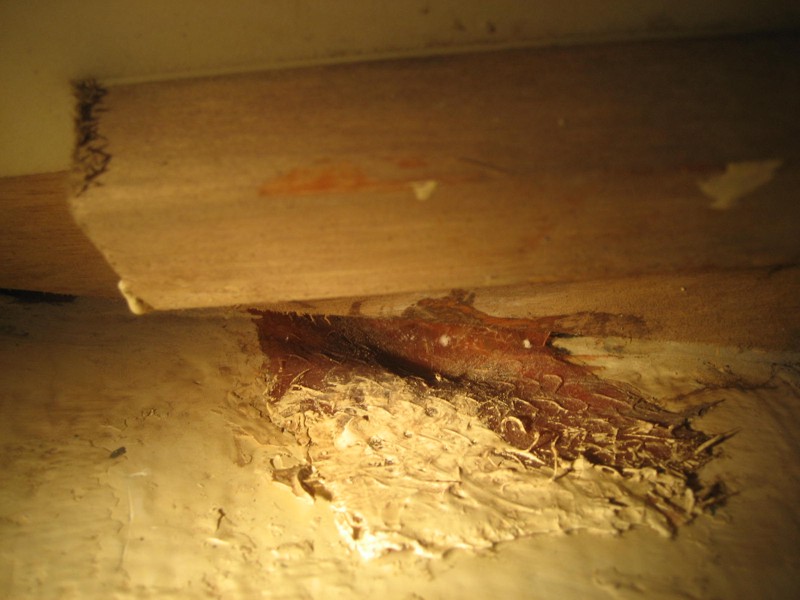

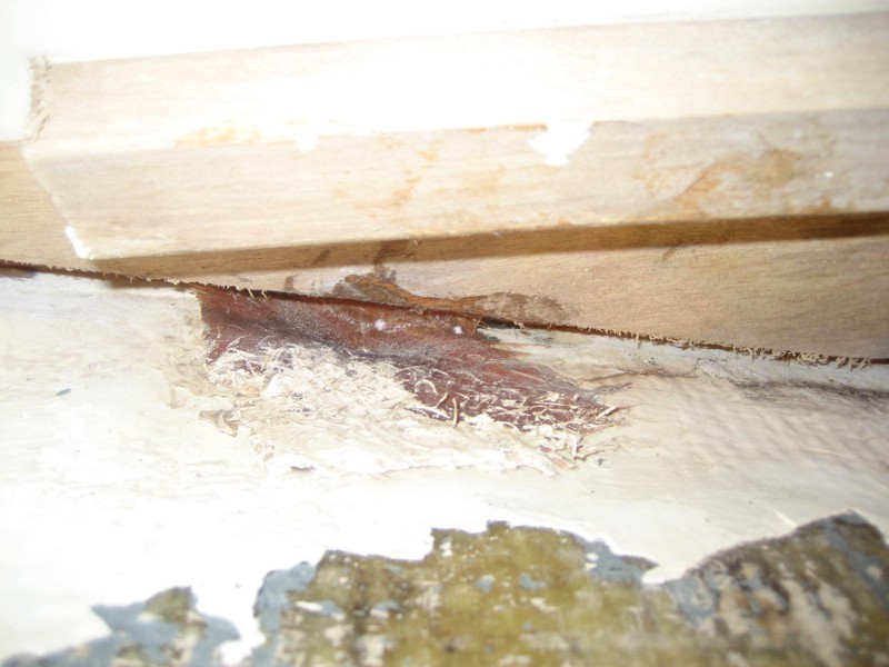

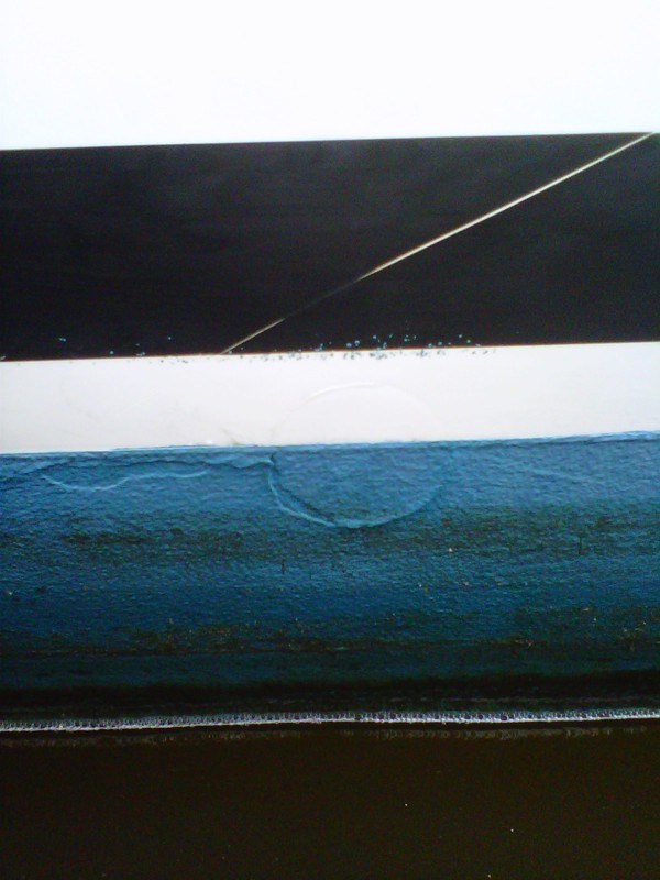

I got a chance to move the boat into a better position and measured to where the corresponding repair should be on the outside of the hull. After getting into a good position I found the source of the leak and confirmed it by spraying water on the area. I’ve attached 3 pictures and enhanced the 3rd one to show the it better. I’m not really sure what to make of it since it’s perfectly round.
Any suggestion on how to repair the area?

Looks like a poor repair to a previous thru-hull fitting.. Probably should be removed and correctly done with a tapered thickness fiberglass repair from the outside. Use West Systems repair guide and ya can't go wrong.. It is a tedious repair but not hard to do.
http://www.westsystem.com/ss/repairing-machined-holes-in-fiberglass/
This would be a "zone 3" repair.
Technically could be done without pulling the boat out but that would require a lot of weight on deck (water barrels maybe?) on the opposite side to keep the repair area clear of he water while you worked.. Another option would be to drill the old repair out and install a slightly larger thru hull fitting and cap that fitting .. again with weight to hold that area clear of the water while working.

Ugh! --what a rotten trick you have discovered. Who'd have thunk it?
I'm sorry about my misdiagnosis; but it's easy to see how you overlooked this at first. Some POs really take the cake.
I wouldn't try this without pulling the boat out. Take the surface it down to gelcoat or further and grind it fair, then patch it with something nice like structural putty (WM has it) or mishmash and then fair it in. This appears to be a dent less than 1-1/2" in diameter so there's a very good chance this will be adequate. The structural putty having the 'long-strand' fiberglass in it is really terrific stuff. 'Sticks to anything and won't fall out,' my cousin Lee says. The stuff is valuable because it contains fiberglass material in it. With clever application, sculpting and good prep this may lick it for good.
Refinishing the repair will be another issue. You can patch this with gelcoat or paint (whichever your boat has) but remember two vital things:
1. You can put on as much as you want, but it will be a lump. Make it as long and wide as you can to minimize its impact.
2. If you sand down a lump too far, you will remove it till it's as though it was never there. So you'll have to do some creative sculpting (leaving some of it there but essentially not noticeable). I did this on my galley-sink drain and I hate how it turned out.
You can do this all with hand sanding and hand tools; but it'll take several days with all the laying-up and drying and all. Proximity to water (inlcuding rain) will negate your efforts.
By my calculations this boo-boo should be right at the level of the v-berth. If you had to patch it from the inside, it would require some creative access points (meaning cutting out a bit of the bunk). So try it from the outside first and see how far you get.

I want to thank everyone for their advice. I decided to take geehaw's advice and "grind the area down just a bit to get rid of the part that looks like it is not solid to the hull". It turned out to be worse than it appeared. It was a patch over a patch and both were failing. I ended grinding out both patches and laying up two layers of 738 fiberglass cloth. This fall when I pull the boat to have a bottom job done I'll finish the repair from the outside of the hull. I still need to complete the surface finish of the repair from the inside but at least I know it's solid now.
You can use the link in the previous post to see the pictures after grinding back the PO patch.
