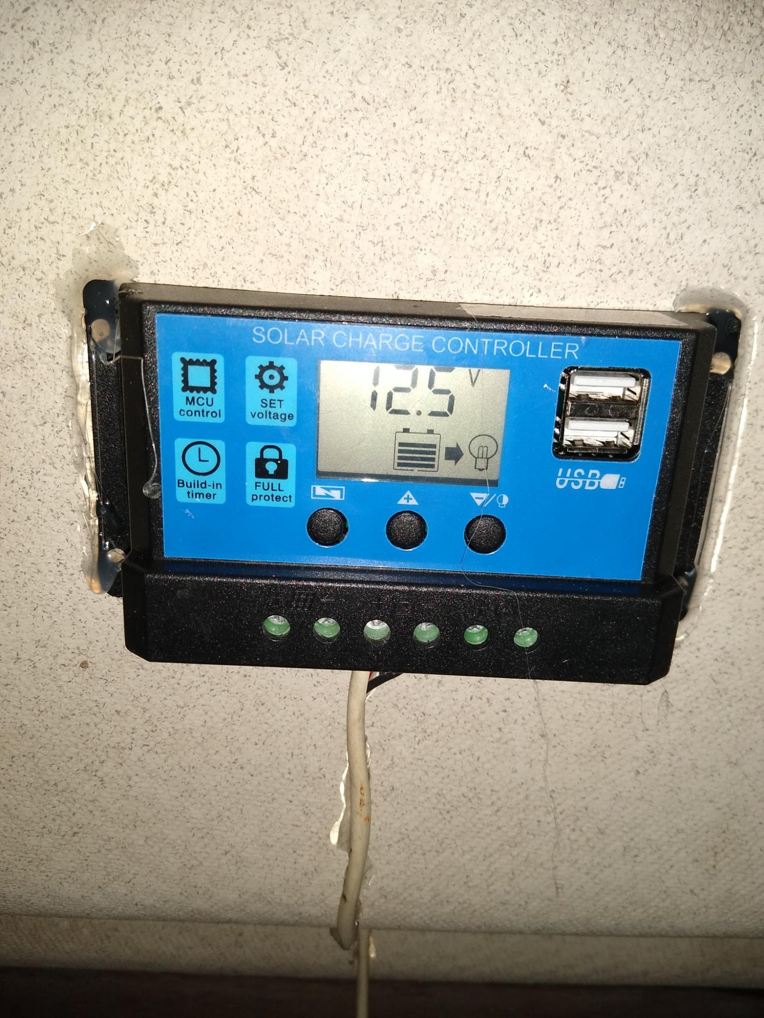

I left the lights on on the boat. When I return to the boat the battery read 7.1 volts.
I turned off the electricity and left the solar charger hooked up. The battery is red 11.4 volts when I left the boat that afternoon.
I am hoping that the battery will fully charge and last for a while. If it fully charges how do I tell how long it will last?
I plan to check on it this Saturday.

This is the McGregor 25. I powered the boat lights bilge pump fans and interior LED lights. I also use an inverter to run computers and charge the phone. There's also a small nav unit that is a fish finder. I have a 55 lb electric trolling motor for quiet evenings or emergencies.
When I leave the boat I shut off All electronics. I have plenty of energy for a three day trip on Sarasota Bay. I have 2 20wat solar panels. This has kept the battery fully recharged.
The Honda 7.5hp outboard has a generator but I have never used the generator.
Everything has a fuse but the wiring is very simple. One battery and a small panel.
