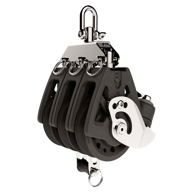

I can't really think of any use where a fiddle block is superior to a double block. I think the only reason they exist is because they look less clunky and more streamlined.
Fiddle blocks are easier to reave correctly and are less prone to twisting and fouling the wraps. Two triple blocks are the hardest to reave correctly and can become twisted. They work well in some applications, like a vang, because the blocks are always aligned. In mainsheet application the lower and upper blocks can get twisted around which interferes with their operation.

Absolutely every performance multi uses triple blocks on the mainsheet, and sometimes quad blocks. If they are twisting they are installed incorrectly... period. I have had them on four boats, some did twist because of installation mistakes, and they were easily fixed. If they don't work perfectly and release like lightning, these boats will capsize.
Not that my set-up (post 7) is twin triples rigged for 7:1 and there is only the correct 90 degree off-set. Release is instant, from anywhere I would sit, without using my foot :)yikes:) or shifting position.

I checked last night. I have a double block on the boom and this same ratcheting fiddle block on the traveler. What kind of blocks are less prone to twisting up the lines? In my case the fiddle swivels every time I pull from a different angle and the double pretty much stays still

Any block that is properly reeved (you will need to look that up for the specific design) will work. Preferably, do not use a swivel block on the top if the blocks are more than 3 feet apart. Only the bottom. This will prevent twist. Also be carefull how you coil the tail (better yet don't--flake the line in a corner). Some of the most severely twisted tackles I've seen resulted from repeated incorrect coiling (it is easy to add a twist when you coil).
