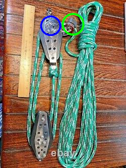

I have nearly the same setup as below for my mainsheet. It's incredibly difficult to release the line from the cam cleat under heavy loads. When water is ready to pour over your coming you want to be able to release it quickly. The traveler won't let the boom out as much the sheet will. I've been contemplating adding another block to create a 5:1 setup. The spinlock PXR clutch looks like it might solve the cam cleat issue. Would you add an extra block or upgrade to the PXR first?

Try releasing some tension on the cam cleat. Take a ¼ turn off each of the nuts securing the cleat to the fiddle block. Also look at the angle of the cam relative to the block and the angle necessary to pull the sheet out of the cam, this angle can be adjusted. The sheet should release if it is pulled vertically.

Cam cleat tension is NOT adjustable. There is a spring and the end locations are fixed. All loosening the screws does is make the mount less secure.
Yes, very often the cleats are set low for easy cleating, making them difficult to release. Rotate the cleat upwards, until the cleat releases when pulled towards you. It should take a distinct motion to cleat the rope, not to uncleat. Very common problem, I've had to change the cleat rotation on every boat I have owned.
More purchase will help. $$. I don't know what is normal on an O'Day 25, but I use 7:1 on my F-25, most beach cats run 6:1, and My stiletto 27 ran 8:1. I'd go 6:1. Make it a ratchet cleat (makes it easier to hand-hold and lowers the release tension).
When you say cleat rotation are you referring to the adjustment circled in blue or is there another adjustment available in the green circle?
I have to have the line on a parallel plane to the traveler to release it. It's not possible to get the correct angle unless I'm fairly far forward. Thanks for the sail shape tip. I'll definitely start experimenting
The adjustment in the blue circle. Try rotating it higher, so that you have good leverage when pulling to release. Locking it in the cleat, as you have learned, is secondary (this is even more true on multihulls).
I assume the cleat is on the lower end. I think the photo confused a few posters. Or I am wrong.
Some boats lift to uncleat. Some pull down. Beach cats and multies are always down to release, lift to cleat. The most ergonomic "pull" angle should always be uncleated, and then either lift or lower to cleat. (It is lift to cleat on most dinghies, because pulling lower is impossible if you are leaning out or trapping.)
Racers of dinghies and tender boats typically set the cleat high, out of the way, because they will hand-hold the sheet a lot and want to be CERTAIN it will uncleat when desired.
You should NOT have to push the sheet down to uncleat. That is unsafe. Pushing with your foot, while braced with your feet, is scary unsafe. It should drop out cleanly when you pull at the best angle. Zoom in and you will see that I have the cleat rather high. A horizontal pull releases the rope. And yes, that is 7:1 on a 24-foot boat. The F-24 is pretty stiff and the sheet really loads up in a breeze. And don't over-size the sheet for comfort; there will be more friction through the blocks. Instead, wear gloves when it blows.

The cleats are flipped, facing upside down, not towards the sky. There's too much tension on the line to pull downwards. Using a leg takes too much time when water is coming over the coming. Regardless of what body part is used to push/pull, tension needs to be released before this can occur. The cams are like putting your line in a clamp. It's a lot of tension with the 25-30kts of wind we've had lately! :biggrin:
I have this adjusted to the second highest position. I'll take a look to see if it's feasible to go one higher
