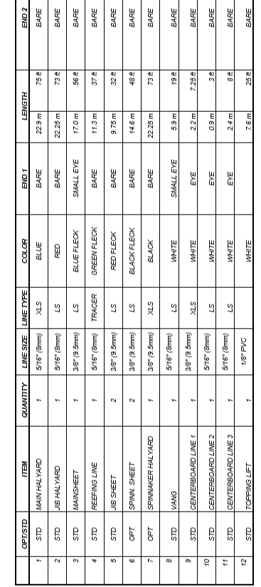

You did not say what year 25.5. Below is a link to a typical Hunter 25 that has a table with the running rigging diameter and length. You can take each line off by sewing a tag line to one end, disconnecting the line and taking the line to a marine store that sells running rigging then reverse the process. You can hire a rigger who can replace all the lines. You can also purchase running rigging from this site's store.
https://www.marlow-hunter.com/wp-content/export/Owners-Manuals/25 Owner's Manual 2008.pdf

Thank you for the link but that is to the 2000 era of the 25 while the original post was for the 1980’s vintage 25.5 and the original owners manual did not contain the length of running rigging. At my insistence that info became standard with the water ballast owners manuals. However, the forum store has that info and can make up those lines for the original poster. I have asked a friend to help out as a last resort.
