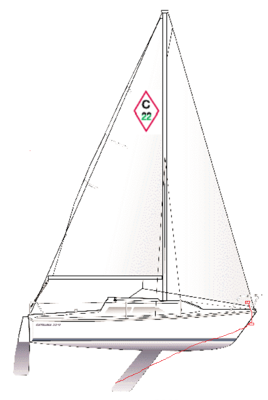

I have a solution for the C22 keel to keep it from closing on a knockdown
Mar 15, 2013
217
Catalina 22 charleston
This is my idea for keeping the keel out during a roll over. Run a stainless cable from the keel cable connection to the bow U bolt. 2 loops could be placed at the U bolt. One for the keel up length and the other for keel down length. A carabiner attached to the bow u bolt to attach the loops to. The problem: Will the U bolt support half the weight of the keel? approximately 250 lbs.? I think it might, if it has the Catalina Direct mod and is used in conjuction with the keel bolt. Engineers or anyone else tell me why this would not work. Just trying to solve one of those fears some people have about their keel closing on a roll over.

What keeps the cable from scraping on the hull? Have you ever rolled over your C22? I just loosen the main and let it round up.

I was thinking the wire angles could be a factor. The keel fixture is definitely strong enough and I have winched my boat onto the bunks with great load. The only one I was questioning was the bow U bolt and the force will be different downward and rearward. I think that would work to the design advantage. The wire would have a split clear tube on it so it would not rub the boat. I may experiment this summer. I have never had an issue. I have sailed my C22 since 1999. I think I can prove the angle and operation by winching it up with the cable connected (to a point). stress could be measured with my loose guage. The advantage of this over the through bolt is NO MODIFICATION required. Again the amount of weight would be 250 max and maybe less with the keel bolt tight and that would be completely upside down, less if at lower angles. I have the ears on my keel as well as the upgraded keel bronze fitting support. I guess the only way is to prove it. The wire could be thinner than the keel cable. The use of this in my thinking was during longer off shore coastal sailing time. It could be added and removed as needed. It would cause some drag and catch weeds. Just unhook at bow and shake off is my thought on this.

No I have not rolled my C22. Just read about a couple of sinkings. The wire where it could rub the boat would be in vinyl tubing. Not sure if I would ever need it. I have been offshore in over 30 and have sailed my C22 since 1999. Just thought it could be a simple improvement if I can prove it would work. Might come in useful for peace of mind during those long coastal FAIRWEATHER offshore sails. If a storm comes and you are 5NM out, that is an hour trip to get in if there is an entrance perpendicular to you, longer if not. Weather can change quickly, you know, like weather.

Is this an early April Fool's joke??
Beyond the obvious impracticality already mentioned, a line secured to the bow there as shown would actually pull the keel closed, not keep it open. It would have to be below the pivot to hold it open.

It would be attached where the keel cable connects, which is way below the pivot point. Not an April fools joke, just trying to brainstorm to solve a POSSIBLE problem with the keel slamming closed and sinking during a near rollover or complete rollover. Is it really that stupid? What is your solution? Will it work was the question? Not sure drag would be that bad as the cable is thin and angled toward the back of the boat. I have heard people say you can't do this or that. What I have found is they can't do this or that. What obvious impracticality? Please do share facts.

You've got this all wrong, sorry. And you looking for an answer to a problem that does not exist. Now to your 'solution', if you attach that line to the keel BELOW the pivot point (which you have shown), see below, the distance from the bow to the keel will be SHORTER when the keel is up vs down. Tightening that line will PULL THE KEEL CLOSED. At the very least it will do nothing to keep it open.
The chafing will rub and damage your hull.
The whole thing is unnecessary, as Don notes the danger to sinking is downflooding through open hatches in a knock-down, NOT the keel retracting back.
I used to own a C22. Are you really asking me? OK it's stupid. Sorry but it is. What are you worried about? Looks like you're having a great time sailing. Carry on!
My solution is to bolt the keel down. As Curious mentioned, the Venture 22 had a second bolt (other than the bolt the keel swings on) that held the keel down (you took it out before lifting the keel). That was plenty to keep the keel down the times I was knocked down on my Venture 22. If the C22 does not have this bolt, the solution *I* would present is to put one in. Way simpler and less prone to failure than yours.

Please. Before you do ANYTHING to try and secure that keel in place in a grounding, Google 'second order lever' and see how much force will be on any retaining pin (and the lightweight trunk) when you run the tip of the keel into something hard at speed. A quick napkin calculation tells me you'll tear up the inside of your boat.
The original Catalina 'locking' part was designed to slip. For VERY GOOD REASON.
