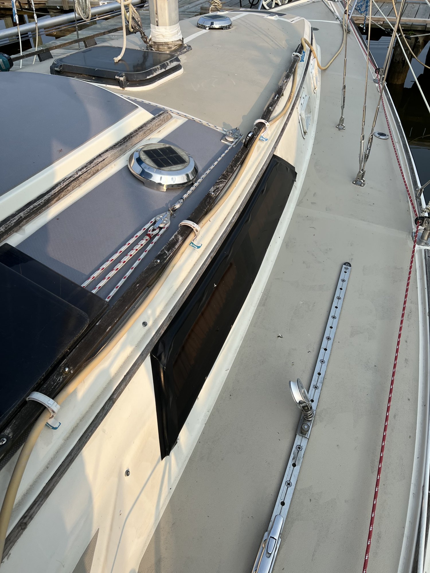

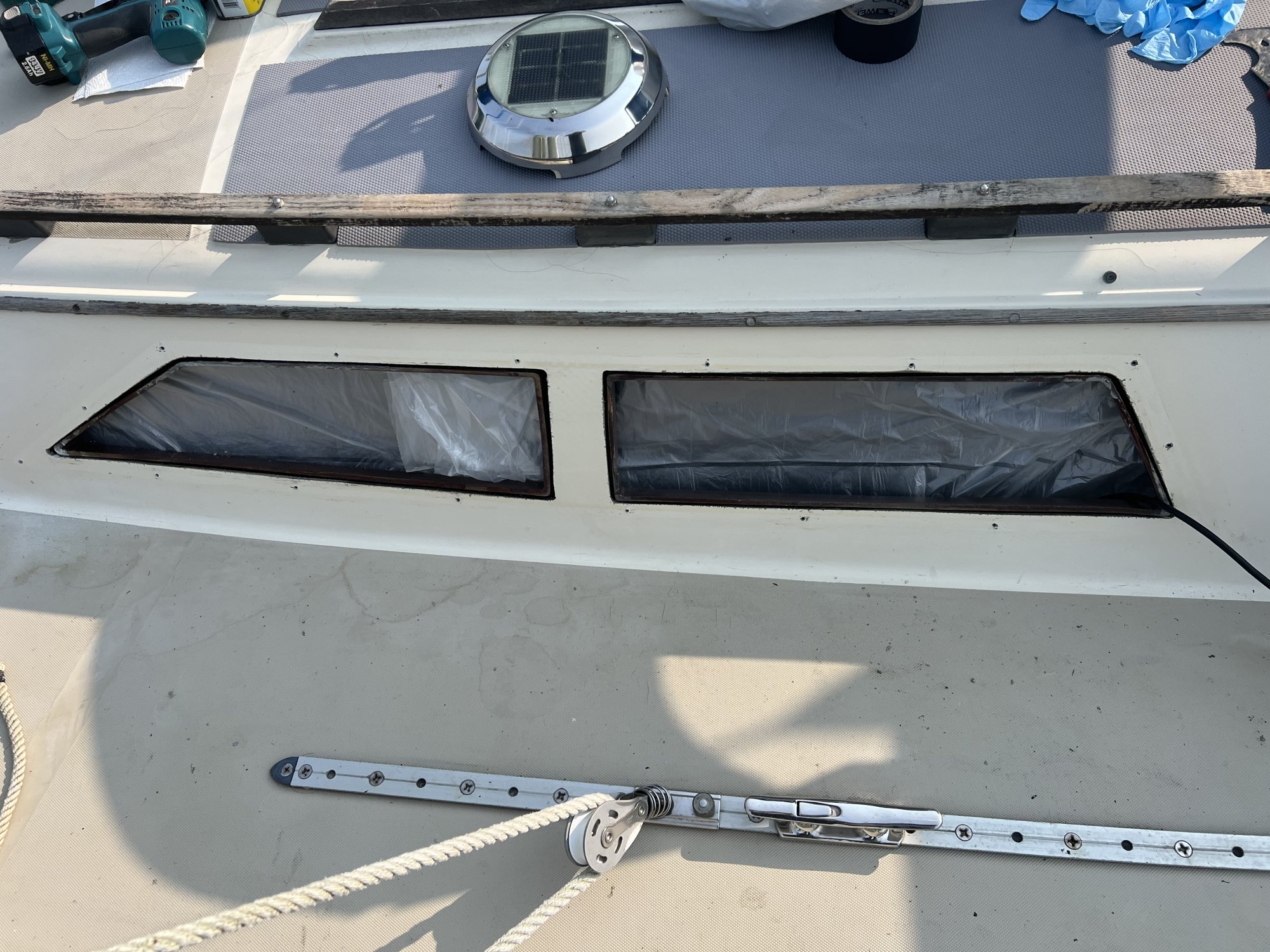

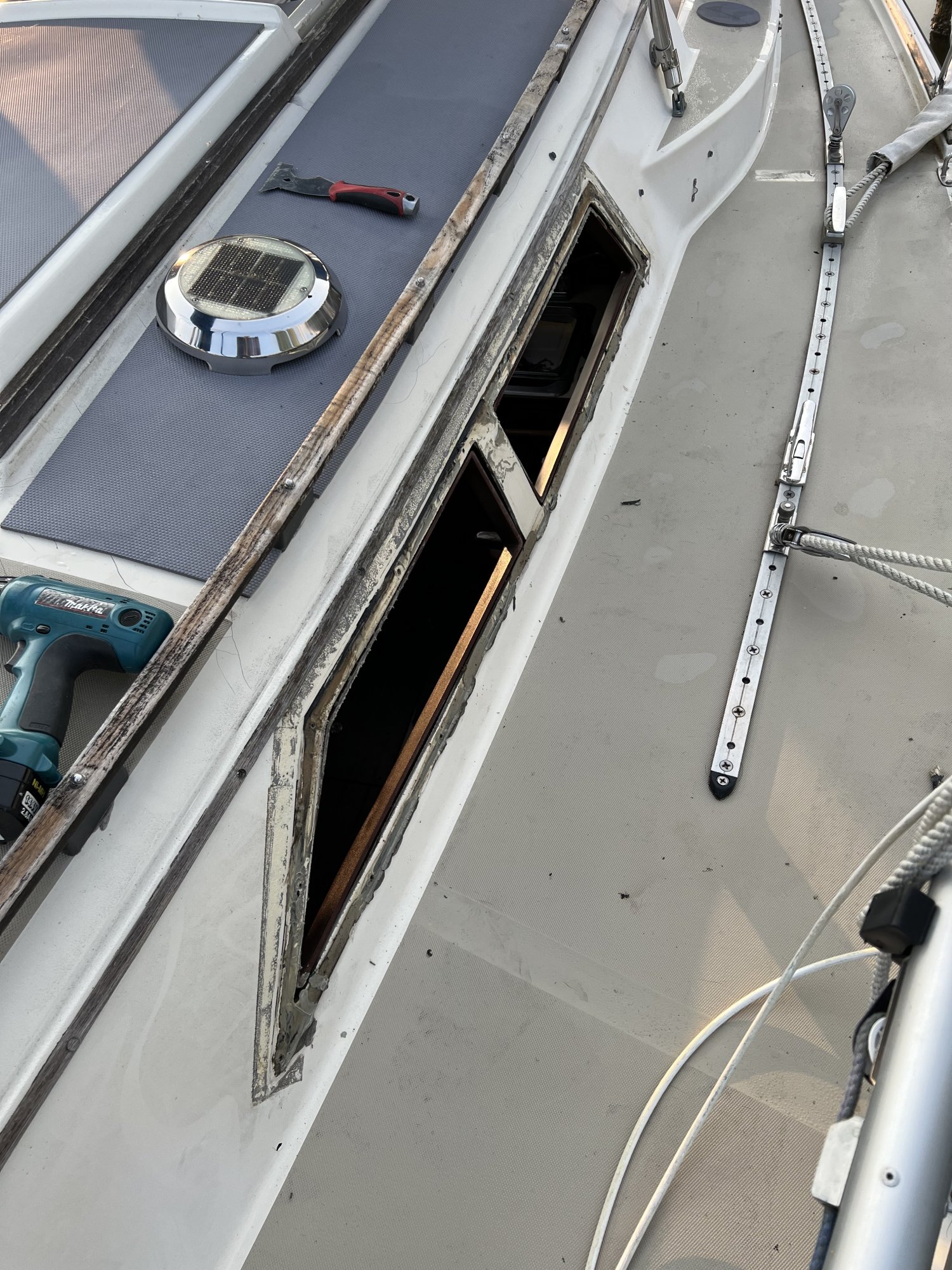

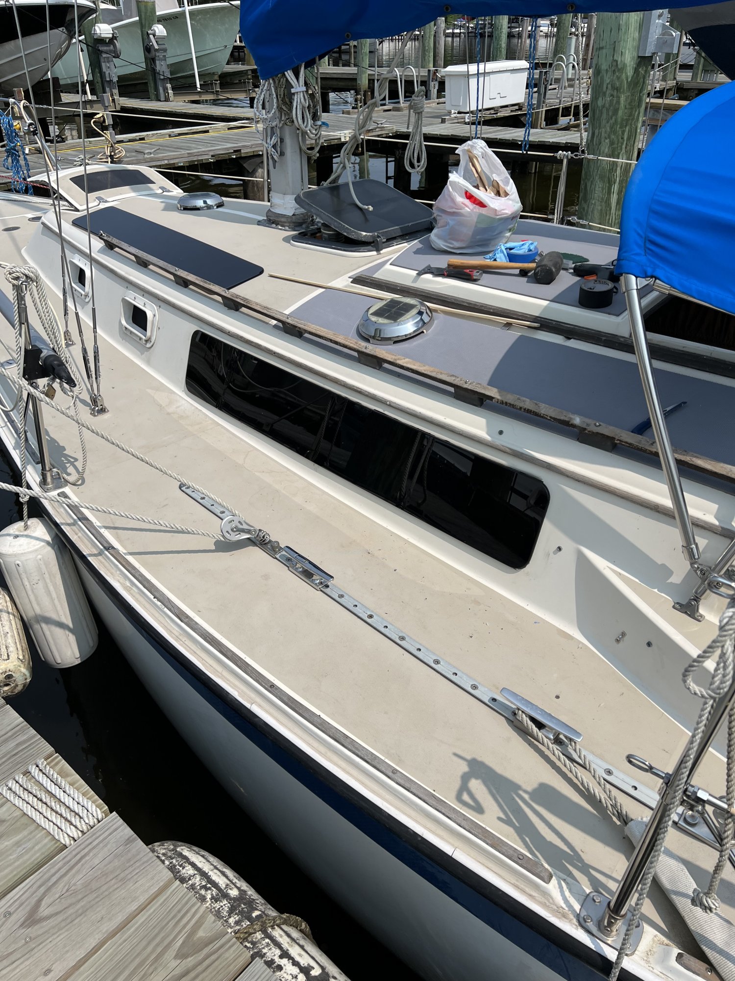

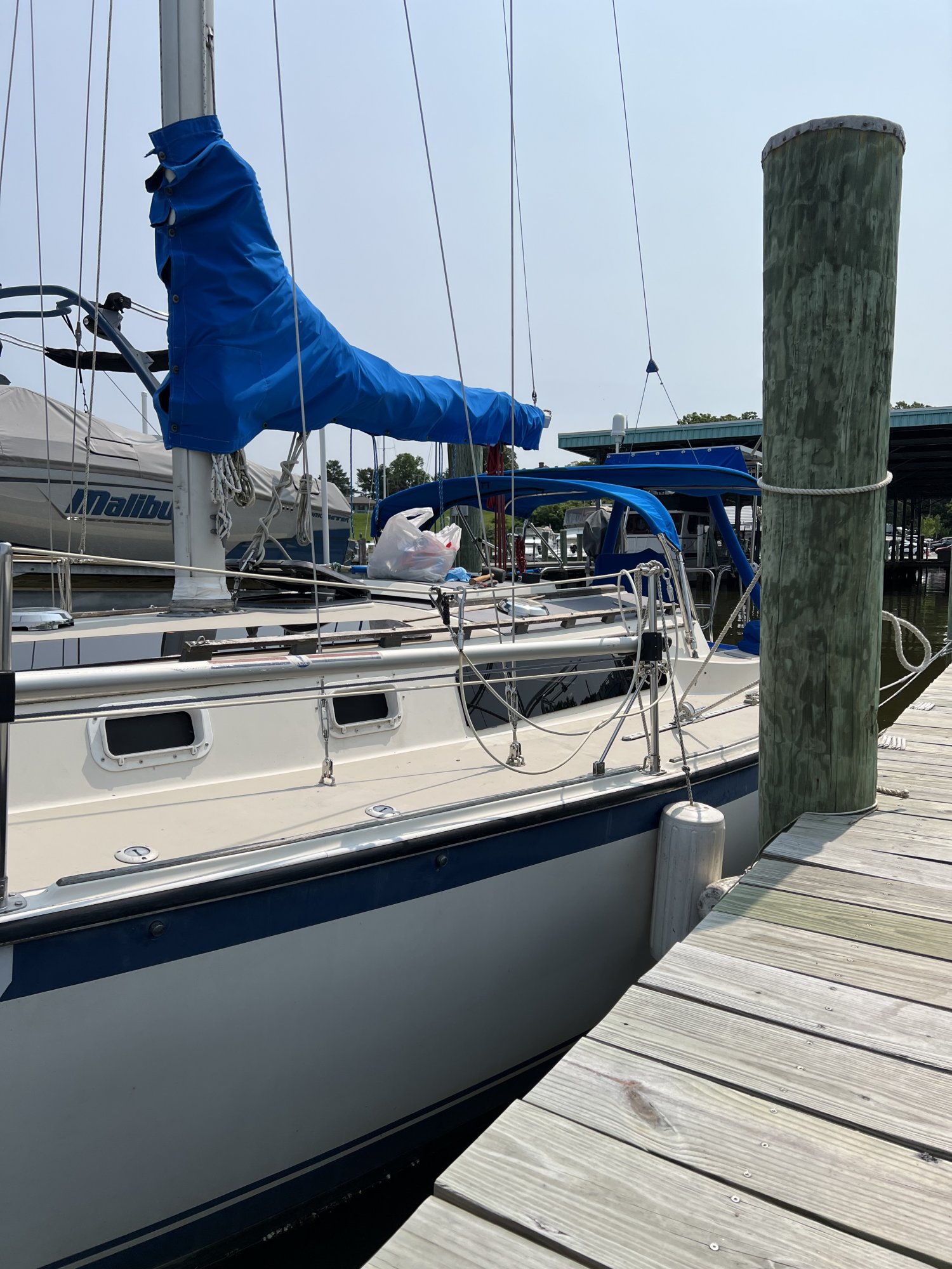

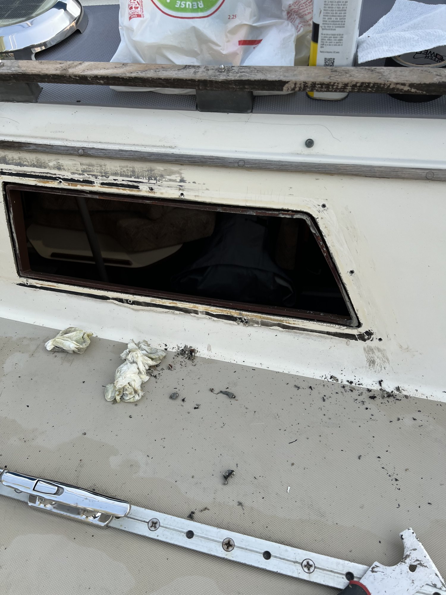

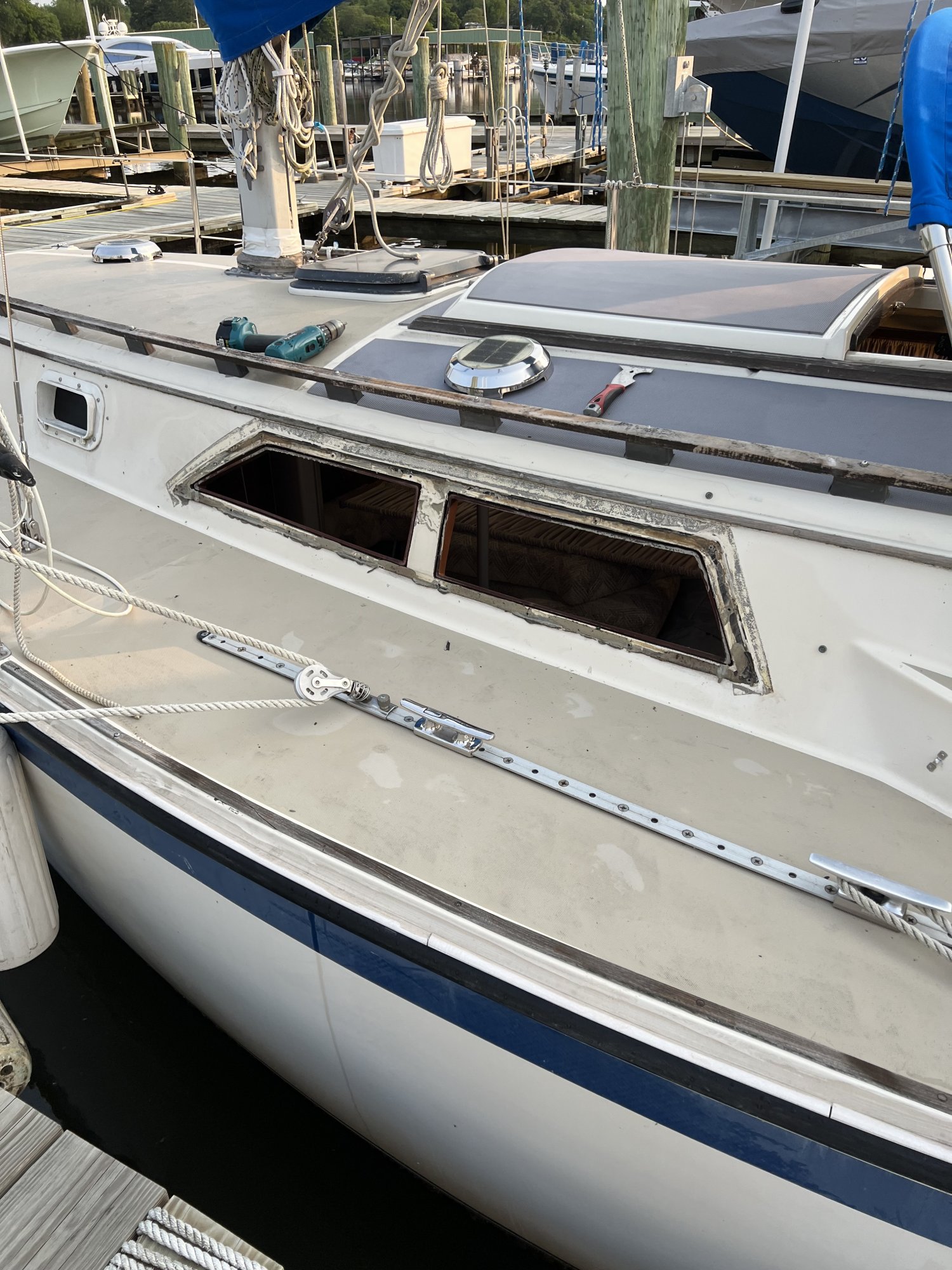

Finally after one year of procrastination: A year ago I started seriously planning replacing the big plexiglass windows. First I You Tubed how to do it, then I started purchasing the Plexiglass and all the needed supplies. My aim was to change the shape from the old to something more of "The slow moving look"! I sourced my plexiglass and had them round the corners and polish the edges on one side. Everything came last June. It's been sitting in my basement ever since. So today, I got to the Marina by seven am and worked through till 3:30. Got everything done except for the caulking. I thought I'd let it bond a while. I started by removing one side, cleaning the surface of the boat cabin outside wall. I then sanded the area, taped off the area to be primed, applied primer on both the cabin sides and the plexi glass, and finally offered up the glass with the 3M tape using pre hot glued wooden guides for placement. Using a roller I applied pressure. After that I did the other side. Removed the guides and cleaned up. It says after time it becomes pretty much impossible to remove without breaking the glass. I used a special plexiglass primer, 3M High Bonding Tape. Don't want to use screws.

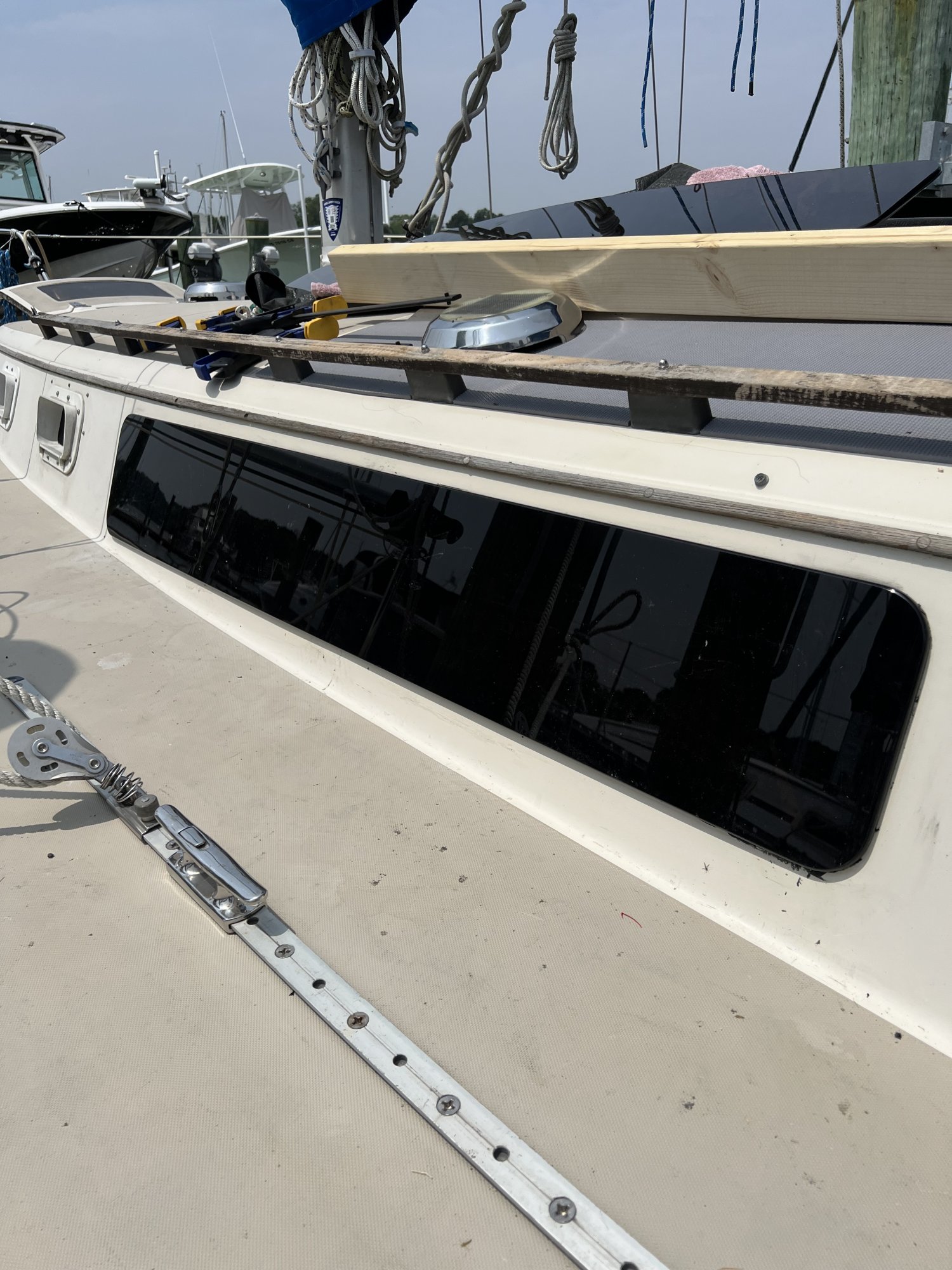

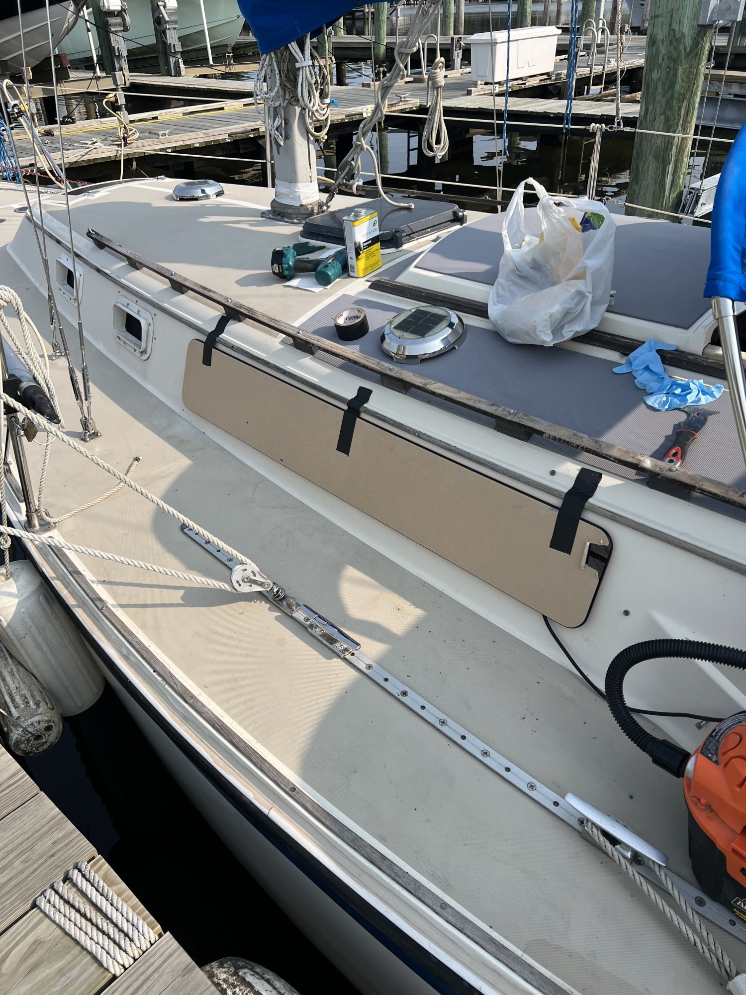

So I went down to the boat a few days after my last report, only to find one side in a corner it did not hold. After review, there may not have been enough VHB tape applied and not held in place long enough. So I've come up with a plan to remove, clean up the old, apply fresh plexiglass primer to the window, re apply tape (this time more, as in a wider strip) and using a 2x4 propped against the stanchions and reverse the force with wood clamps along with protection for the plexiglass, enabling constant force for a few hours. Hopefully this plans should do the trick. Only when I am satisfied that it is holding will I use the 795 caulk.
Aug 11, 2011
1,020
O'day 30 313 Georgetown MD

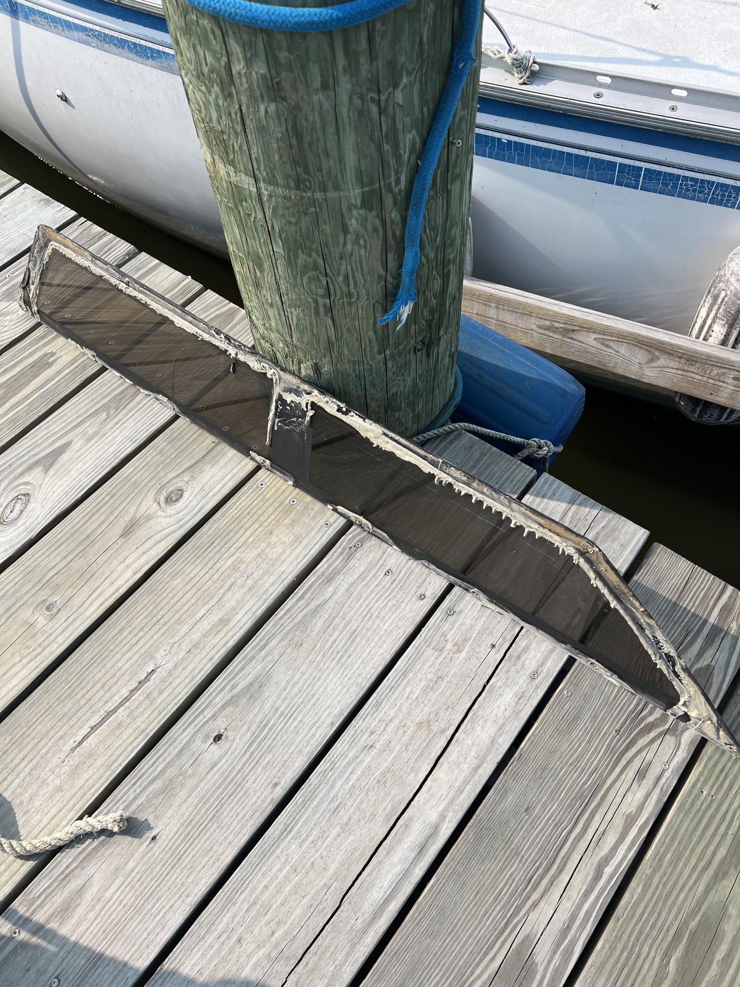

This morning I removed the window. It came away slowly with some persuasion, however I did not break the lens. Cleaned it all up, scuffed the adhering areas applied tape. Rolled tape with a good heavy roller to apply good adhesion. Then removed the other side of the tape and offered it up applying plenty of force. Finally I set up my two by four across the stanchions and applied pressure to the glass. So far so good. Being a hot day it should curve well and then tomorrow I'll return to the boat and see how it worked. If all is good I'll do the caulcking. Wish me luck.

IT WORKED! I went down today and boy what a nice tight seal. So I taped up the windows and applied my 795 and smoothed it out with my rubber gloved finger. I was concerned about the caulk as I had bought it over a year ago. Came out of the tube well, no dryness or clumping. No screws.
