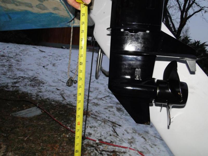

Speaking of high pitch - which is better to prevent the prop walk? I added the prop guard (just like the one on the pic), but sometimes I have to raise my keel to leave the dock, and the prop walk is so bad it turns the bow at least 45 degs before I get enough speed to go straight...
