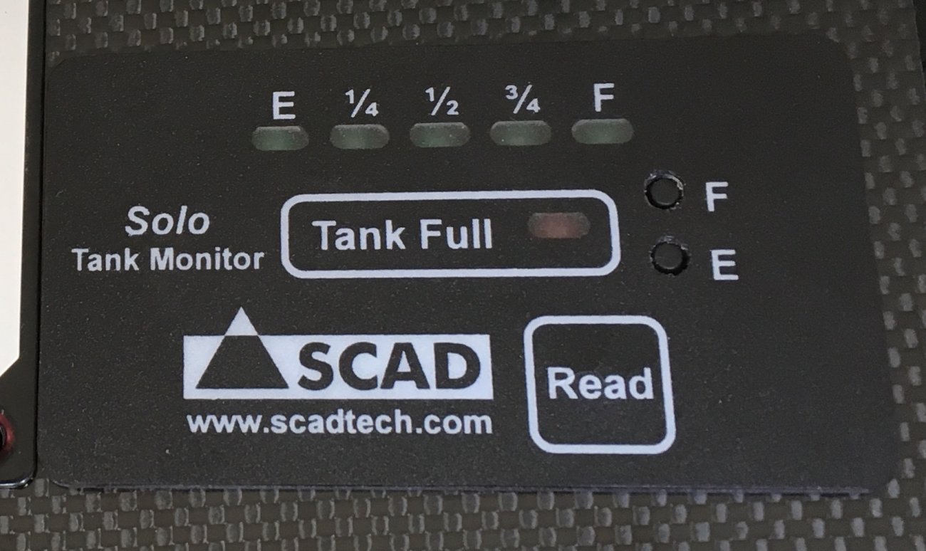

Aug 1, 2011
3,972
if there's a way to have the tank notify me
The short answer to that is yes. Do a search for tank monitor, and you'll be pleasantly surprised at what pops up.
Here's what our display looks like. It's a rather handy thing.
