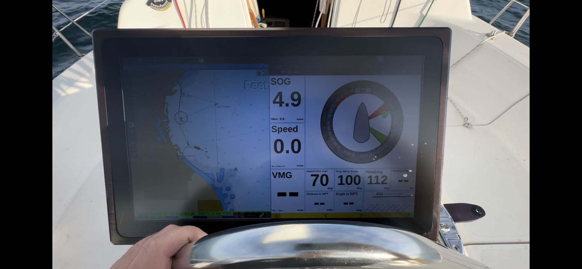

I have a Raspberry Pi 4B at the Navstation that has two HDMI outputs one to a 10.1" touchscreen at the helm and one to a 15.6" Waterproof, sunlight readable touchscreen at the helm. I run OpenCPN as my primary Chart plotter, although for long distance races I tend to use qtVlm because it is just easier for wind routing, once routed, I email a GPX file to the boat and load it in OpenCPN. I have seen some quilting issues but my experience has been that these tend to disappear when zoomed further in.
I created some Youtube Videos on my setup:

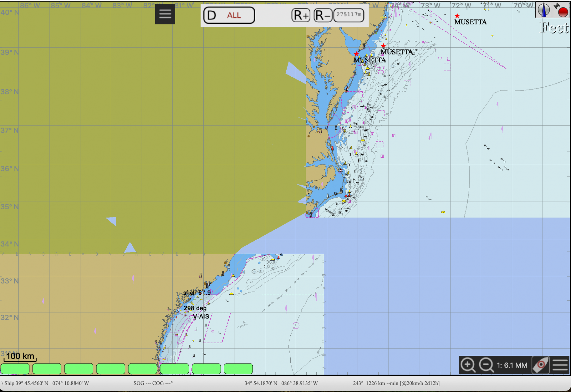

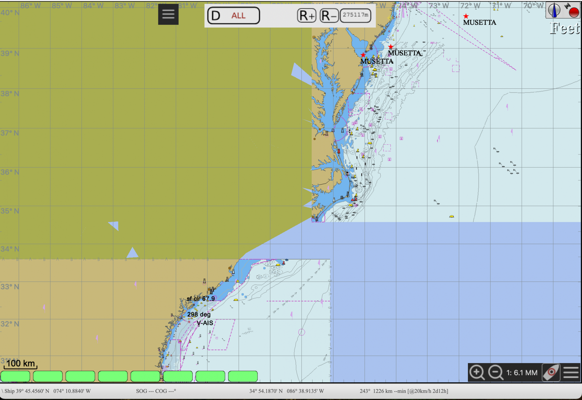

@JBP-PA, are all of the charts that you have loaded RNC (raster) charts? And are your screenshots taken from an Android phone? It looks like the screenshot with Presque Isle and the bay are using a raster chart, and maybe at a level indicated by the highlighted tiles at the bottom of the screen. On your other screenshot, it looks like there is no active chart (nothing is highlighted), and what it is probably using is the base chart, and maybe a vector chart as @jssailem has suggested. Our Mac installations give us a scale on the zoom controls on the lower right, I can't tell what the zoom level or the chart scale is on your examples.

I do have both RNC and ENC charts loaded. As @SoSound said it is an Android phone, the paid Dave Register version. For the screen shots I had "Raster" chosen though it also does this off I have "Vector" chosen. Sometimes when zooming out it reverts to the base chart despite having an appropriate chart loaded.

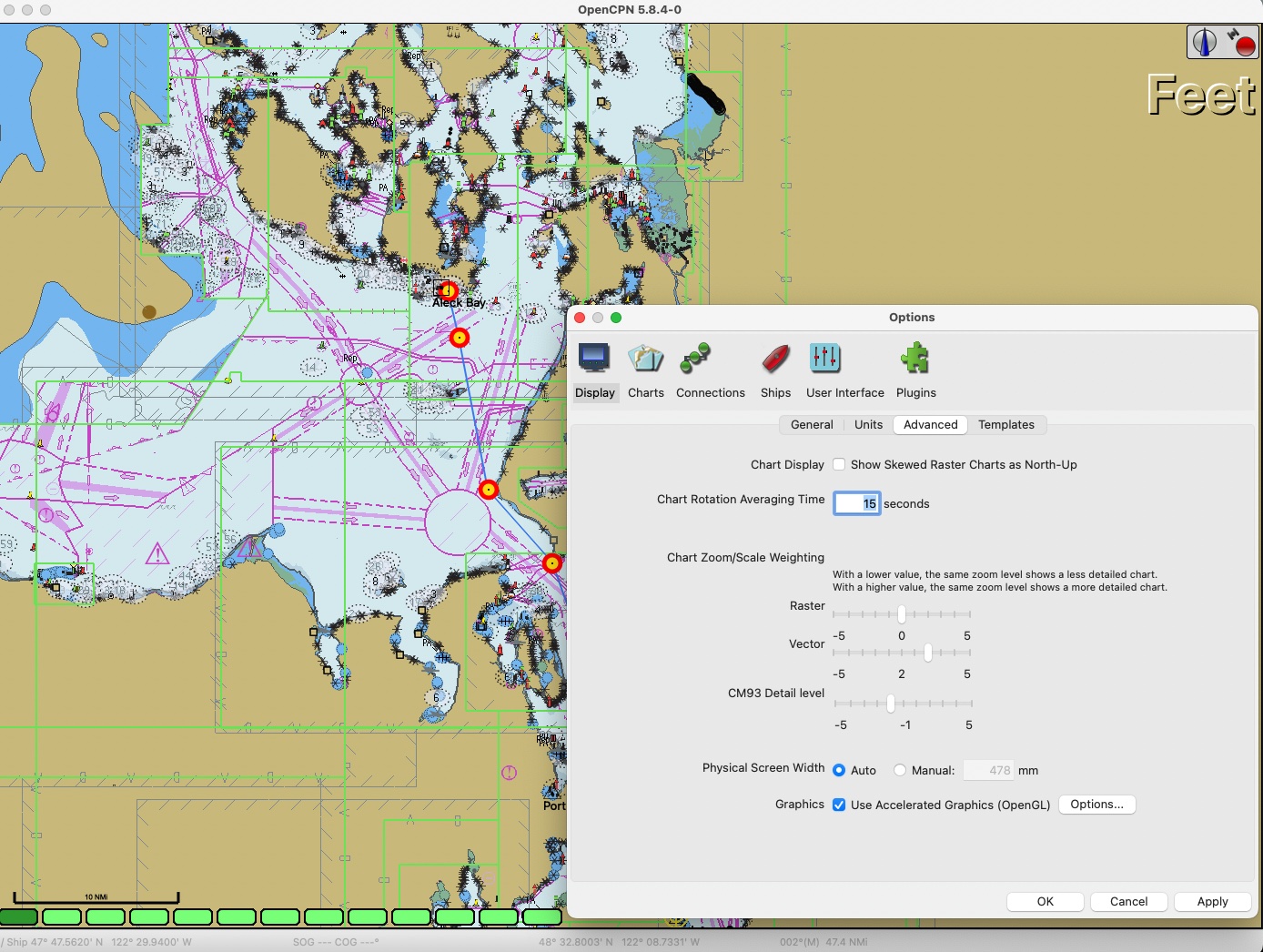

For this particular issue, there does appear to be an adjustment in settings which will improve the chart quilting and display of charts. You want to change the Chart Zoom/Scale Weighting which can be found in Options: Display: Advanced.
I increased the weighting for Vector charts (+2), and decreased the weighting for the CM93 chart (-1). I didn't change any other options. There did seem to be a side affect to the change, it seemed to either reduce the mouse sensitivity for zooming, or to increase the processing required to build the display.
This screenshot shows both the Options panel and the affect on the chart where I was experiencing the problem before (problem area was San Juan Islands, east of Vancouver Island). Compare this to the first screenshot in this thread.
