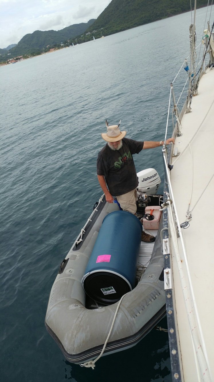

Personally, I think its like anything else; you get what you pay for. I buy the best quality dink on the market, which comes with a 5 year warranty and holds up for many, many years of very hard service. Our last Zodiac Mark 1 Classic lasted 9 years of almost daily service. Beach landings in surf, concrete docks, broken West Indian dinghy docks and even some encounters with rocks and coral and not one single hole. 85º isn't all that hot when you live in the tropics, by the way.
At the end, after all that time being pushed hard by a 15hp, 4 stroke, the dink still did not leak air, but was retired because the transom gave out.
However, I am not a fan of RIB's, as they completely defeat the whole purpose of an inflatable, IMO. I really like the fact that I can deflate my Zodiac and stow it below, should I choose to. Our dink will easily carry a couple of 55 gallon drums of water or fuel, should we need to. The other terrific thing about our Zodiac is that we can stand on the side tubes without it flipping over. No worries about weight distribution at all. And its a lot kinder on one's back than any hard dink, if you are going fast in choppy water.
Don't give up upon the whole concept just because of one experience. A good inflatable will give you good service for many years.

A couple? Wow, that would be something. Bear in mind, water is 8 lb./gallon, diesel 7 lb./ gallon, gasoline 6 lb./gallon. That's 660 to 880 pounds of liquid, plus the weight of the drums @40 lb. each, and your weight. So, like 1,000 plus you plus the motor. Max. capacity is 1,300. BTW, these are still available, $3,200.

So, what's your point? Motor is a lot less than 300#. At any rate, try that w/an 11 foot RIB! That really is the point, don't you think? The barrel in the pic is 75 gallon size, by the way, and weighs a lot less than 40#.

What do you weigh? It would be you plus motor for the 300 lb. margin. And then you are absolute max. capacity.
It just seems remarkable to me, that you would carry two 50 gallon drums of liquid in that thing.
I would prefer to do it in a RIB. The AB 10.5" fiberglass RIB has a capacity of 1514 lb. Mine is the 9 VL, 9.5' and has a capacity of 1393.
I guess my point is: that two 55 gallons drums of fuel or water in a Zodiac Classic; I just don't believe it. But then, I've seen wackier loads going down the highway.

Capta, just curious. How do you manage to get that on your boat?
That wasn't fuel or water. It weighed about 200#. A halyard worked just fine. All I was saying was with the big, flat floor
I could carry 2 full or nearly full 55 gallon drums in the bottom. A equal size RIB has nowhere near the same flat floor space.
