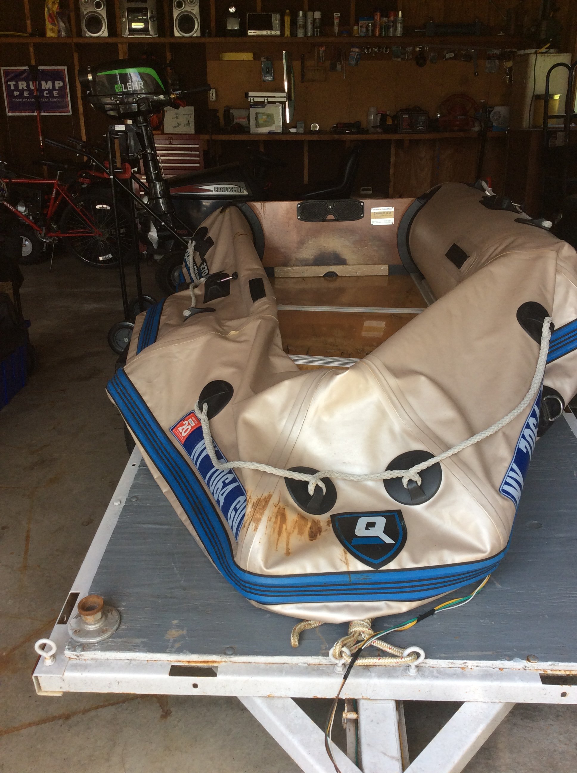

Over the 4th of July weekend I took my elder Quicksilver 270 inflatable (purchased on Craigslist) and brand new Lehr 5hp OB for a potential launch to attach to the mother ship for an overnight excursion from slip to anchorage on Cayuga Lake. The plan was to make it to shore somewhere besides the slip at night. Preferably a winery or really awesome party. Well that never happened!
During our provisioning stop, Sunday, at Wegmans in Ithaca, we returned to a deflated dinghy on the trailer. Yes it was hot...85F, yes the dinghy blew a two chamber seam. Left without the dinghy, the weekend turned into two separate day sails, returning to the slip each night. So bummed! This is a photo of what I dragged home on Monday. Don't laugh too hard!

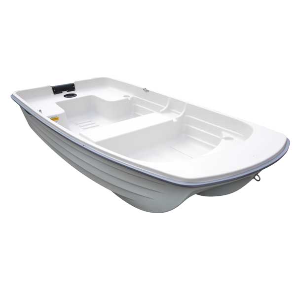

Anyway, I'm glad it didn't pop while we were floating. But really, I'm done with compressed air and hard floor installations. What I really wanna know is if any of youse guys own one of these Water Tender 9.4's:
The specs look good, the videos look good, the price is right, and the SOB will plane with single operator and a 5hp Lehr OB. Thoughts? Issues? Beware of?

The photo looks like it is a PVC model not a Hypalon (or whatever the current name is). PVC is really susceptible to UV degradation, hypalon less so. That alone could be part of the problem.
Another issue is its history. Why was the seller selling the boat? Had it been repaired? Had it been repaired properly?
Until the boat is in the water, I never fully inflate my dinghy. I try to keep it inflated enough that creases don't form and weaken the fabric, but not so inflated that it over stresses the seams. Once in the water, the water will help dissipate any heat and pressure that builds up from being in the sun. It is best to fully inflate the boat during the heat of the day rather than early in the morning or in the evening. Helps to keep the pressure down and stress off of the seams.

Hi Dave, yeah the dinghy was PVC. I applied one of those PVC boat number plates and perhaps that had somehing to do with the internal seam failures. The air coming out of the dingy smelled like Tetrahydrofuran (THF) very distinctive, and may have permeated the fabric. I had the dingy inflated to just between 1-3 lbs., hard to tell with my gauge, but just off the 0 stop. It was perfect for use in the shade of my garage. Once in the sun, I think the pressure built up, the THF fumes became active and...poof, one flat dinghy.

The water tender has been around for decades and served us well over several seasons in the Bahamas.

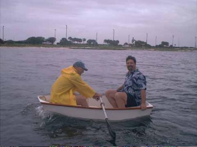

There are cheaper options. I built an "8-Ball" stitch and glue hardshell dingy with sailing option for around $400. without the sail hardware (mast, blocks, sail, dagger board and rudder) it would have been around $250. Supper simple to build. Took me about a month of after work and weekends. Plans are available on line.
I'm not a fan of motors so I row my 8-Ball. Can make about a mile in 5 minutes fully loaded. She will cary 2 adults and gear easily. Max loading is 4 adults. Flat bottom makes boarding easy and I have gotten here to plane under sail in 12 knots of wind. Made of epoxy fiberglass and painted I'v seen NO indication of UV problems in 11 years

You bought a used PVC dinghy on CL, glued something to it that may have caused the failure, it failed, and concluded inflatables suck.
There's a reason inflatables are the most common tenders out there: they work better over more applications than rigid tenders. There's a reason CSM (Hypalon) is the preferred material: it lasts and lasts. PVC is false economy.

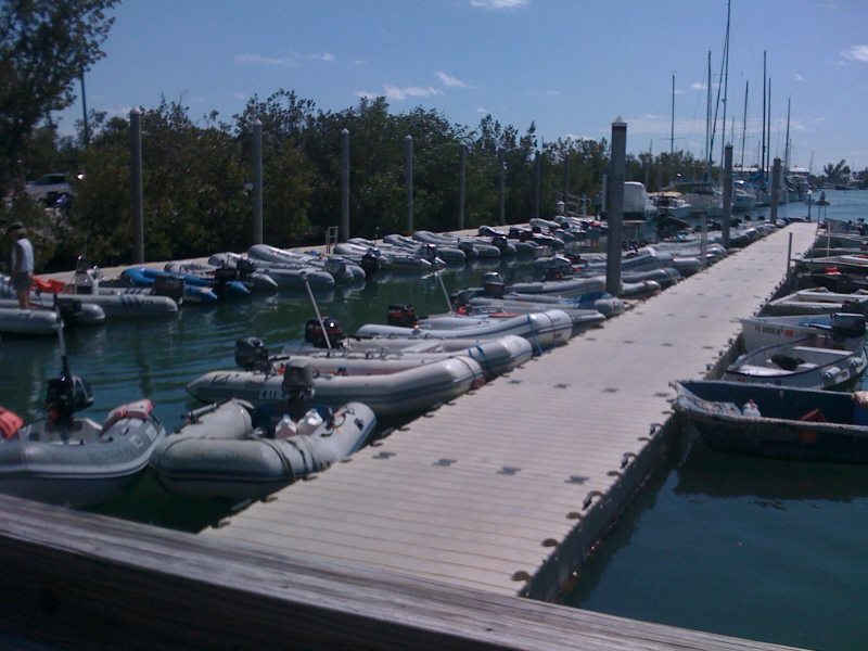

rofl- one of the four dinghy docks in Boot Key Harbor

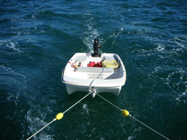

OK, I have one that I have used for over 18 years. I had one for six years before that which was the same but branded differently. I got tired of carting around, inflating and deflating and I replaced three. I tow it and have never had a problem. It weighs about the same as a Hypalon. I used it to take a dog to a rocky shore without worry and can leave it at the dock with work boats without concern. I do have an inflatable which I sometimes carry for overnight races and long trips home, but not often. I was impressed enough with the Watertender that I explored distributing them before West Marine picked them up.

Hi Wayne
I just bought a water tender and it is very stable. It is rated for a 5 hp engine so I got a 5hp mercury but found that it is a bit heavy for the boat. Mine is a 4 stroke so heavier than a two stroke which might be OK. In the end I decided to return the engine and get a 2.5 hp instead. I don't get the 2.5 until later this week but will let you know once I've tried it.
I spent yesterday morning in the water tender chasing my grandson around in his optimist dinghy. The water was pretty flat but the WT with the 5hp worked well. It was a great morning!!

I have a Watertender and like it a lot. Not quite as stable or the weight capacity of an inflatable, but hasn't dunked me like my Walker Bay 8 did. Turned that one over twice. Had two inflatables in the past but couldn't keep either one from leaking air out or water in. Got the Watertender at West Marine as a close out, only $500. One thing I really like is they're made right here in Muskegon, Michigan. Buy local. There's about fifty boats in our mooring field and about ten are using Watertenders. More than any other single brand.

The "8-Ball" is 90 lb in full sail trim, about 80 lb when set up for rowing. On a related note, my oars have never "not started" or "ran out of gas" or been a PITA getting it into/out of the boat," or "has gas storage problems" or "required winterization" or "needed maintenance beyond cleaning".
It will accept an 5 HP motor if that is your thing.
I'm also not at all certain that a hard shell is less stable from a getting in/out viewpoint.
