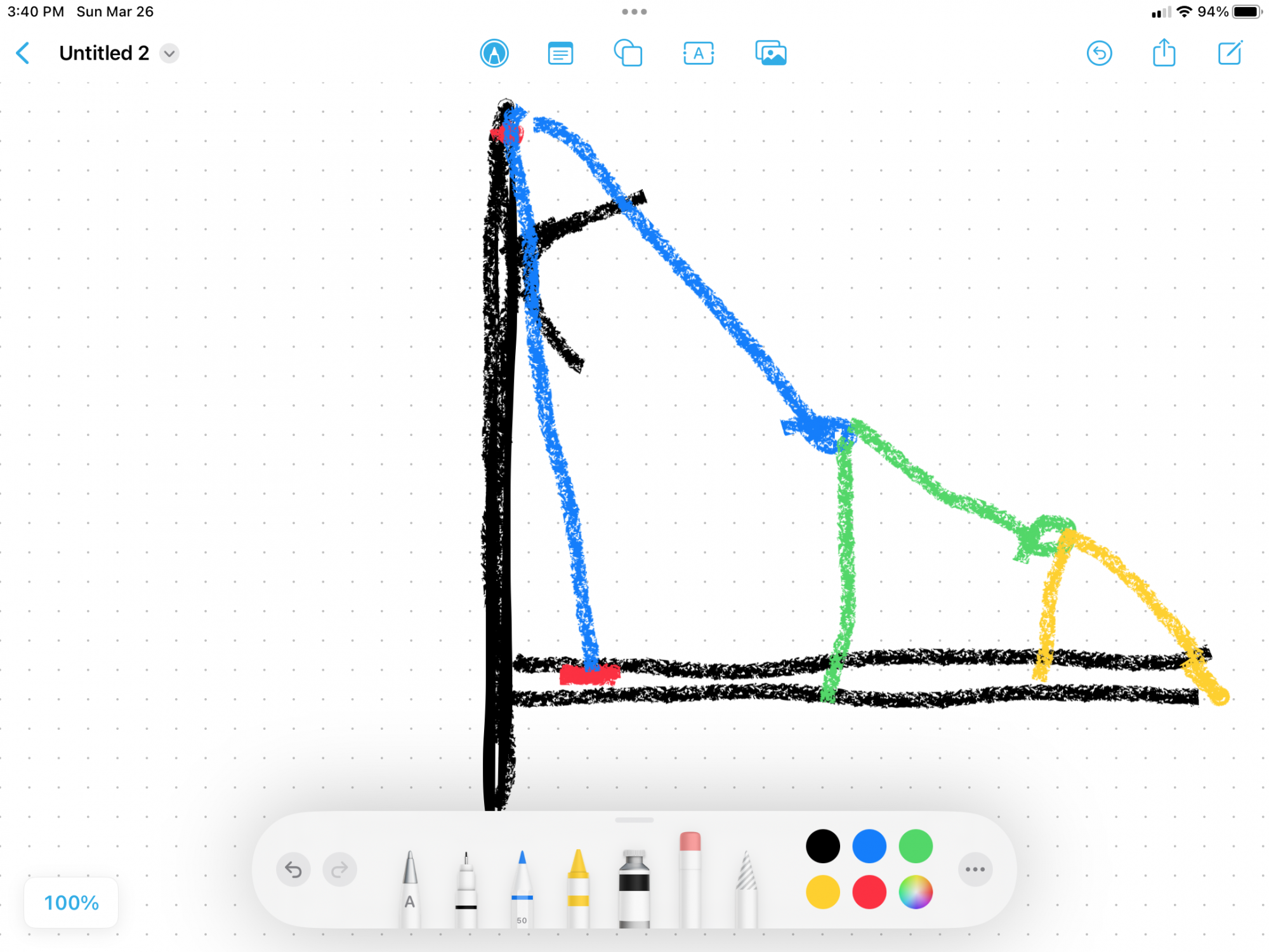

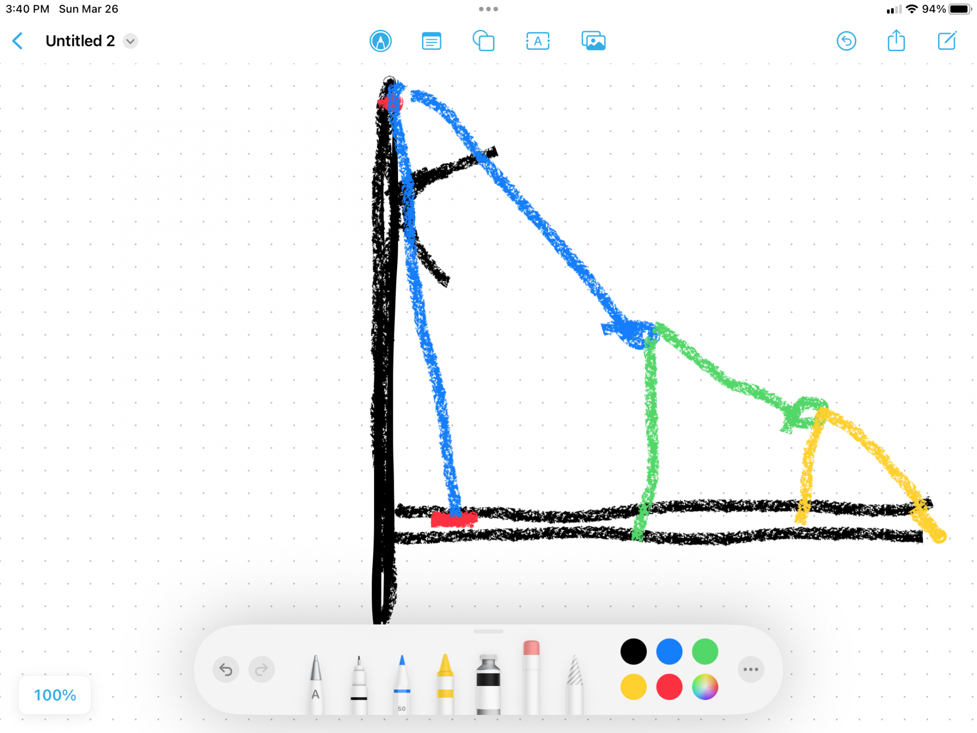

To clear things up a bit, the manual specified a pad eye on the mast for the line that runs (almost) parallel with the topping lift. If I had needed to adjust the tension, I would've had to climb the mast and retie that line. Since I've never used a lazy jack system I know it will take some more experimenting than usual.
My modification involved creating a long loop between a cleat and pad eye. The green arrow represents the range of adjustment. The top lazy jack line is what I was tying to the loop yesterday

I cant draw like you :)
On mine, the blue lazyjack is cleated off at the red cleat. To tighten ALL of the lines,, I pull that line down and cleat it off. To loosed ALL of the lines, I uncleat that one line, and introduce slack into the jacks. That line is pretty long, and I just coil up the loose end.
I can even loosen the blue line enough to pull all 3 lines parallel to the boom to free up my loose-footed main.

I used a little program called greenshot to make that. It's good for making diagrams and screenshots
The attachment height of your blue line to your mast is what I made adjustable
