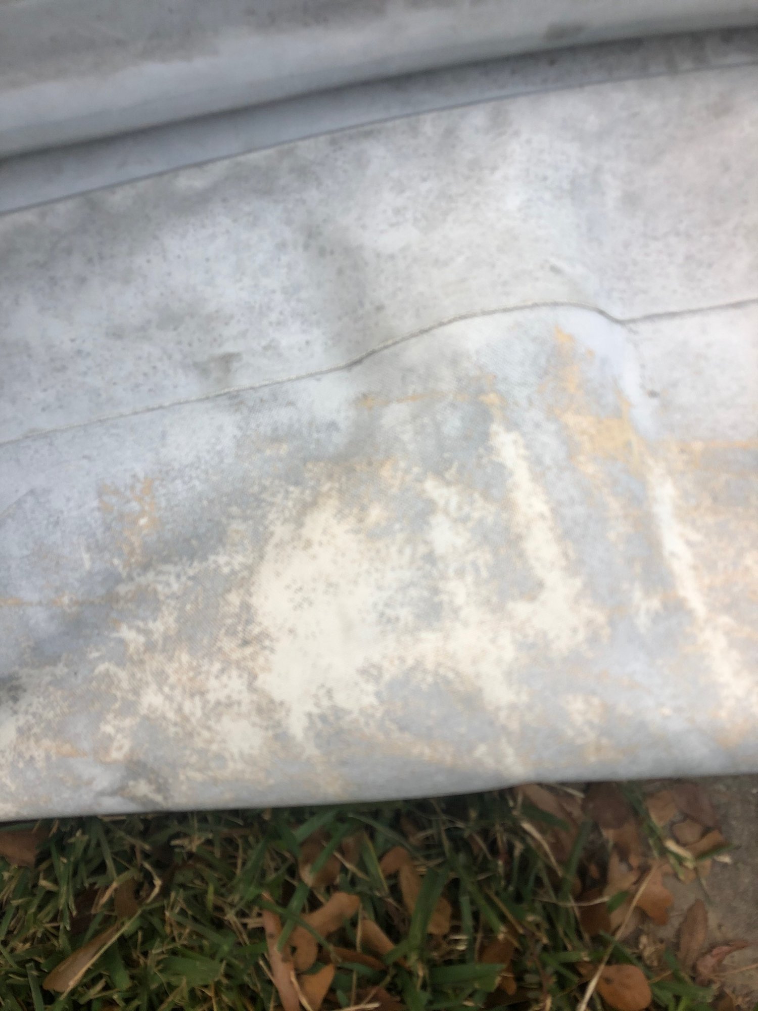

So I thought I was getting a good on craigs list on this ab inflatable, seller said it had a leak but I did not inspect as well as I should have. Looks like it is down to the fabric in some spots. Your thoughts?

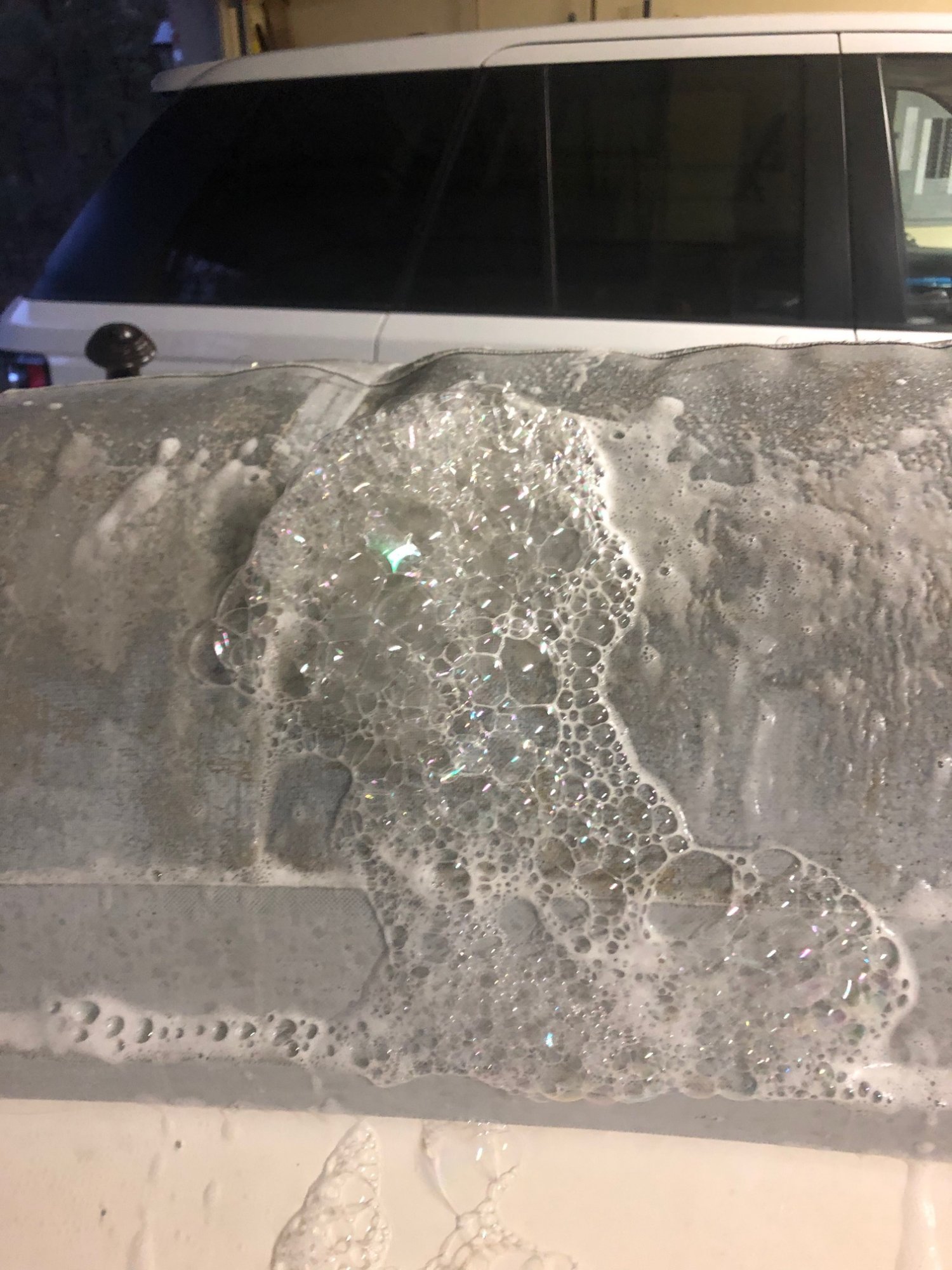

Does it hold air? Does it have an obvious leak? Does it have slow leaks? Are you worried about cosmetics?
Jun 14, 2010
2,466
@scuba201 Just to add to my prior advice -- if you have leaks I would start by inflating it very firm, then use a solution (in a spray bottle) consisting of a few drops of dish soap in water. Spray it all over and look for bubbles to find your leaks. Then make the decision whether to paint or patch.
OR
If the wear in the photo you posted is widespread you may want to consider finding another dinghy in better shape.

Leaking as expected, I think I am going to try the TUFF SRC product, and an interior sealer as recommended by AB inflatables.

Obviously the degradation is on the inside of the tube, so no amount of paint will do much good. If not too extensive, a patch or two might work for a while, but once the inside of the tube begins to degrade, you will be chasing leaks forever.
If you have the finances and you feel this dink is worth it, inflatable/liferaft service shops could help as mentioned above, but in my opinion, you'd be throwing good money after bad. Call this one a (hopefully) not too expensive lesson and look for another inflatable.

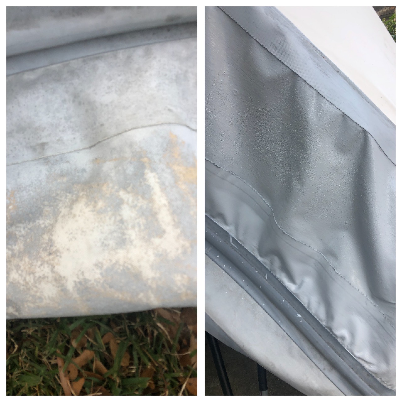

Three coats of base coat down on the worn areas. Plan is to let it cure for 24 hours, reinflate, check for leaks, and then cover the entire tube with base coat, cure, then top coats weather permitting. I am very happy with the way it is looking so far.
