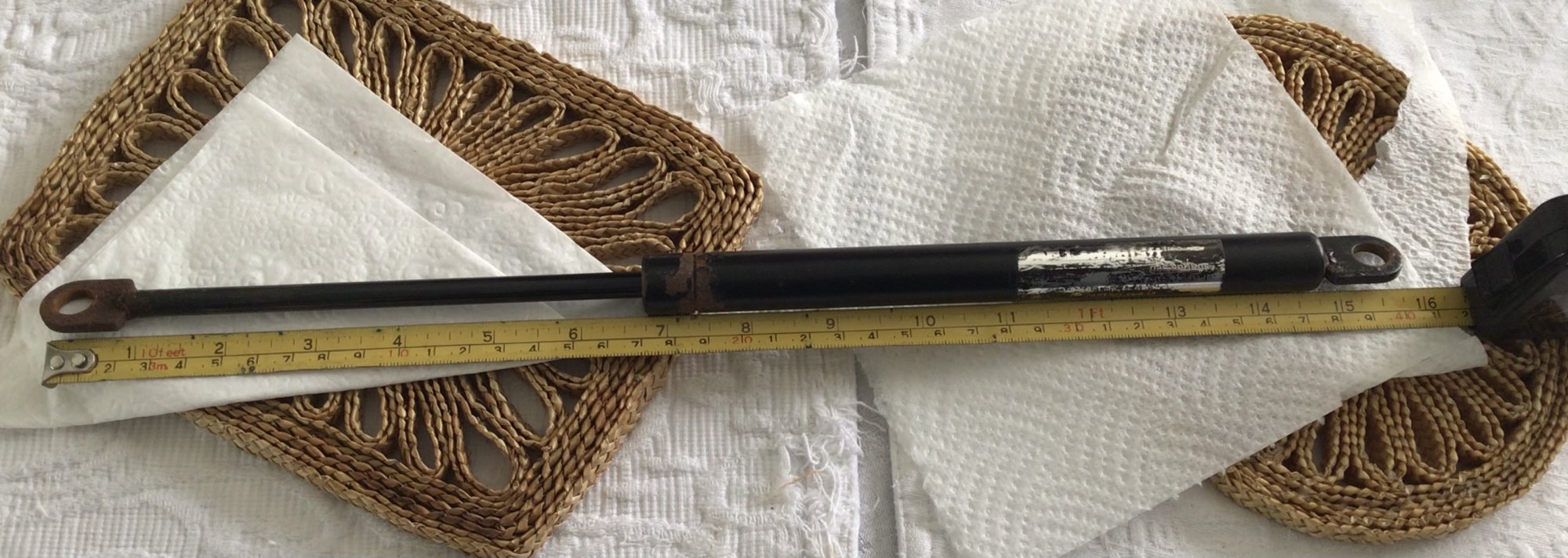

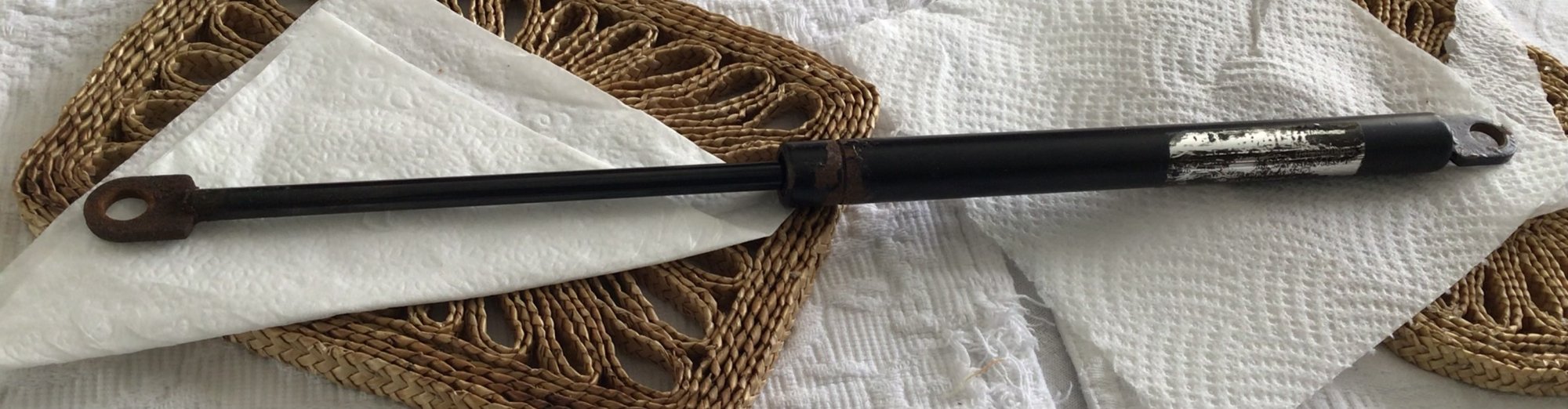

I need to replace the Lifting Arm on my 2000 340 Refrigerator. The only thing readable on the old arm is the Part Number. How good
is that. Part No. SL-2-40
It measures 15 3/4 inches fully extended.

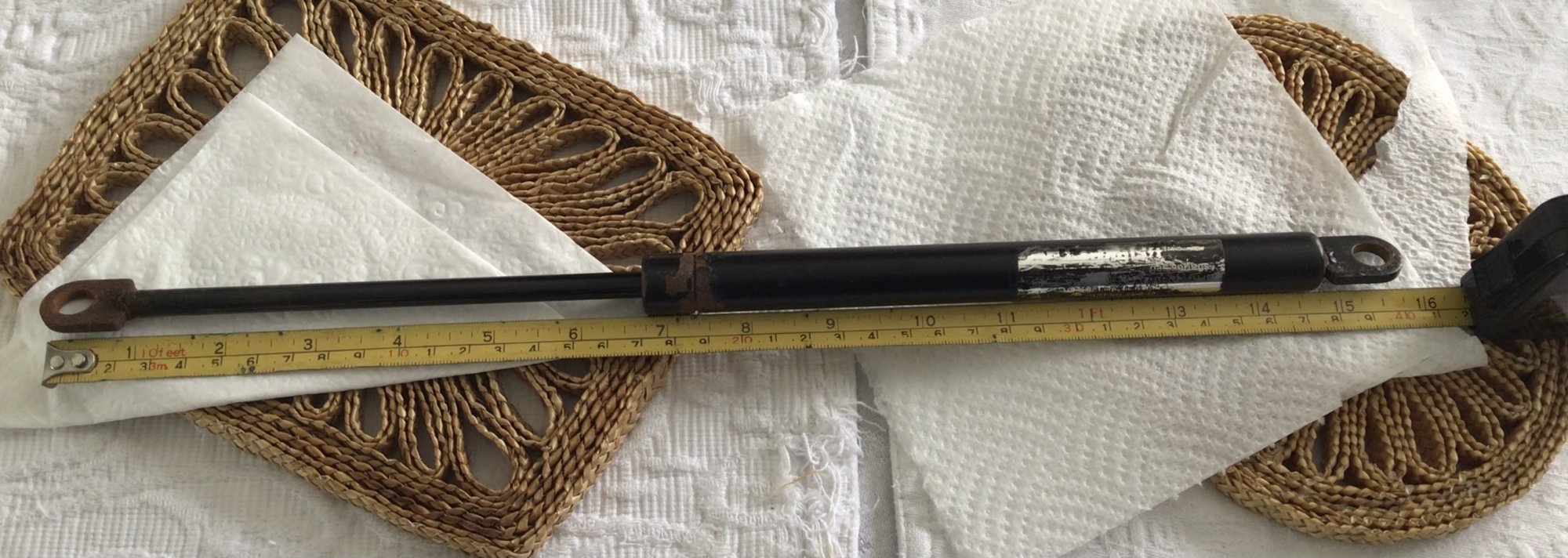

I have a new one arriving today from the SBO store. My original part number is SL2-20, but Mike remembered they had a part number change when the lid material was changed and made lighter. He recommended the SL2-30 which I understand is same geometry but stronger force. I'll install on Monday and report back.
Measure your current gas spring fully extended and fully compressed, between the centers of the holes. Mine was 15 in extended and 9 3/4 compressed.

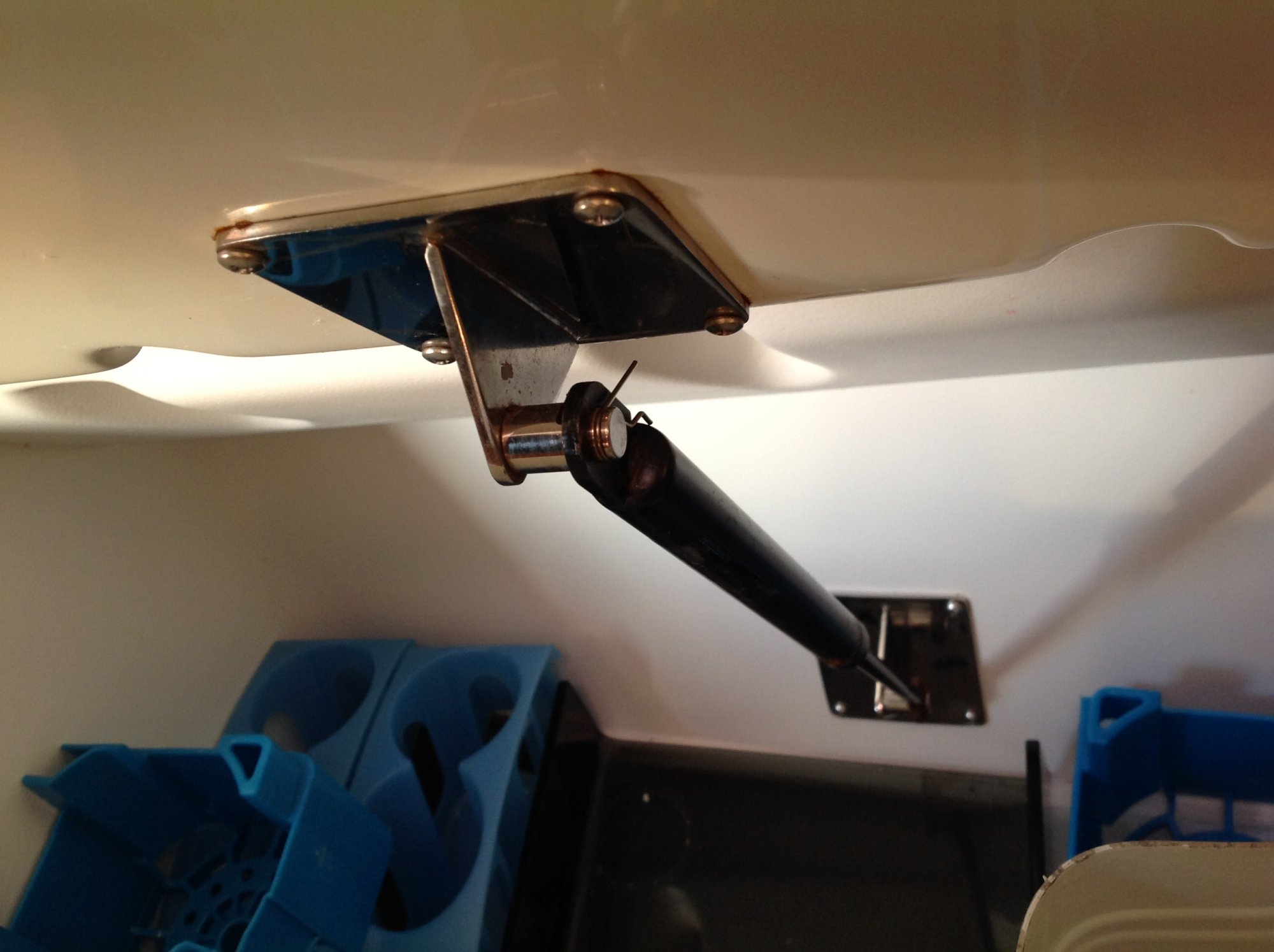

Mine measures out the same as yours did, 15 and 9 3/4 inches. I can understand the stronger force, as that lid is heavy. I’ve seen others but they all have thicker ends and won’t fit on the existing brackets and allow the spring clips to sit in the grooves to hold it in place.

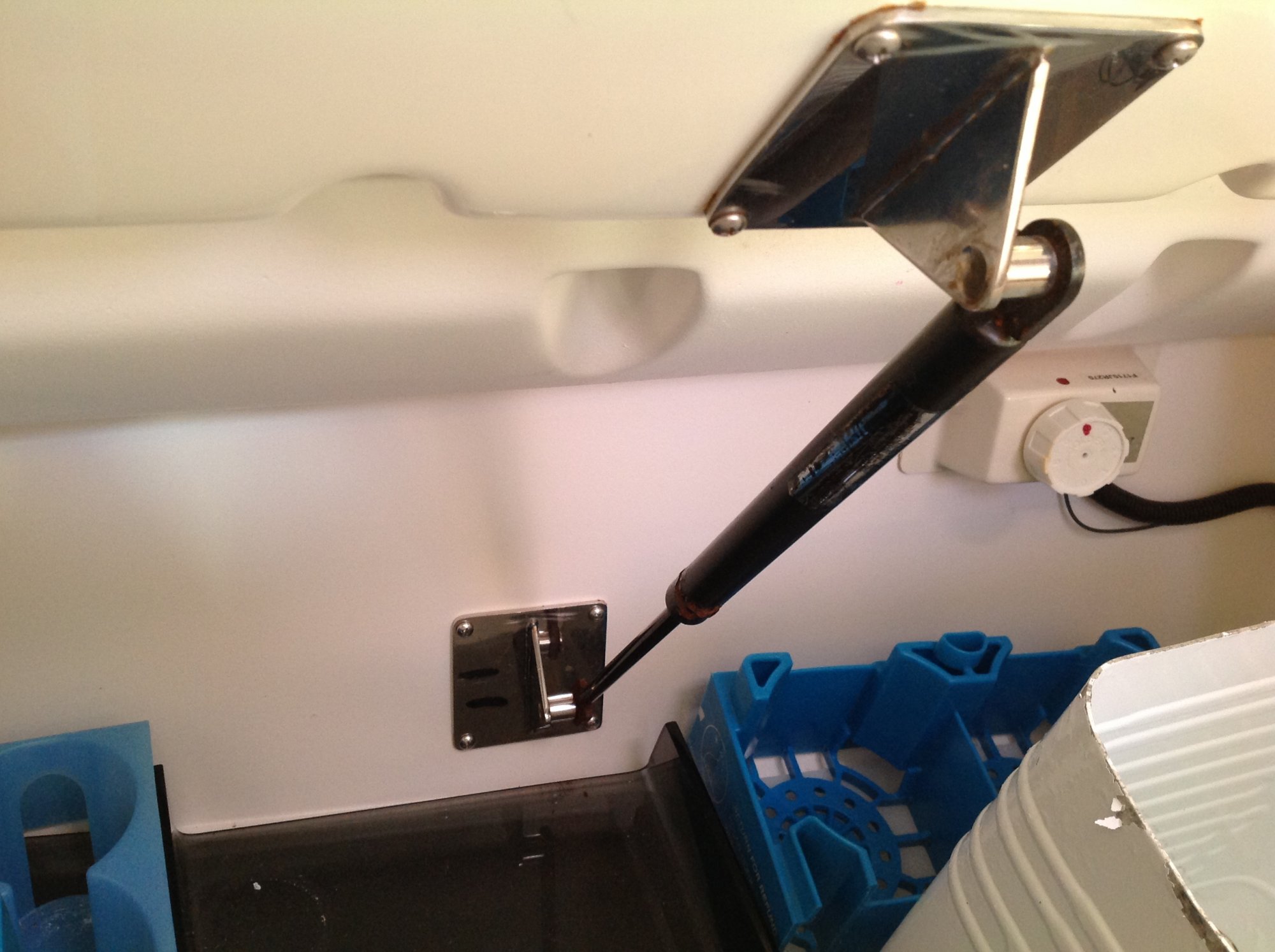

SBO store sent me the SL2-20 which is the exact replacement 20 lb force version (what I had from the factory). Installed in about a minute and it works like it should, balancing the weight of the lid without applying extra force when opening or closing. I think the 30 lb version would be too much opening force.
