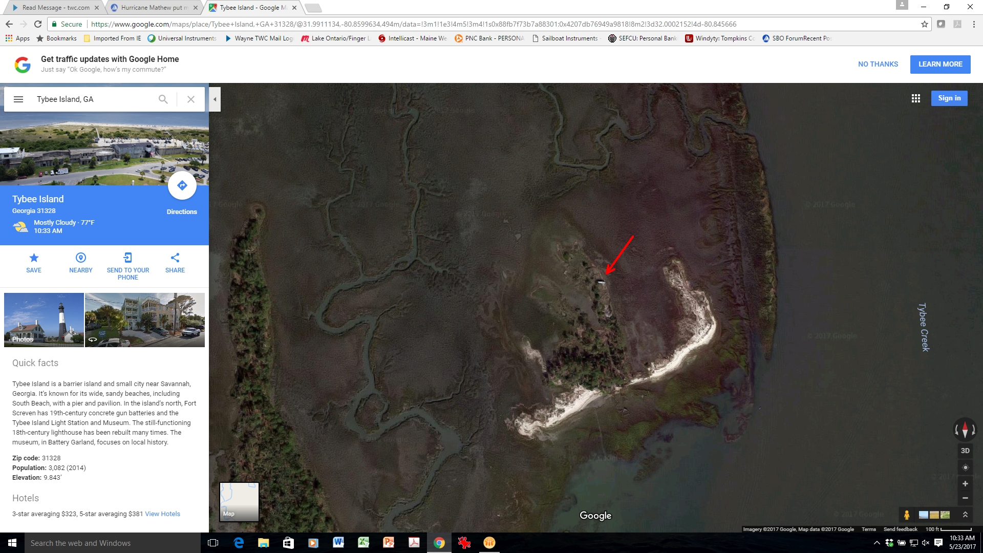

Well... not sure, there's been no progress but do have some hopeful possibilities in the works..
A friend is suppose to have access to some large used PVC pipes that he says he'll bring from town down to me so I can use them as rollers, the stern is currently right at the edge of the little hill before it drops about 16" down to the marsh area, so if the rollers are laid there then the boat should drop down right on top them (if it doesn't bust them) I'm going to try using some auger style mobile home anchors screwed into the ground so I have something to pull against with comalong. A friend has 4 - 200ft sections of very heavy cable he had salvaged from a shrimpboat which he says I can use, which is probably better than using rope.
Also might have a group of about a dozen kayakers volunteering to use brute pull force to pull with ropes..
I've been unable so far to get someone else with a boat big enough to try another pull.
Nothings definite yet.
Fortunately there has been no more looting going on.
