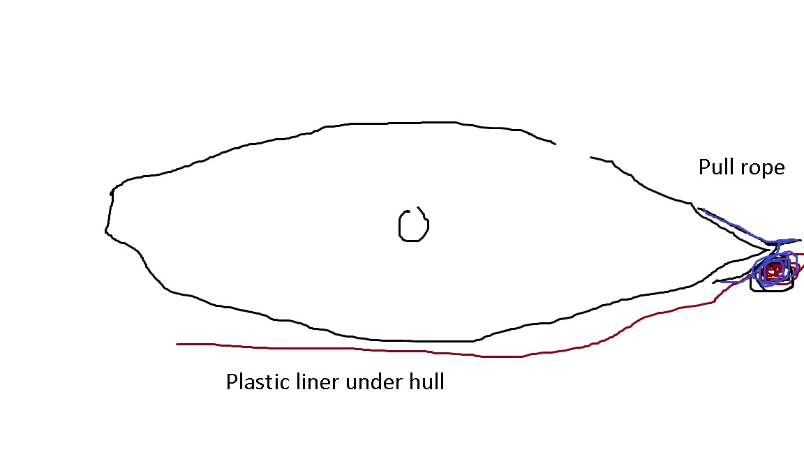

End80, you might consider trying a sheet of plastic several mils thick instead of plywood. It would easily slip on the ground with any level of moisture present. You would not need any soap at all. If you could find an old swimming pool liner someone had removed, it would be strong enough to do it for sure. Contact a local swimming pool company and see if they will give you an old liner they removed. They have to dispose of them anyway, so it should be free. They are at least 20 mils thick and are very difficult to tear.
If you can get the plastic liner under the hull, secure the bunched end of the liner to the pull line at the same point where you connect it to the boat. Tie to the boat first, then wrap the remaining line around the bunched end of the liner.
I have moved some heavy items on dry ground just using six mil visqueen plastic, dragging them with the bunched end of the plastic. You would probably need much thicker than that to handle the weight of a boat. I have dealt with pool liners and they are tough as heck. If there is any moisture on that ground they will slid even with a lot of weight on them, if you had an inch of water, I bet it would work.
If you can get the pool liner free, not have to buy any soap or plywood, then it might be worth a try. I realized this sounds like a crazy idea, but I am a retired engineer and sometimes you have to think out of the box. So far, nothing else has worked.

Back to the pool liner: I once had to remove an above ground pool from my property. It was probably twenty years old. It was so tough I quipped it could have taken a nuclear strike. And I meant it. The liner was hard to cut with a knife. It was hard to cut with scissors. The new one was nothing like the old one. So if you go that way look for an old one.
