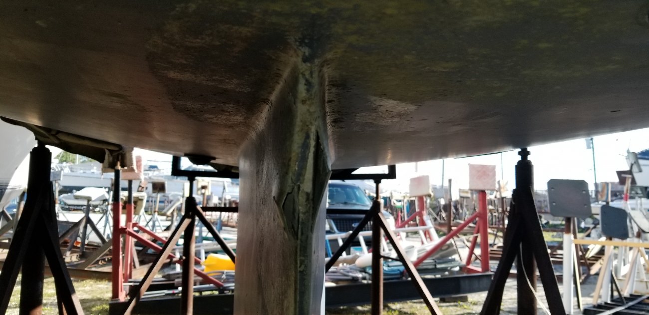

Jens, how did you end up fixing the keel and did you ever figure out what caused it?
I have a 2002 356 and just pulled her out for winter storage and noticed the same type of delamination behind the keel but with no crack see picture below.
