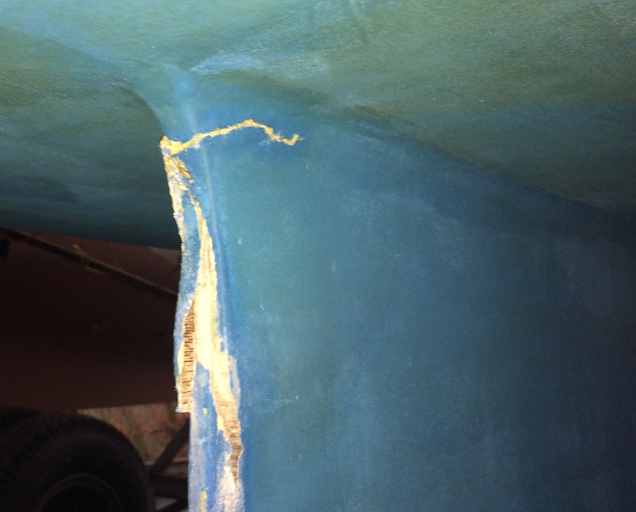

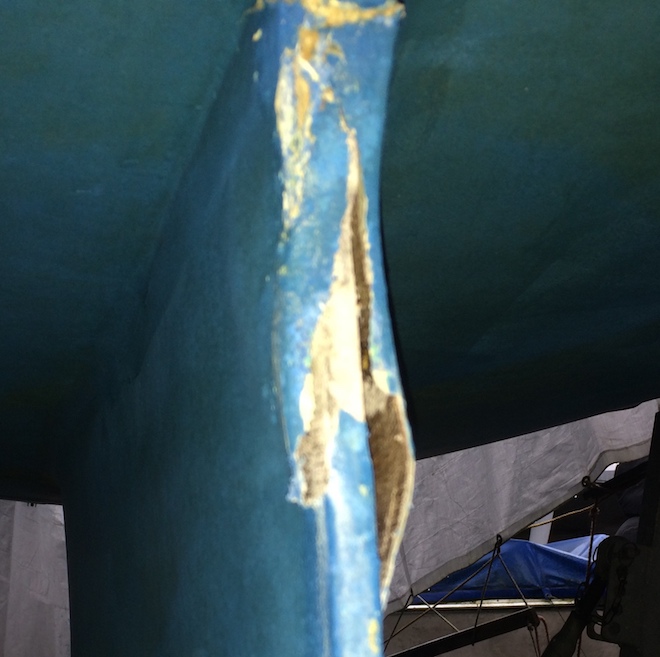

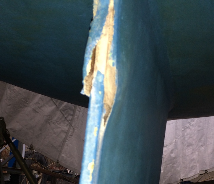

Hi,
I just discovered that my fathers Hunter 356 (model 2002) has damages at the keel which appeared during the winter. The cause is unknown but speculatively could be a previously hidden damage from 5 years ago with a vertical grounding (due to a wave) while anchoring in shallow sandy water. Earlier, no damage was visually detected.
It looks like that the top layer of the keel breaks of.
  • Is this the line where the keel stub and keel are connected?
  • How could this happen? Through penetrating water which then froze in the winter in the dry dock? Could the water enter from the bilge over the keel bolts?
  • How is the keel stub sealed to the keel?
  • What material is used for covering the core of the keel?
  • How can this be repaired? Has anybody repaired a similar damage?

Speculating isn't usually a good idea. It could be a hard grounding, ice damage, etc...
I'd suggest you check the keel bolt torque, sound the keel and then open it up where cracked to see if it's simple delamination or water/ice intrusion. You need to open it up anyway to remove loose material and check for water damage causing rust to the internal webbing which would weaken the rudder shaft bond.
The keel is most often glassed in before attaching it to the stub.

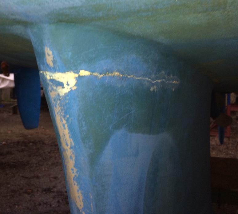

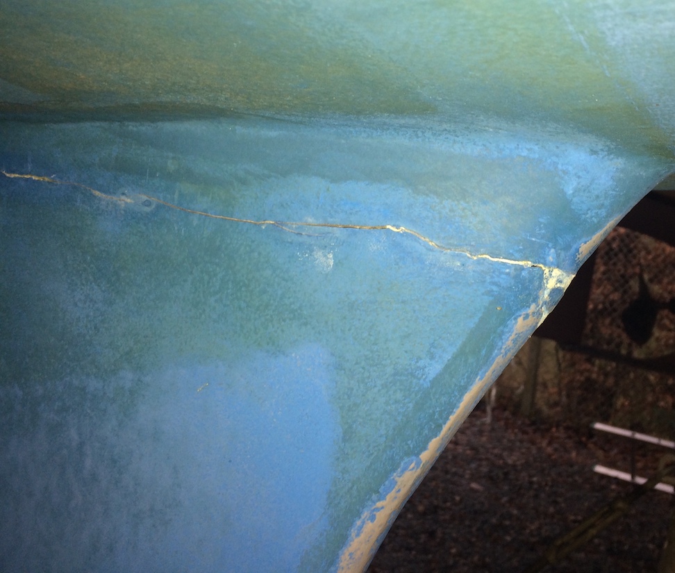

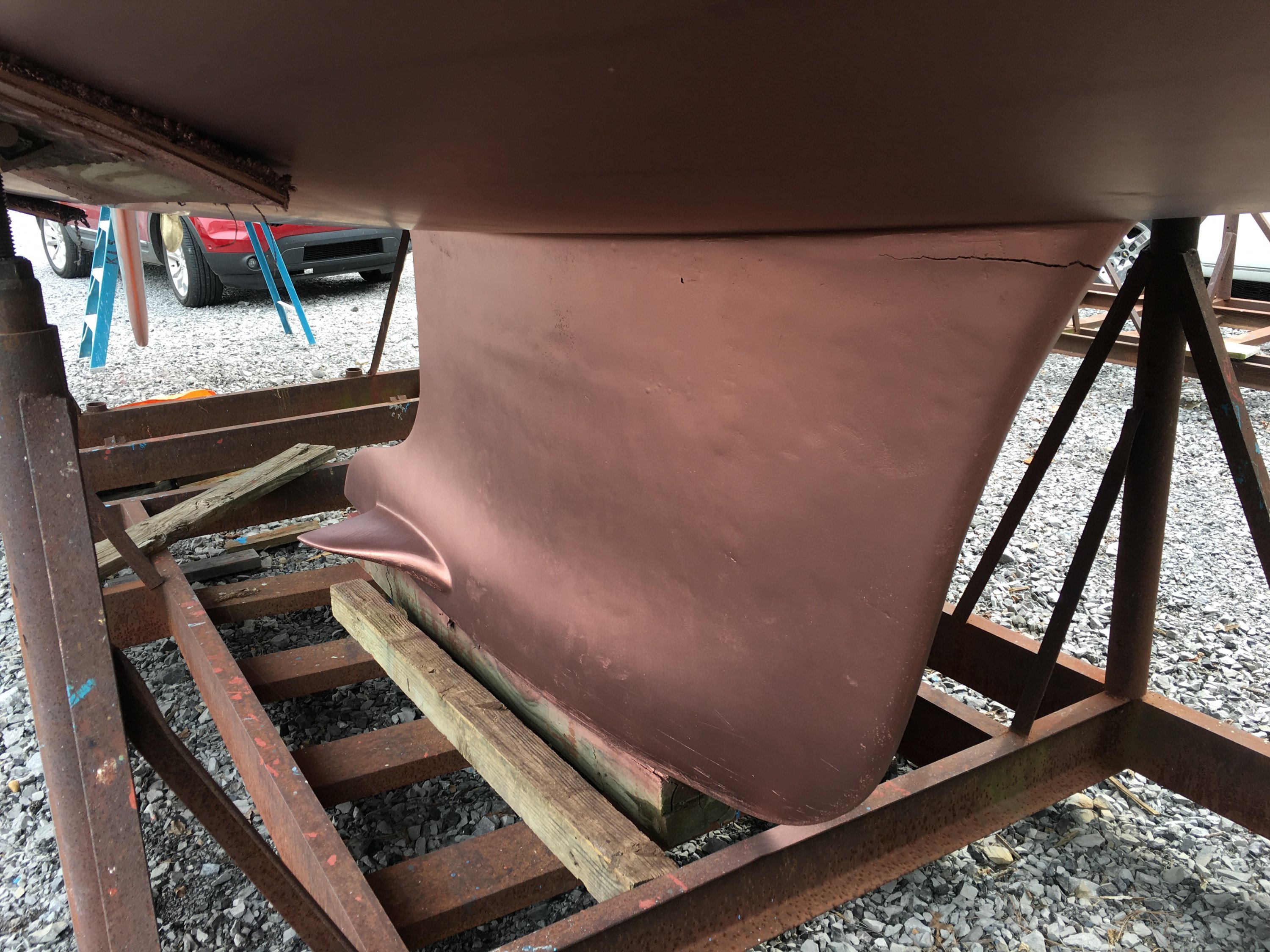

In the fourth pic, the line along the keel approximates the joint between the keel and stub that it attaches to. That crack is not overly concerning. In the first two pics, I think that is fairing that has broken away. That is the aft part of the keel? Hard to imagine hitting an object caused that. In a hard grounding the aft part of the keel can be driven up and rearwards. You might see damage like that. But my money is on freeze damage.
Keel stub is attached to the keel with bolts, of course, and 5200 in most cases. On my H356 there was barrier coating and bottom paint on the keel. No fiberglass on the keel itself. While you may get away with grinding the fairing down, and maybe some of the keel stub fiberglass, you may want to lift the boat off the keel and get it right. I would get your insurance adjuster out there and see what they are willing to do. If the damage goes into the laminate of the stub you could have structural weakness. Adjusters would call this "Fiberglass work" and allow $12,000 to $15,000 for it - and remember the rig has to come down. If the yard manager seems at all hesitant about lifting the boat off the keel, I would launch it and drive it to a facility that knows what it's doing.

Just a guess, but I think the hard grounding may have caused a very small crack in the glass allowing water in. Then it sitting on the hard and the water freezes causing the glass to burst open.
Hunter does not use 5200. They use an epoxy filler in house mix. They believe this gives it a stronger connection and the filler gives the epoxy a little flexibility. It looks and acts like 5200 but isn't, according to Hunter.
I would drop the keel. Grid away all the bad glass, relay new glass and then re-attach the keel with 5200 (lots of it). Of course, do all the griding, cleaning and leveling of the matting surfaces and bolts before re-attaching. Then bolt it down to specs and then re-check the torque a week later, a month later and after a decent amount of sailing too.

Shemandr has it right - according to Hunter the keel is bedded with 5200 and bolted to the stub - the "smile" in the later pics is the joint. On Escape the joint is faired with polyester fairing compound over about 4". I suppose on some boats there may be more, possibly from mfg or pre-delivery damage. It's very brittle, so cracks don't always mean structural issues. The keel is solid lead, and I've never seen a 356 with that much "stuff" around the joint - it looks like glass added and delaminated from the lead, possibly from water penetration and freeze, or stress from the impact. As Franklin said, you need a surveyor to assess the damage and whether or not all that stuff is there for a reason.

Nick: I filled my “smile crack” with 5200 when I had my last bottom job, two summers ago. When backing off the boat, the travelift hit my KVH antenna and it opened the keel at the front. We just filled it with 5200, let it cure, painted and splashed. Here is a picture before it was filled. It was just in the front. The KVH antenna was on a pole in the back, so it got a good jolt. We also had a yard guy with some muscle power put a long pipe on a wrench on my keel bolts and torque them down. None moved and he was a good sized guy. Haven’t had the boat out since then, so will take another look when I haul it out next time. I’ve also run around a few times, twice here in the mud on KY Lake and a few times on sand in GICW when we were in Punta Gorda. No fast or hard groundings, just barely stuck and able to back off. Anybody that hasn’t touched and run aground is either a liner or hasn’t sailed much!

I also just used 5200 to fill my "smile" I have a 3/4" drive torque wrench with a 4' length of pipe and I haven't moved the nuts either!
