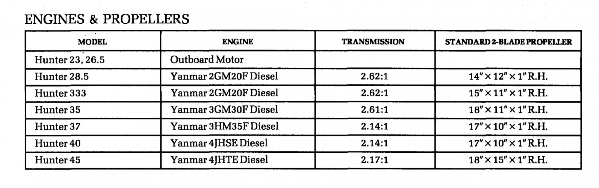

From the ~1987 general Hunter Legend owners manual... but considering the age, should still confirm the plaque in the engine... it could have been swapped at some point.

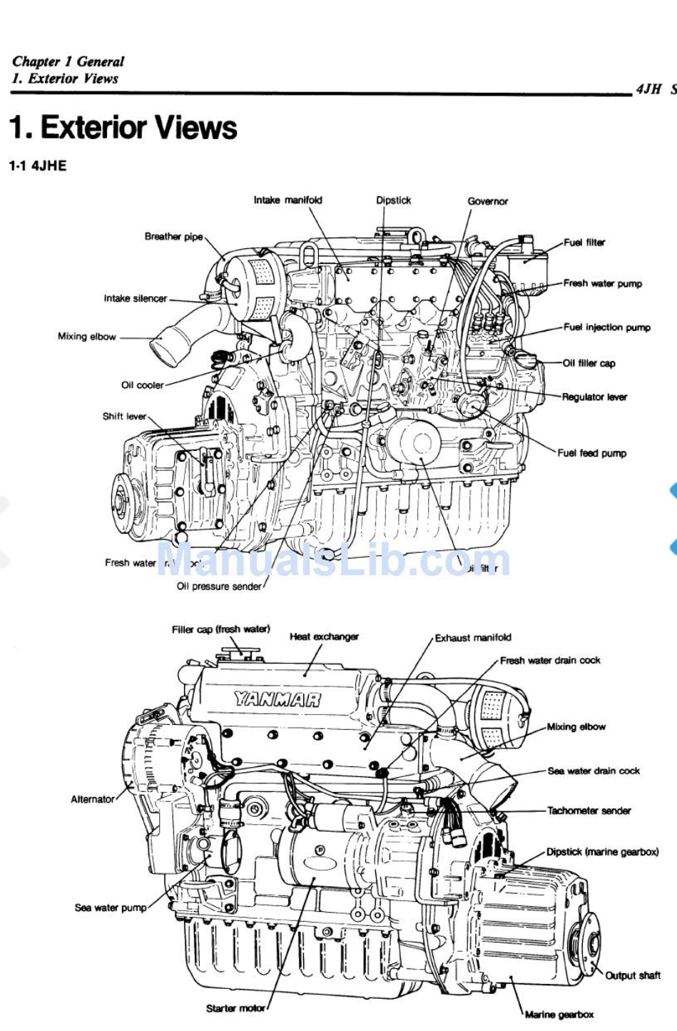

As i read the chart listed it say a 40 ft hunter should have a Yanmar 4 J H S E Diesel
I have tried to search for a manual an only come back with a Yanmar 4 J H 5 E Diesel
CAN IT BE THE SAME ??????

Don't think they are the same.
The JH family starts in the 80's... and has evolved JH2/JH3/JH4/JH5... with the JH5 starting in ~2010.
I'm not a Yanmar expert... but I think you'll be looking at 4JH-E manuals... I don't know why the "S" is there... perhaps it meant shaft as opposed to saildrive... don't know.
You really need to get a picture of the plaque on the engine to be sure.
