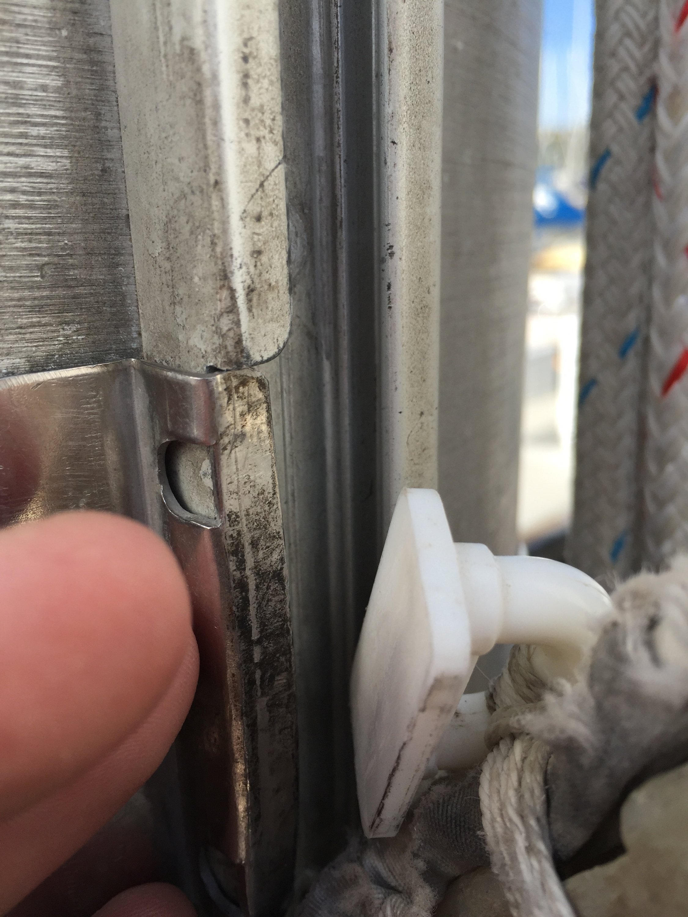

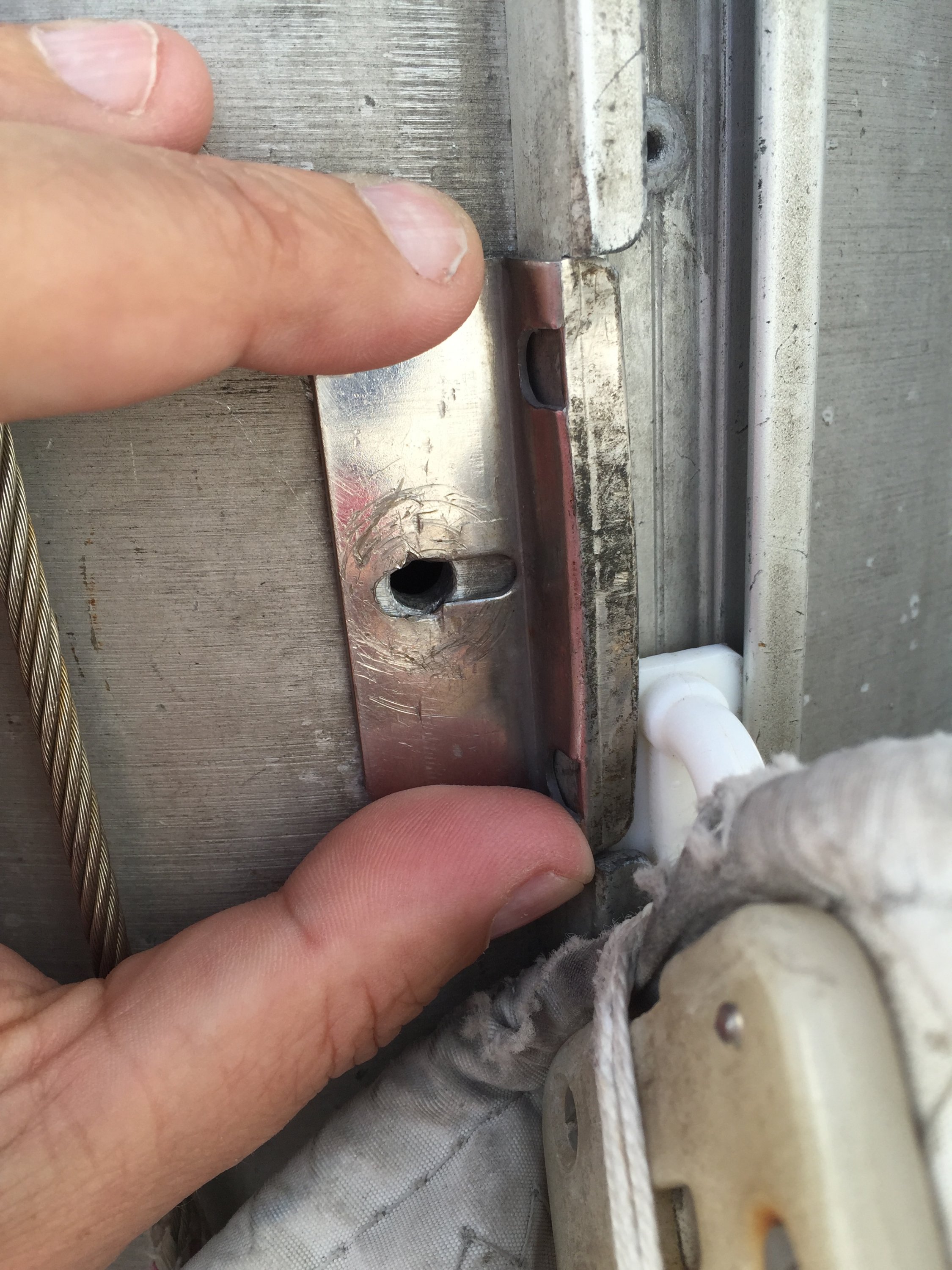

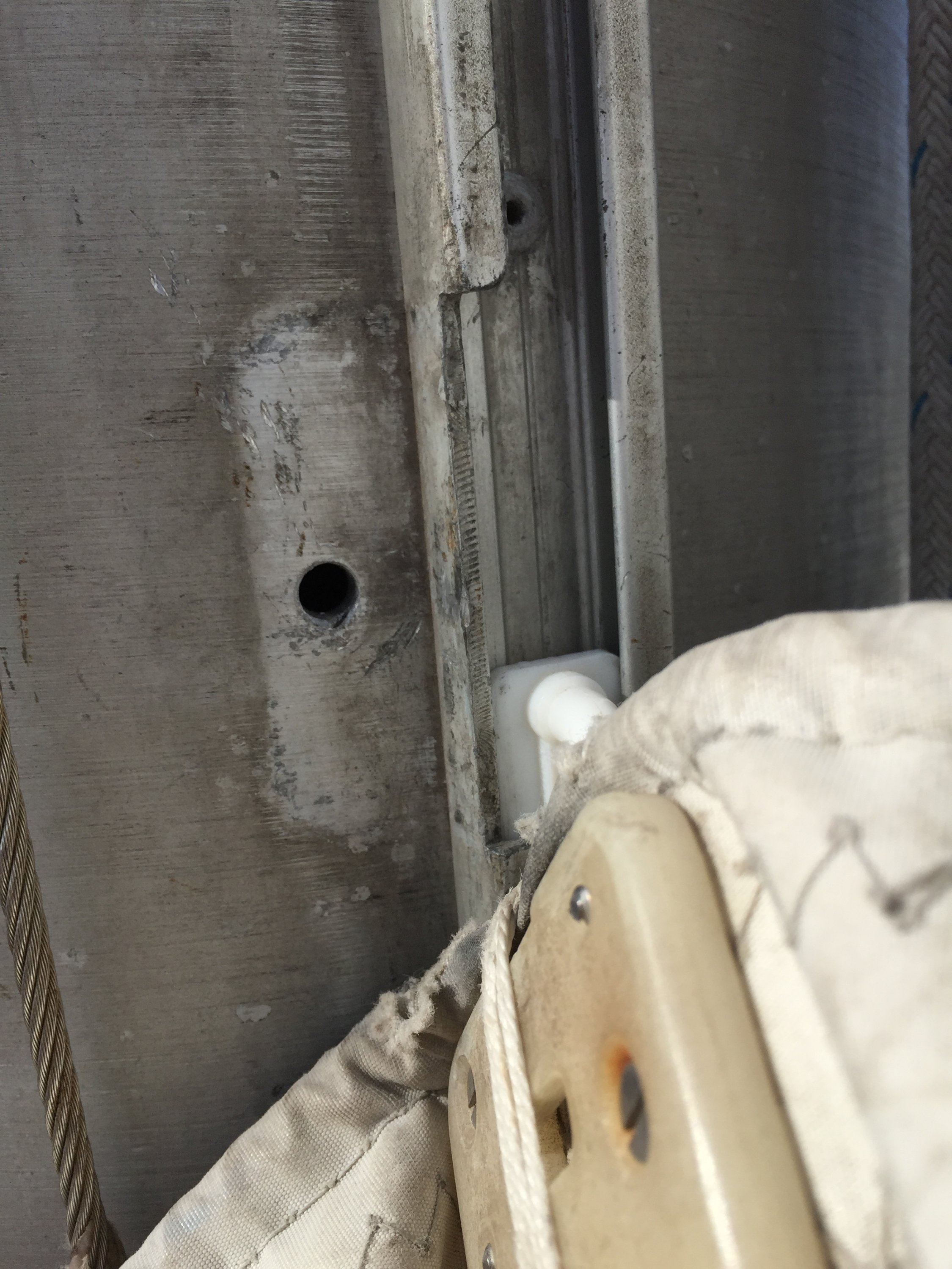

Hi All, I am looking for help with My Hunter Vision. The sail has plastic cars that go up the sail track. There is a plate to the side that can be removed, or shifted, to put cars back in track if they come out of track. ( Please see attached videos and photos.)
We have had this boat for ten years. Even with the plate over the track, with the slightest of wind in the sail, the cars come out of the track while raising the sail. Meaning I have to lower the sail, put them back in the track and raise the sail until the next car comes out. This is
unbelievably frustrating, especially as we have to raise sail outside the harbor. I was wondering if anybody has a fix/bypass for this? Or if anyone knows if Hunter has a fix for this? Also, the screw that held in the plate has come out and is now at the bottom of the marina!! Any help would be greatly appreciated. Thanks
Aug 17, 2013
1,341
Pearson P30 202 Ottawa
I'd start by using a shim under the mast gate you have to get it at the right level so the cars won't have an exit point
or make a new mast gate of the right dimension

Mine had rather larger sail slides from the factory. It was grey. It also had runners on both the top and inside the track. Never any problem. I think you could simply figure out where the slides are coming out. Take the gate to a machine shop and have them make you a new one with larger dimensions in the area needed. As for the screw, just go to ACE and pick up some cheap ones of differing thread counts and diameters. When you find one that fits, go back to ACE and get one in stainless steel to match. Oh, maybe get two :biggrin:

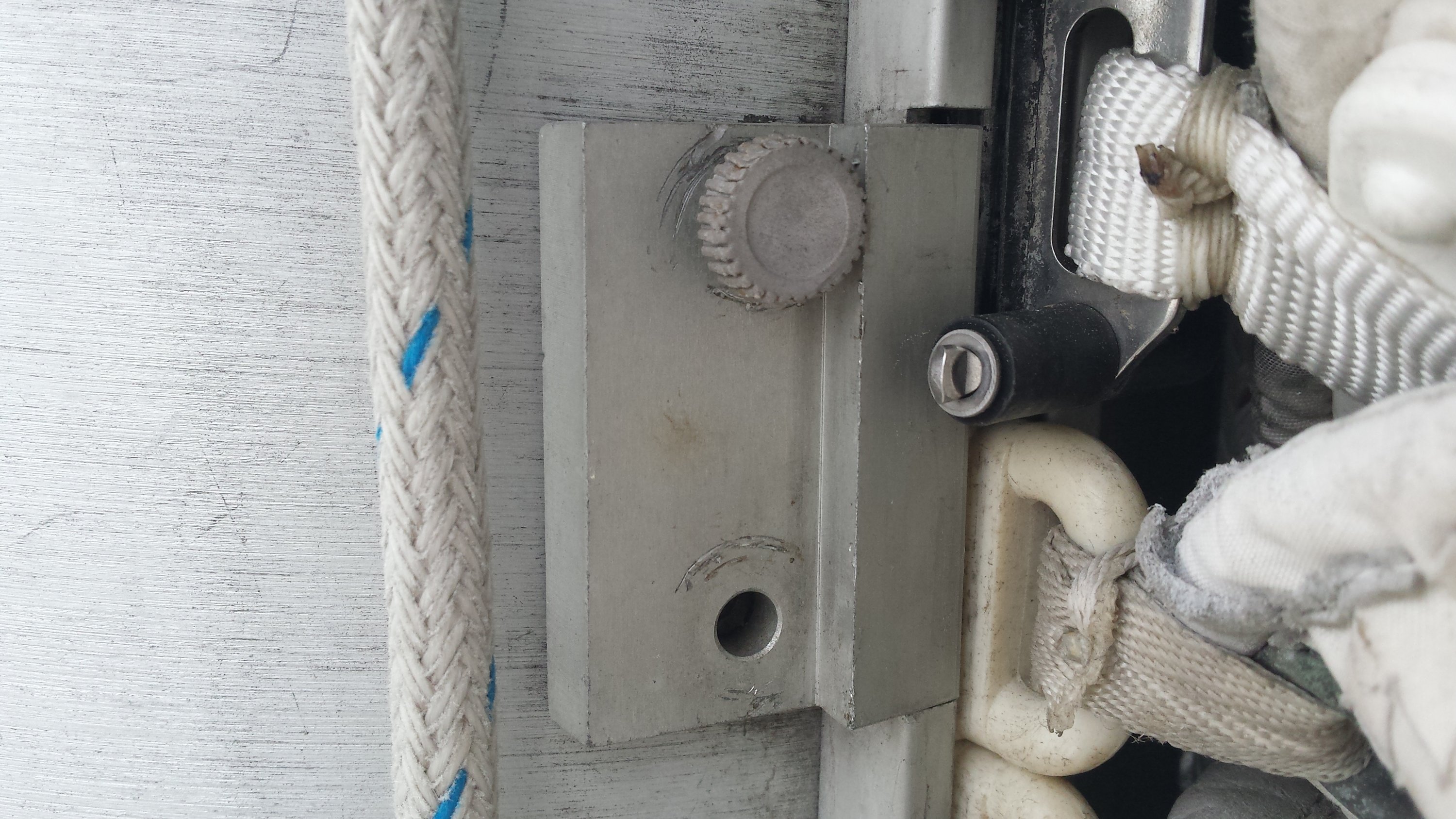

My 1985 H-31 has a similar setup (Isomat mast & boom) the origins gate looked much like yours.
The original gate cover is long gone (died or went overboard).
I was able to replace it with a universal gate cover (stainless steel) that I believe came from West Marine.
There is a rectangular rear flange designed to slide in and remain (while needed) just above the gate and an attached knurled outer knob that that is connected to the rear flange by way of a threaded narrow diameter bolt.
Simply slide the rear flange into the gate, raise it in the track to just above the gate, tighten the outer knob to lock in place and viola ! Gate is closed and sail slugs remain in the track. If your setup is such that there are one or two slugs that are supposed to remain below the gate, buy two pieces and use one for the upper section of track and one for the lower.
Convenient and easy to use, largely bulletproof, and costs less than $20.
