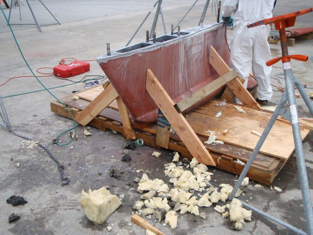

Hi all, I'm considering purchasing a 1998 Passage 450 for cruising Southeast Asia. There's tons I love about the boat, but my research has raised some frightening potential issues with the keels on these boats. I am trying to determine whether these are one off anomalies that have been amplified on the web, or whether they are serious concerns for my intended use.
1) Problems with foam-filled keel void leading to rotten foam and the potential to rust the keel bolts. It is my understanding that this does not require a hard grounding to occur but can be caused by normal use where the motion of the boat leads to a "keel smile" that allows water to penetrate. Perhaps repeated soft groundings can speed the problem. The fix requires dropping the keel, scooping out the foam and filling the void with epoxy - a major undertaking to say the least.

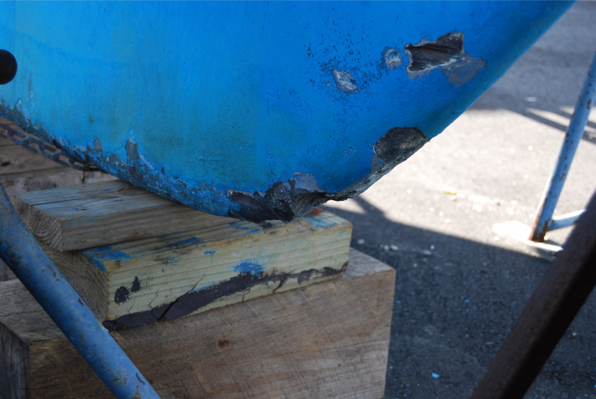

Here's a photo of the kind of keel damage that can be done in a hard grounding. On this boat not only was the lead pushed back there was hull delamination at the aft end of the keel and at least one fiberglass encased wood floor was cracked.
