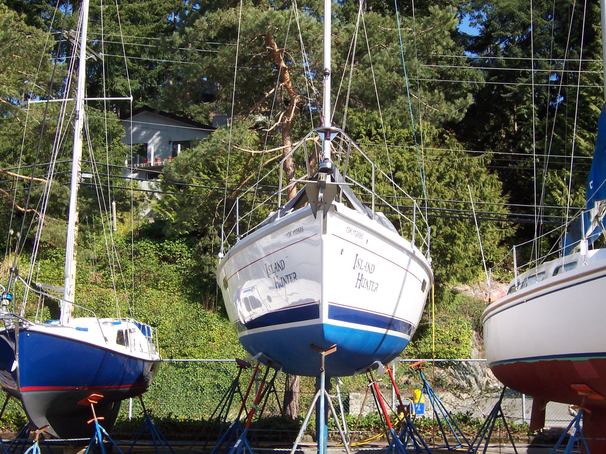

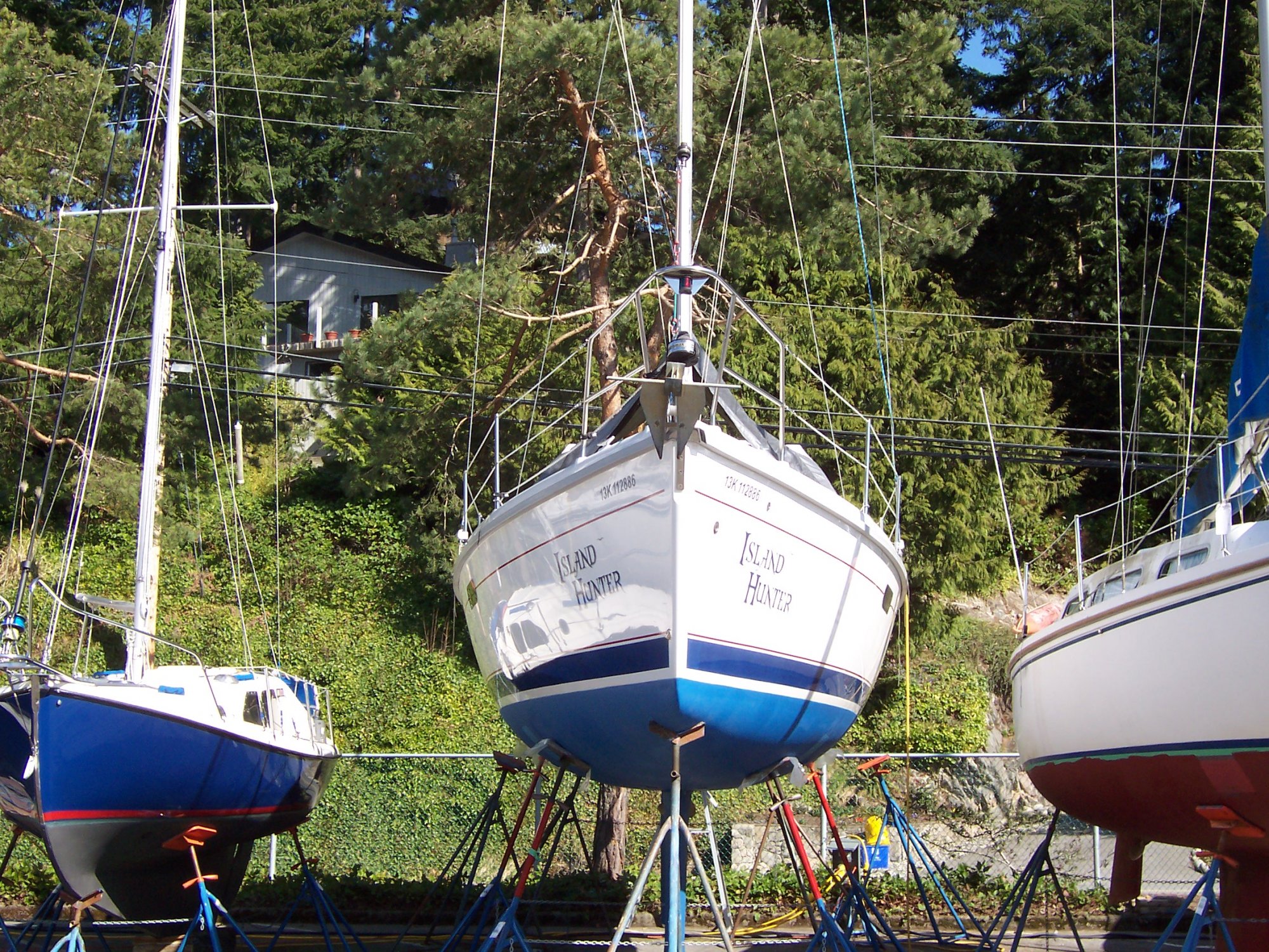

Odd, don't you leave your boat on stands when bottom painting or anything more than 1/2 hour for an inspection and zinc change ? Here, that's the max time you can tie up the lift. How do you paint under the slings ?
