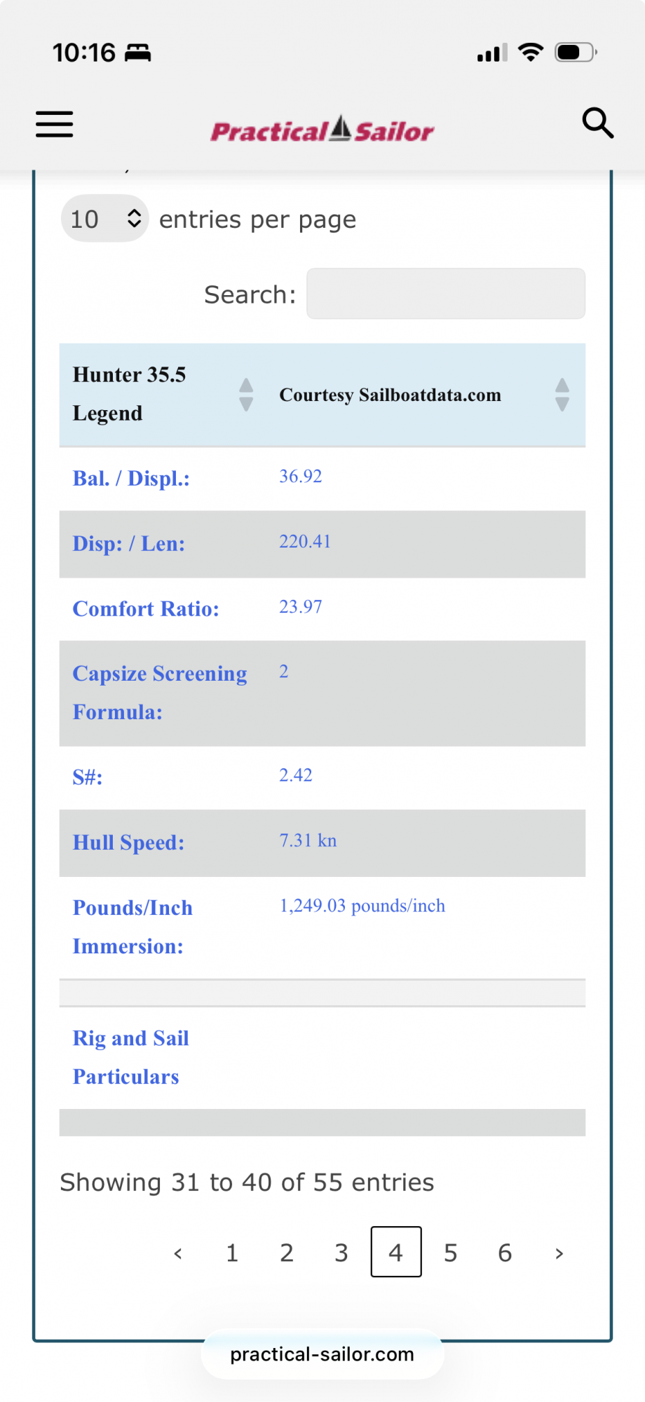

Please explain this statement. I read that the AI stated “ 5.5knots at 2700 rpm.”
The Practical Sailor review which the AI states as a reference is quoted.
HULL SPEED is identified as 7.31 knots.
It is conceivable that a boat like the Hunter 35.5 with a reported LWL of 29.75ft and a displacement of 13000 lbs could cruise at 5.5 knots
The Hunter Legend is reported to have a Yanmar 27hp 3GM diesel engine. (Practical Sailor) WOT for the engine is reported at 3600 rpm. Running at 2700 would be in the heart of the sweet spot (70-80% of WOT) as stated in many of our SBO forum posts.
