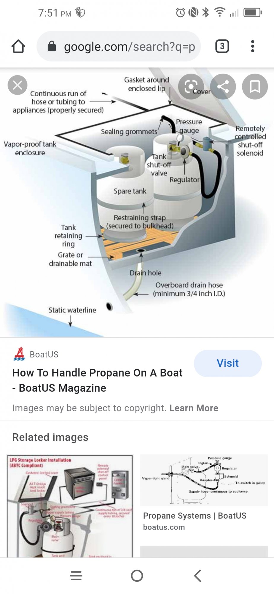

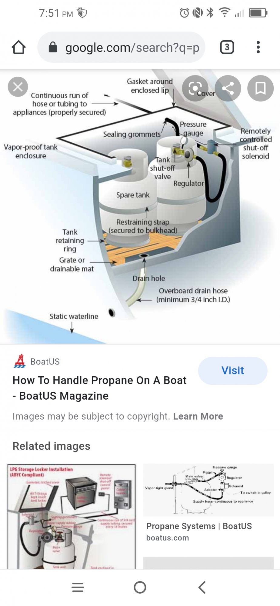

So they installed a propane locker which was the way the go. It does have a small 1/4 in hole in the locker that I will seal tomorrow.. Then they did install a 3/4 drain like like they were supposed to however here is where they messed up.. #1 hose is to long, #2 the thru hull fitting is at a 35° angle facing upwards which then filled with water from waves and basically caused a (p-trap) like we do for sinks which held water. All I need to do is put the thru hull fitting on the side of the boat and not the swim deck which will then be facing downwards so that no water will get trapped.. like in the picture attached
