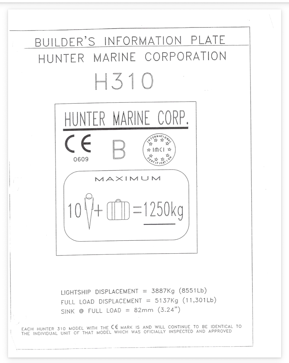

Our main question was if the boat has an RCD Category - we are planning to coastal sail around UK and EU waters and so for our insurance we're needing a Category B, but worried it might be a C (or have no category at all)
The nearest I could find was a 1999 model rated as B, but with this being 1997 we thought best to check

Welcome to the SBO Forum.
If you have the boat's HIN or manual, that would provide the definitive confirmation.
Looking online Hunter 310 — Information, Review, Specs
provides a statement.
According to the Hunter 310 Manual, the vessel was also built to CE Category B standards, signifying its intended use for offshore voyages where conditions up to Beaufort Force 8 and significant wave heights up to 4 meters may be encountered
From the Hunter 310 downloads on the SBO website, there are copies of manuals. This information was found here.
I suspect you could confirm the boat data with an insurance office. They would have tables identifying boats and the certifications the company recognizes.
You have some interesting waters to sail.

Many thanks John and really appreciated. There's a real treasure trove of info there - very helpful thanks!
