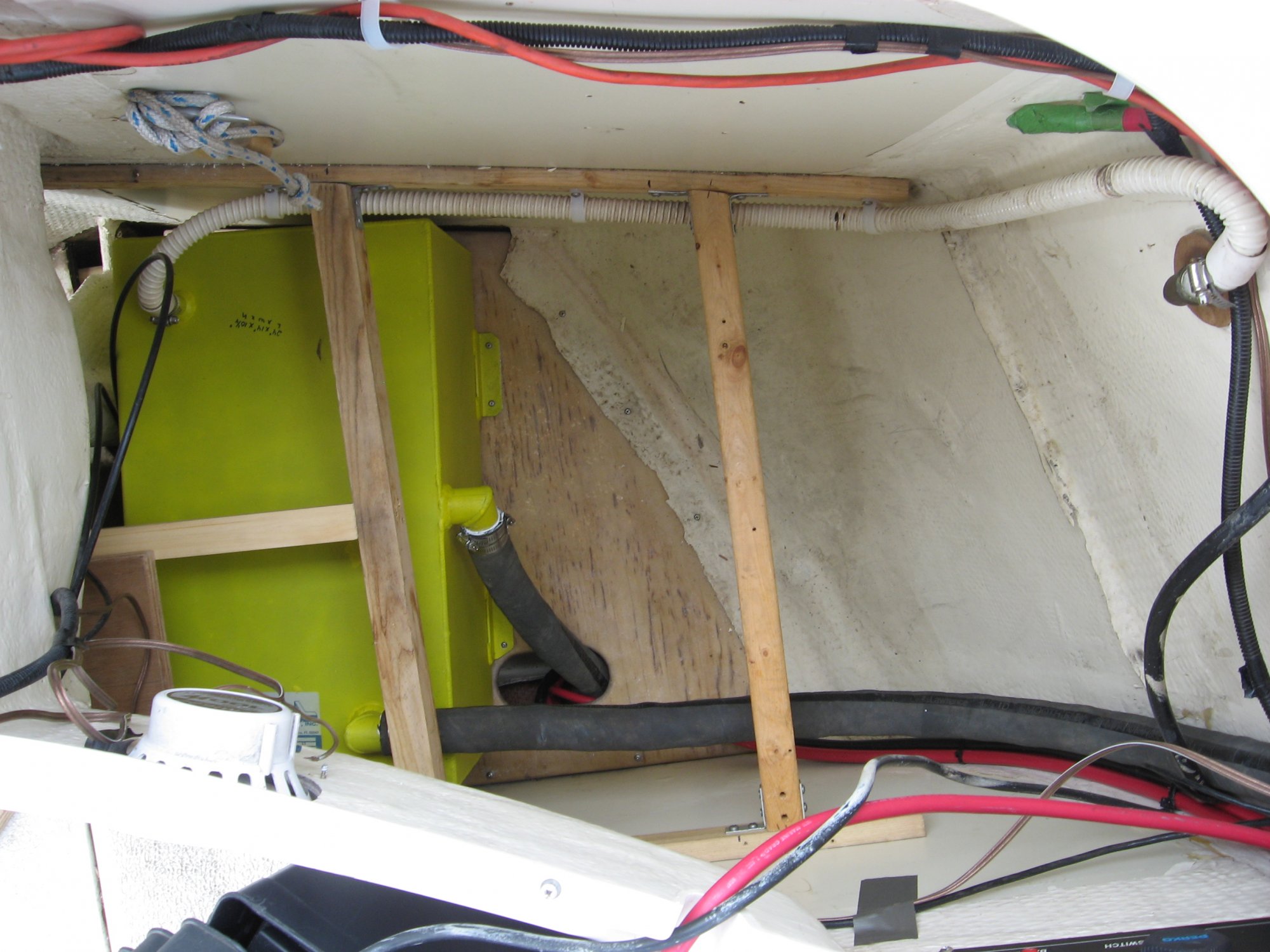

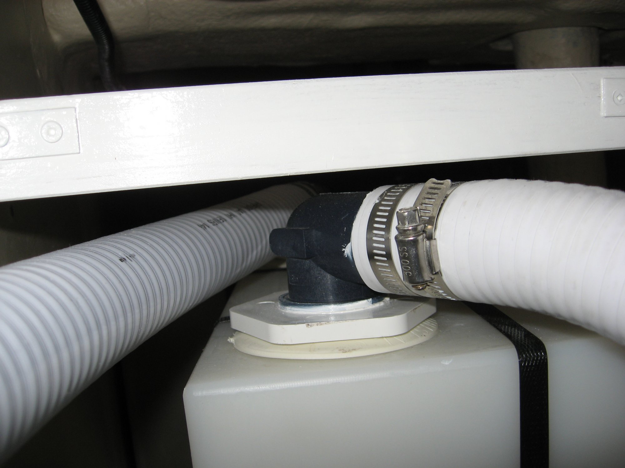

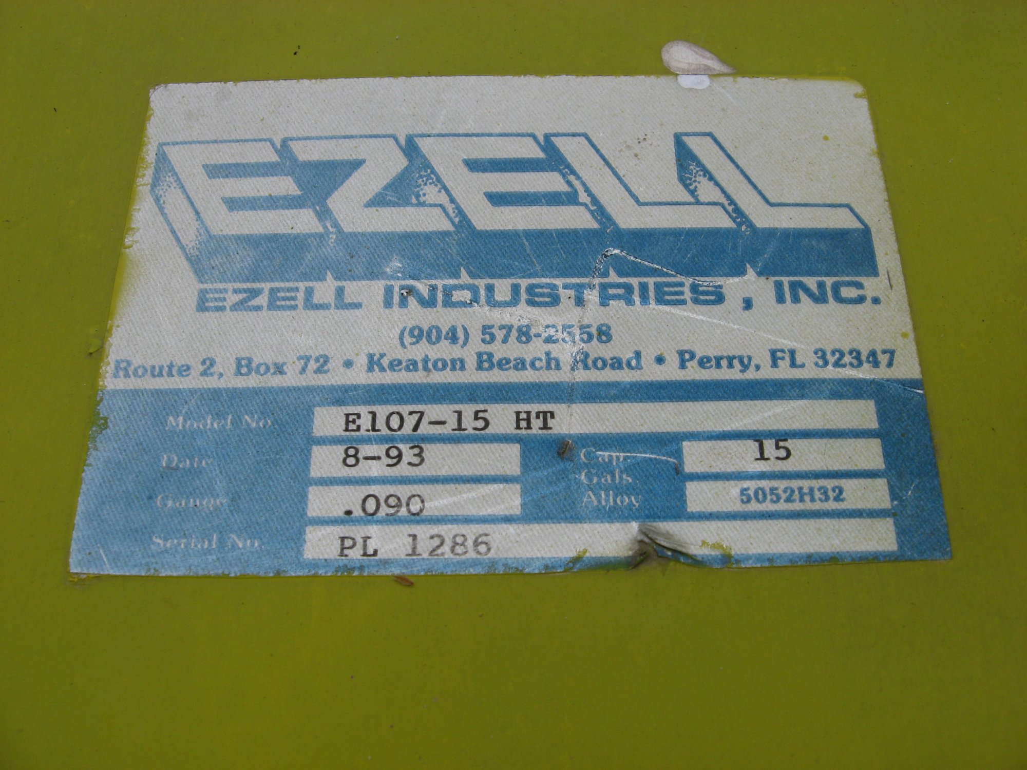

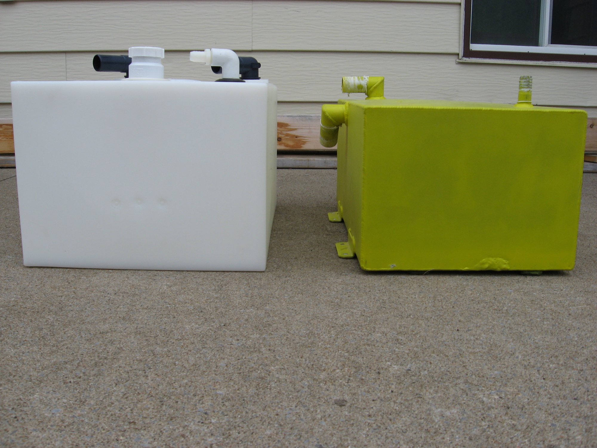

Hunter 30 Trois-Rivieres

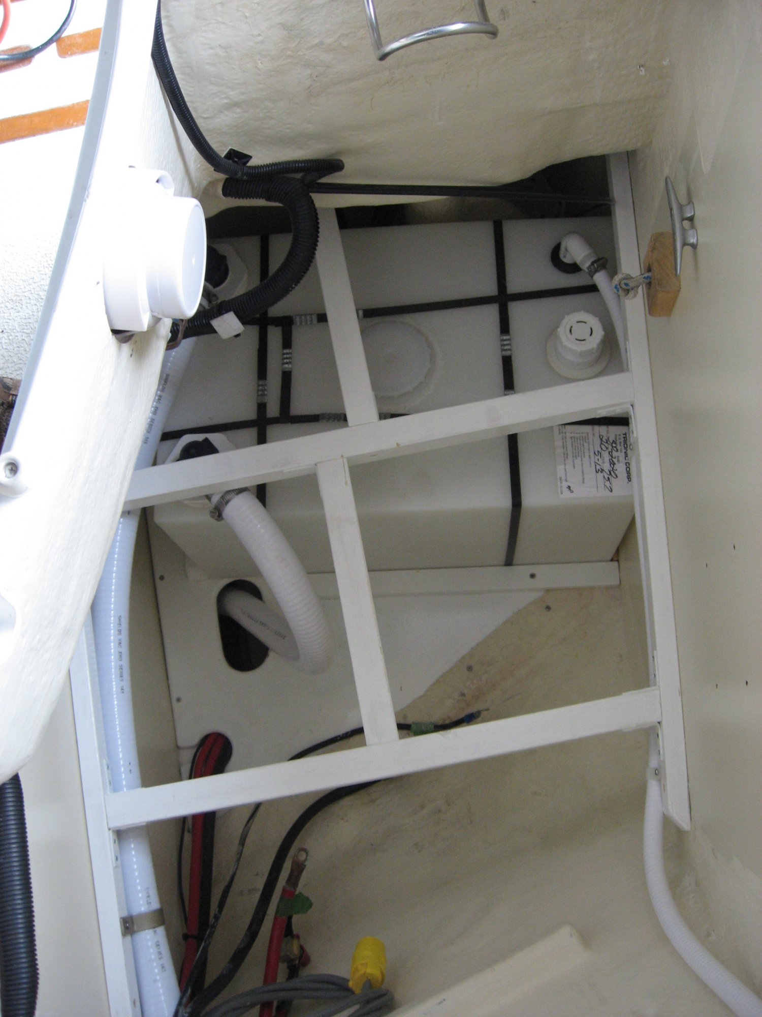

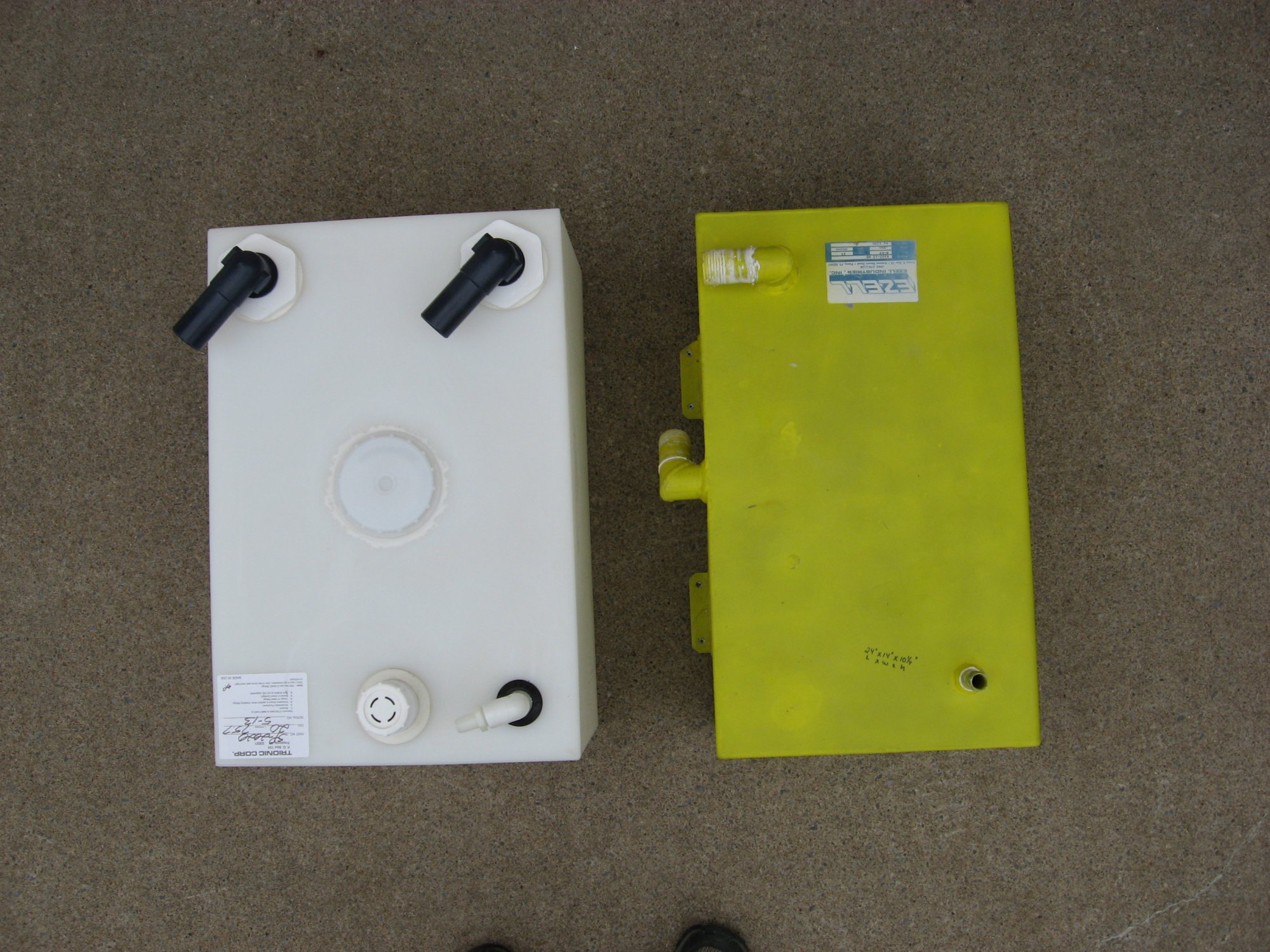

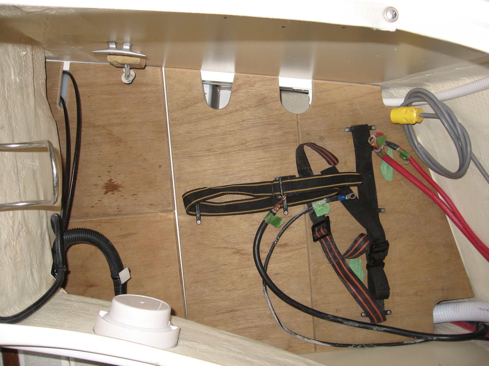

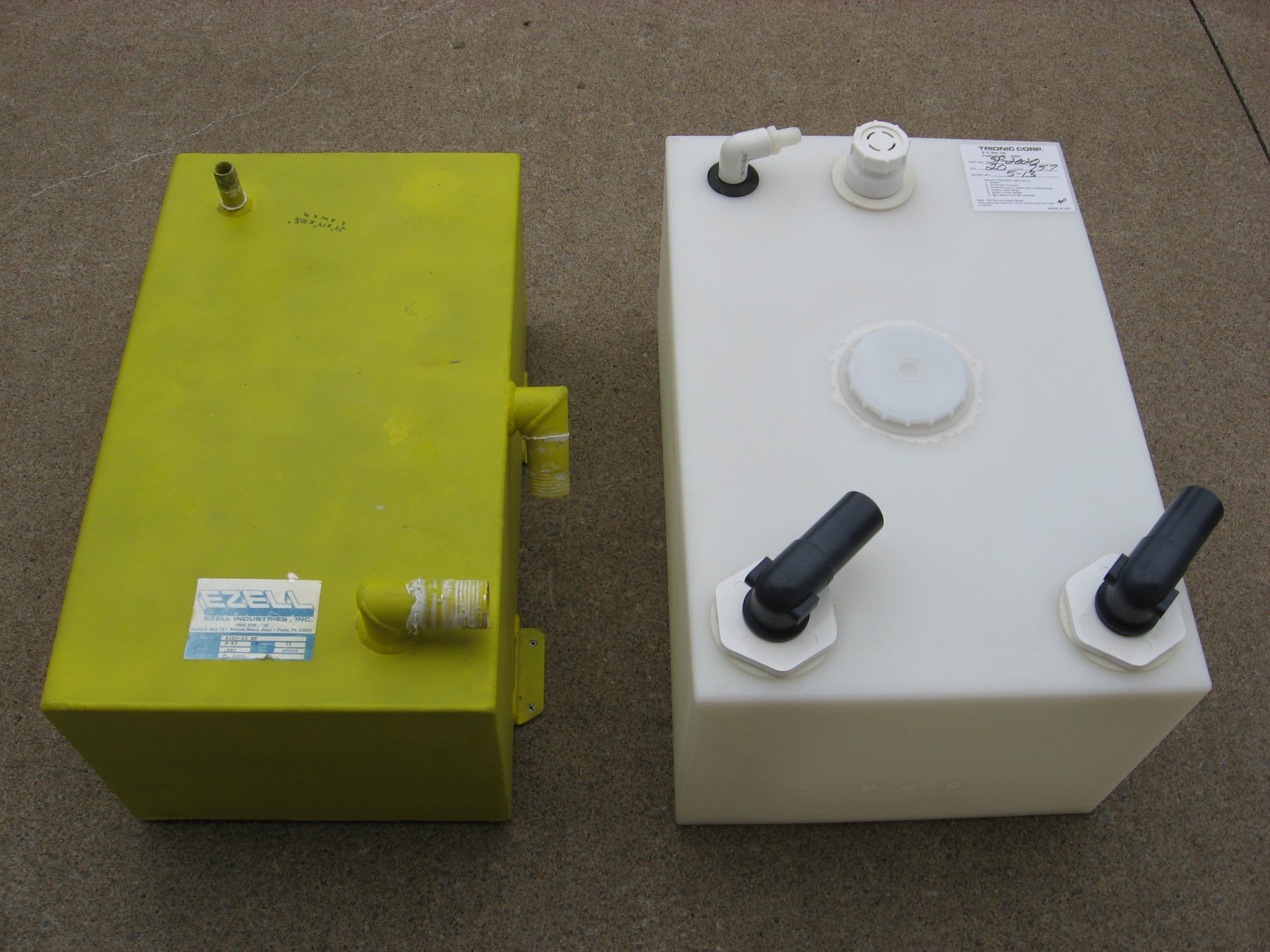

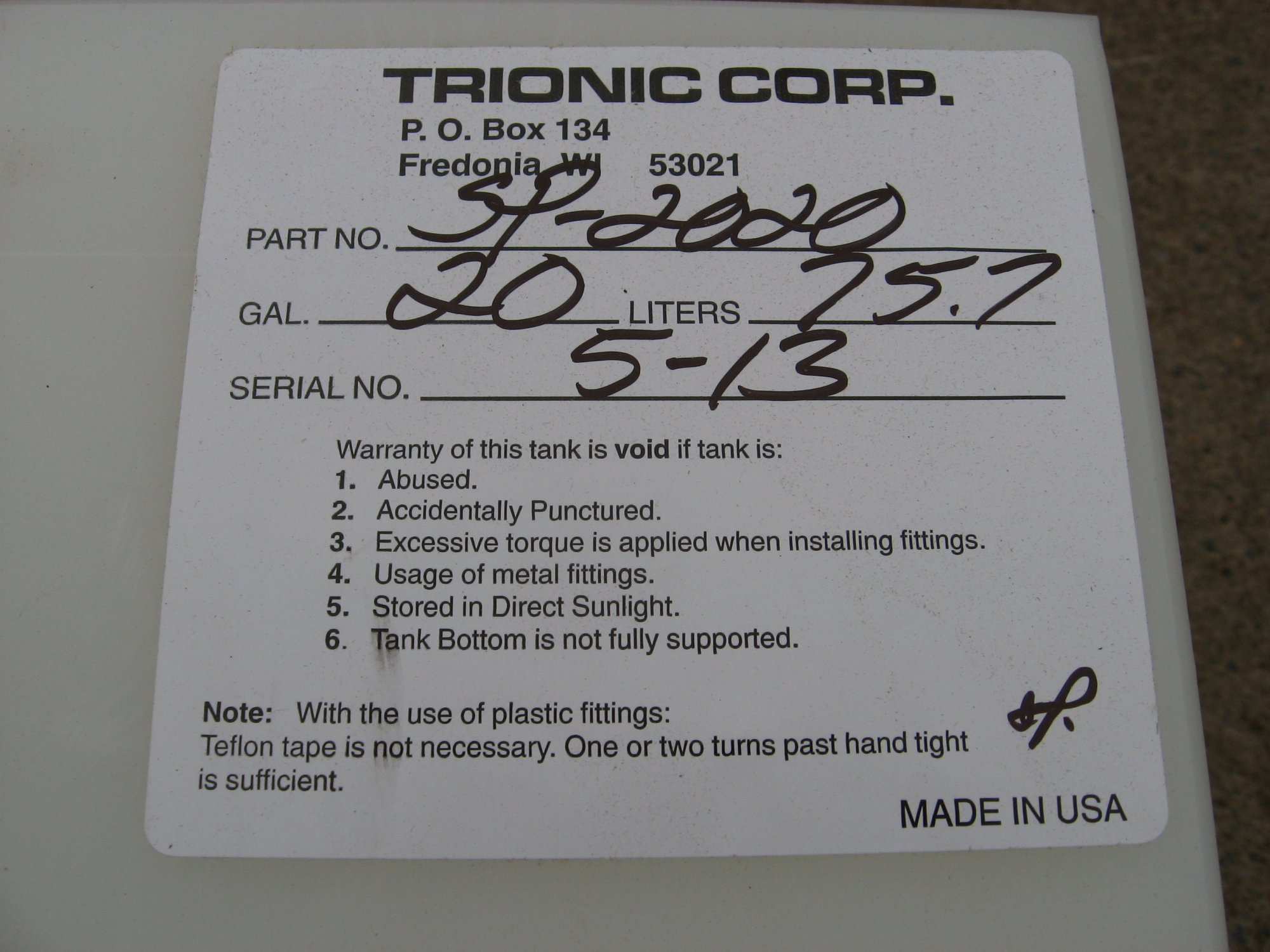

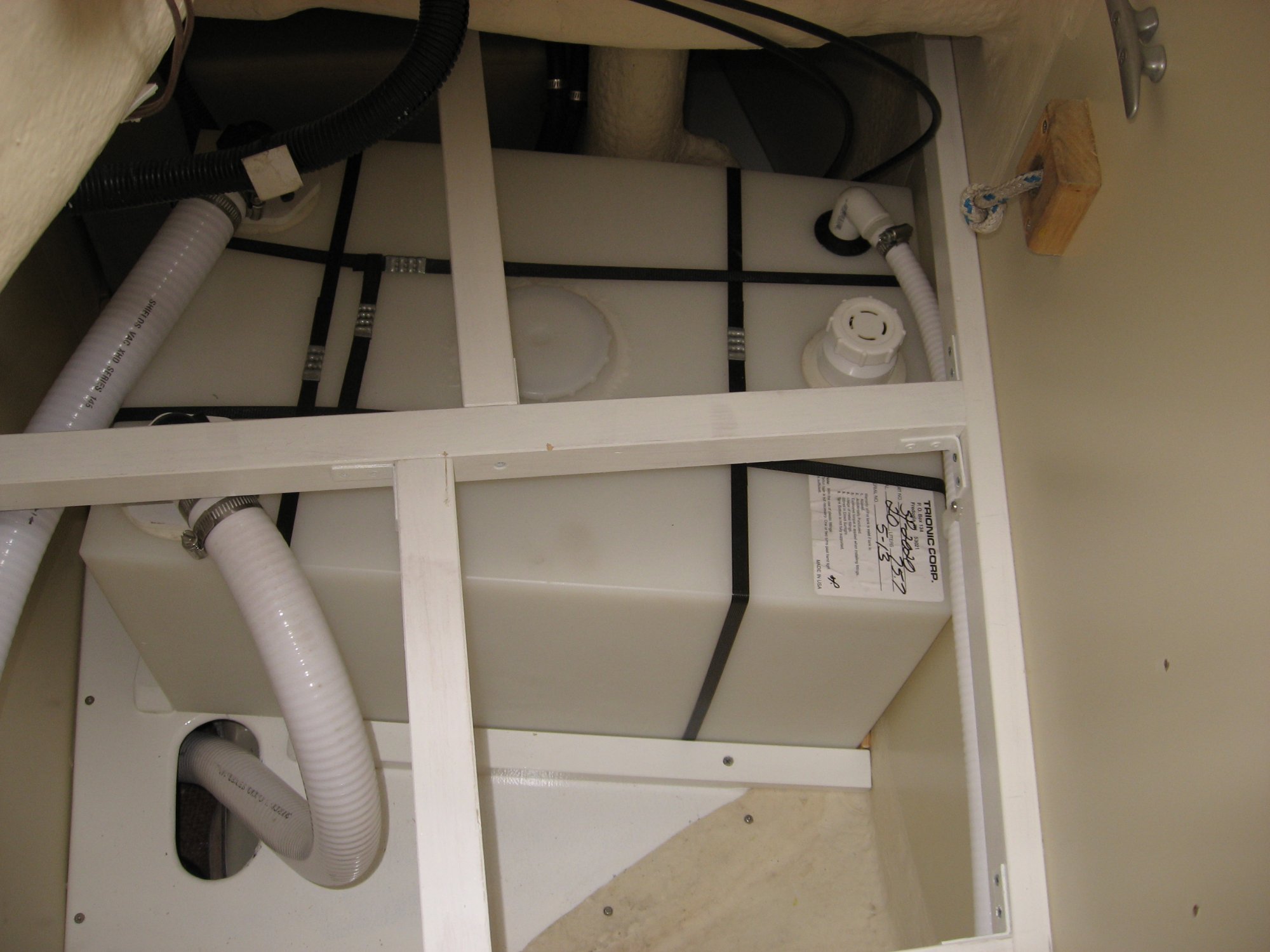

In my HUNTER 30T 1994, I change the original aluminium 15 gallons for a plastic 20 gallons.
It's a TRIONIC Corp, Model: SP-2020.
There is an article about that on this site: Home/Owner resources/Hunter model information center/Hunter 30 88-94/Owner mods.
I remorve the wood frame and replace it by the top to avoid cutting the bulkhead.
