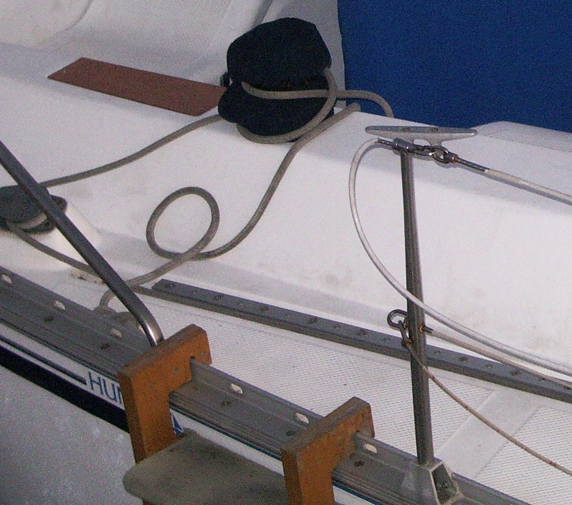

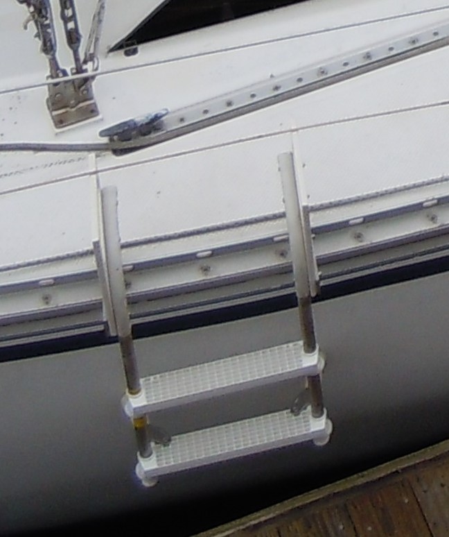

This won't work for everyone or every situation but might give you some ideas

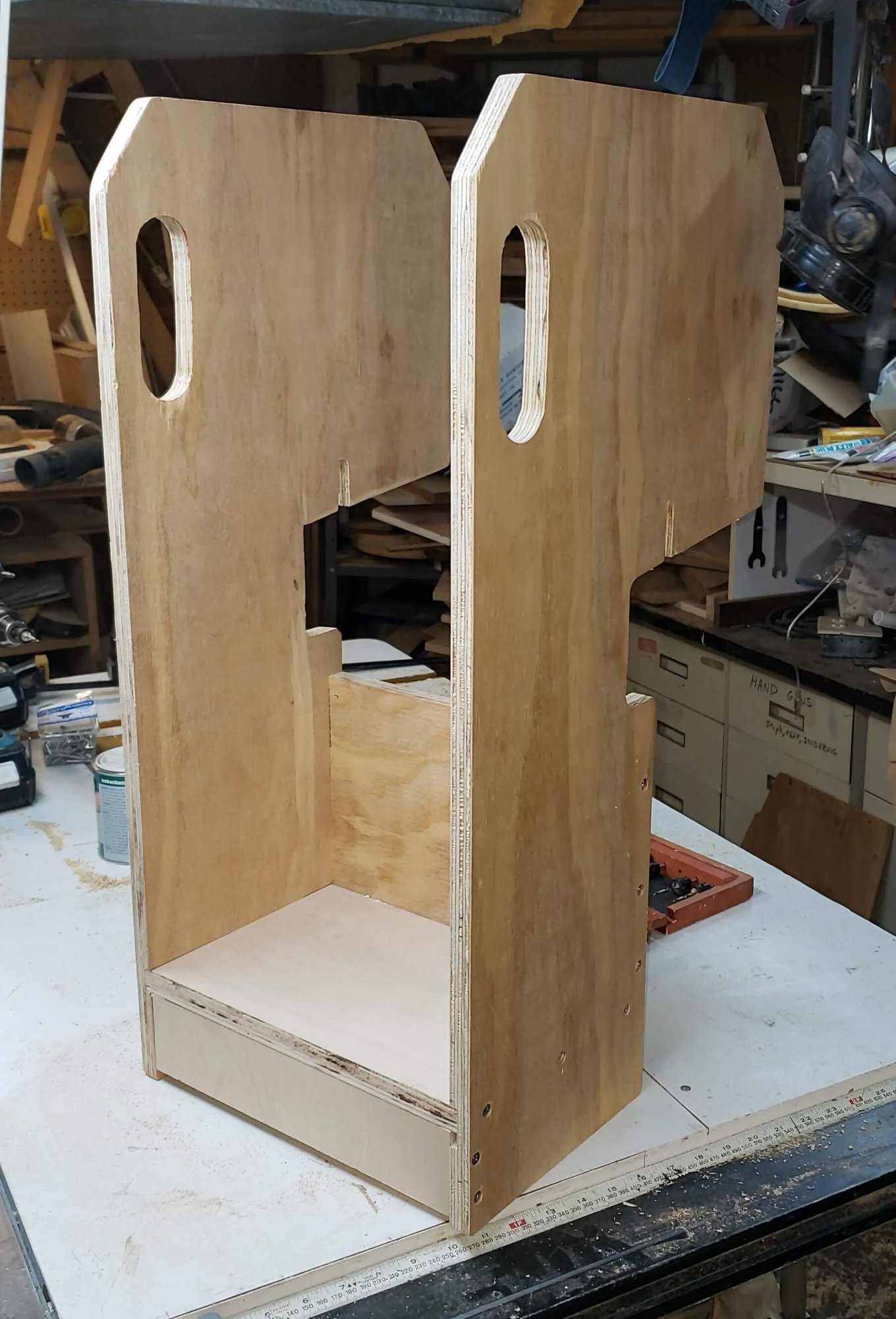

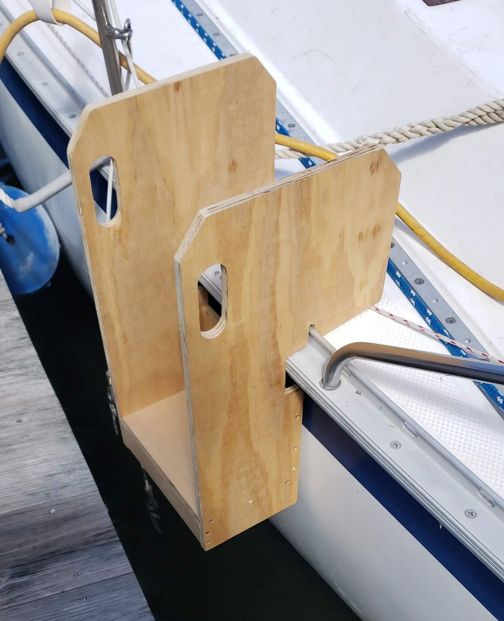

built this out of marine plywood, but have to keep it inside until needed.
Very nice. I had a couple of versions built similarly. I can't seem to find any really good pictures of the steps. The first was marine plywood covered with carpet which lasted many years. The second was a modification of an aluminum dinghy boarding ladder with some Starboard sides and aluminum plate that we could fold flat making it easier to transport on the boat with out taking up so much room. It sure was nice to be able to hook them anywhere along the aluminum toerail. We used them to get on and off at the dock as well as board the dinghy in the water.

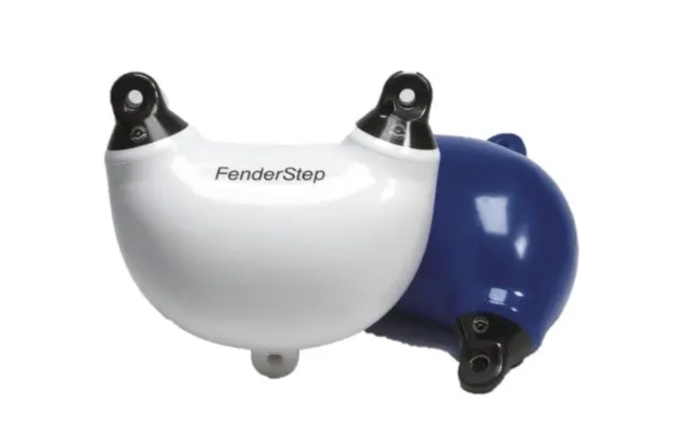

We use one of these, which also comes in a 2 step version for higher freeboard. I just looked up he price, it's gone up! :)
