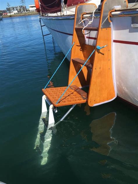

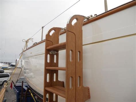

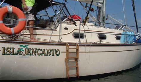

I have been looking at ladders.
Finding ways to secure the ladder and get it to project from the side of the boat is relevant to making boarding easier and safer.
I cannot find the image right now, but I saw a New Zealand boat owner who had built a ladder that folds lengthwise and rests along the stanchions when sailing. It folded down and could be deployed from the water. It intrigued me.
24,926
Perhaps a foldable platform to use as a seat or step off the transom would be a viable solution.

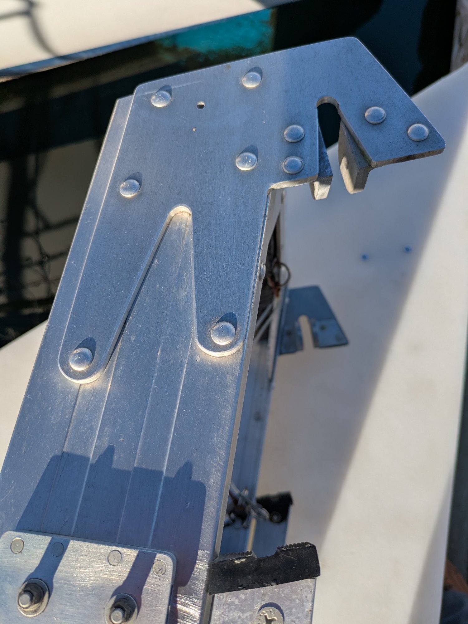

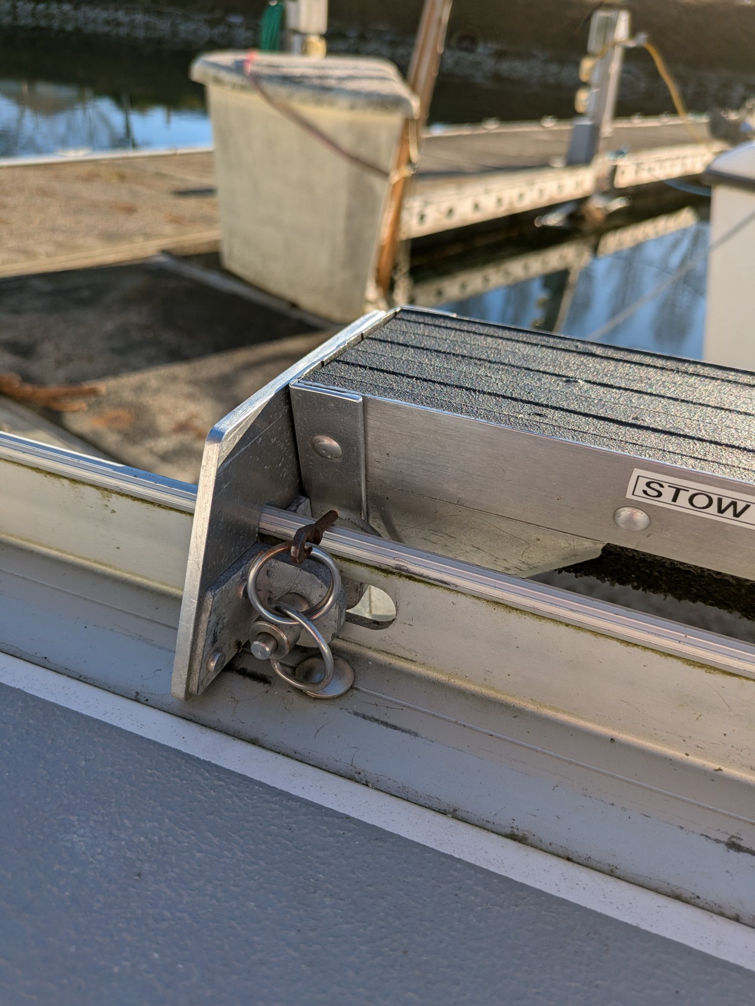

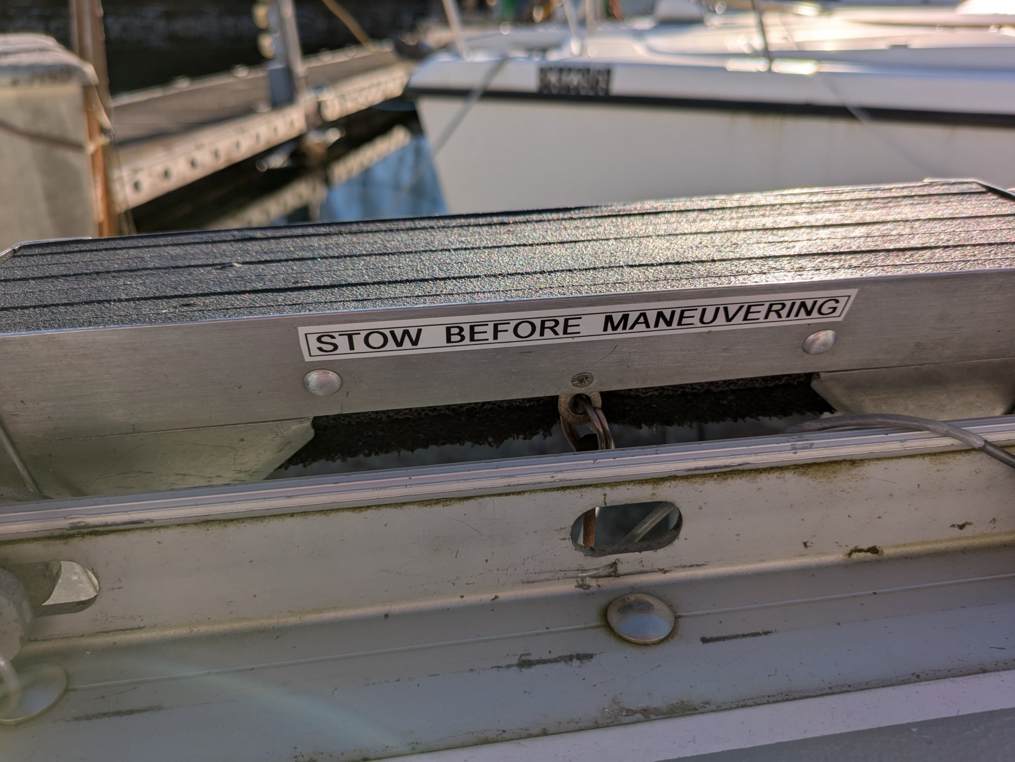

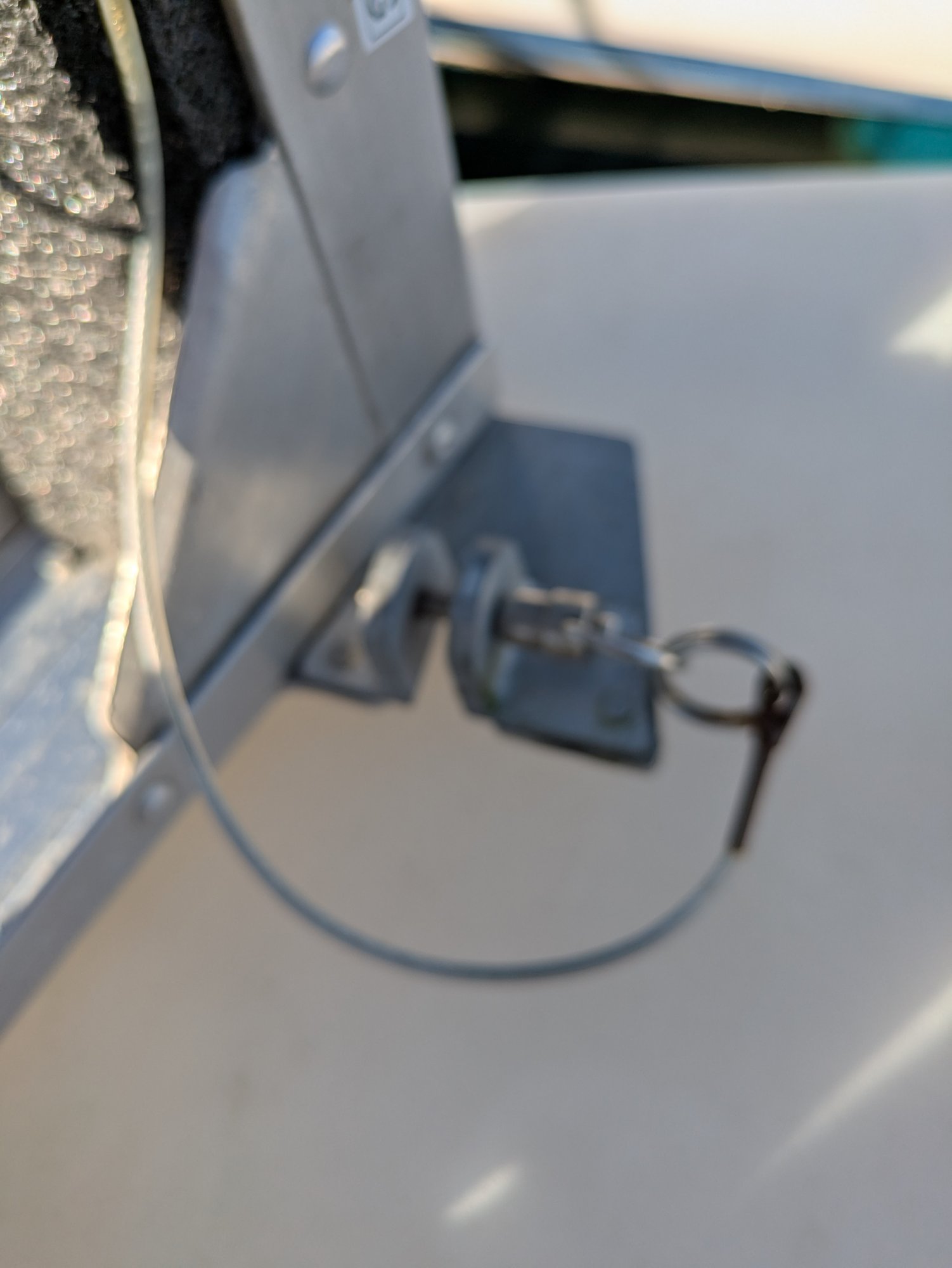

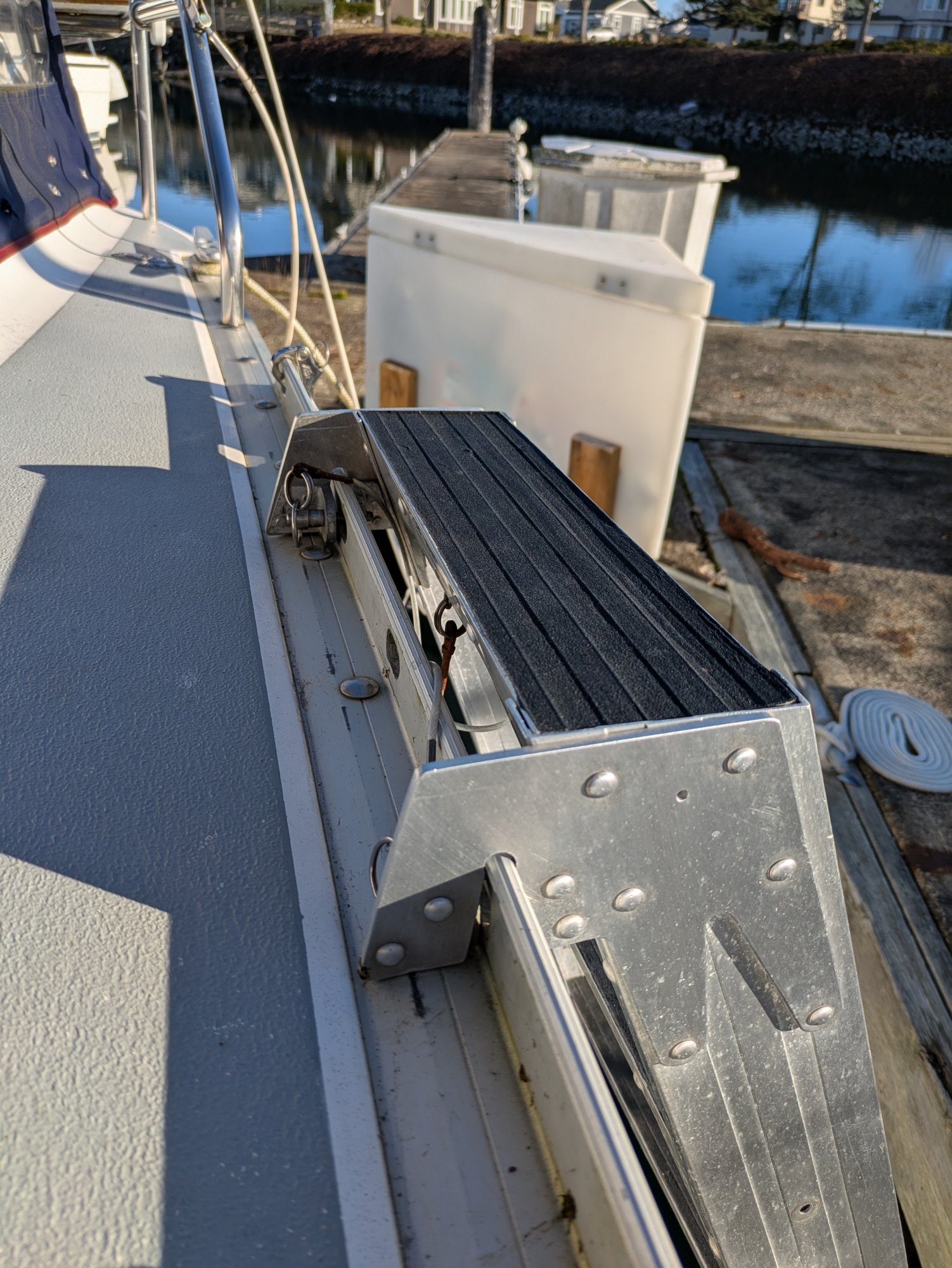

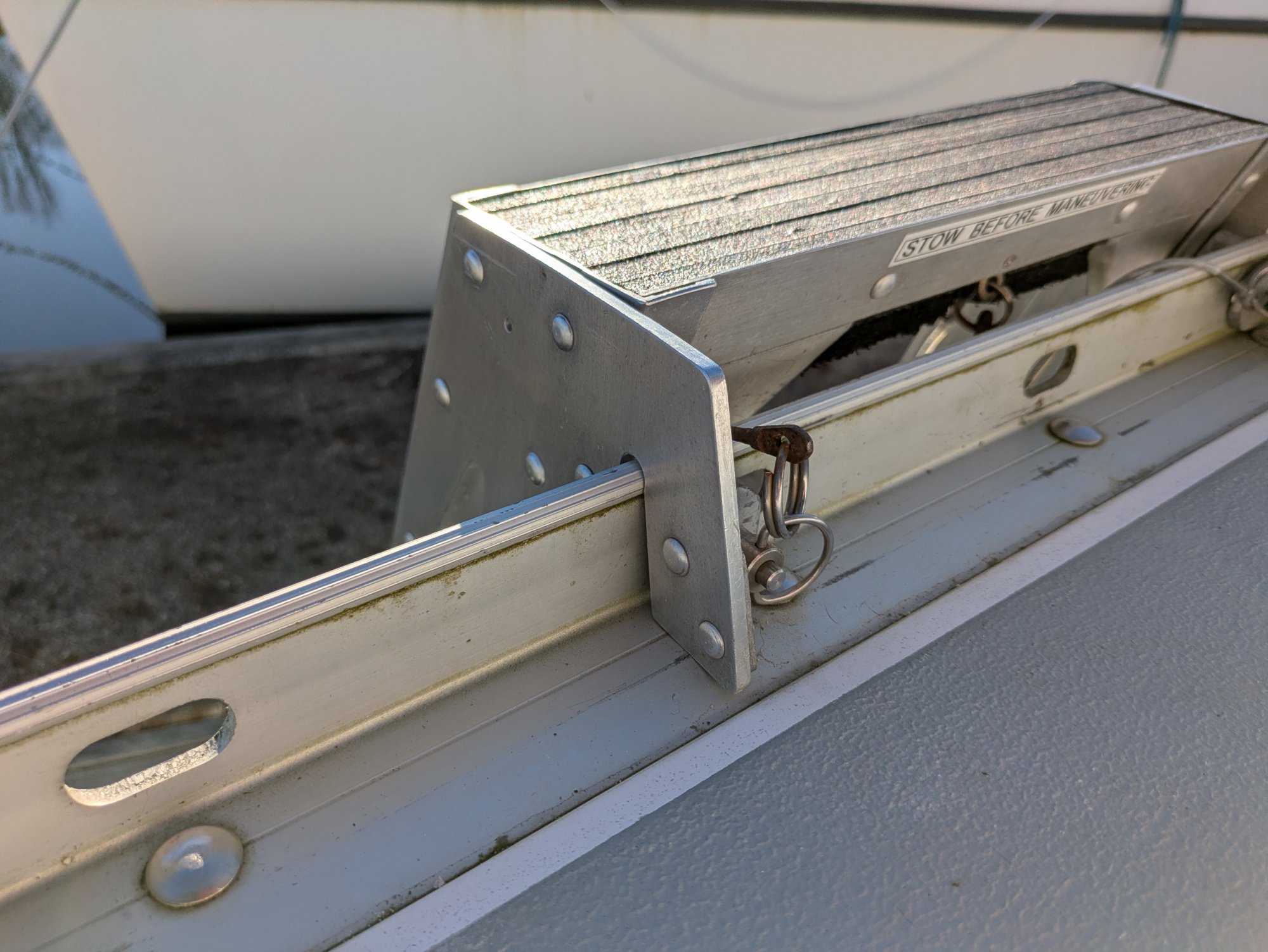

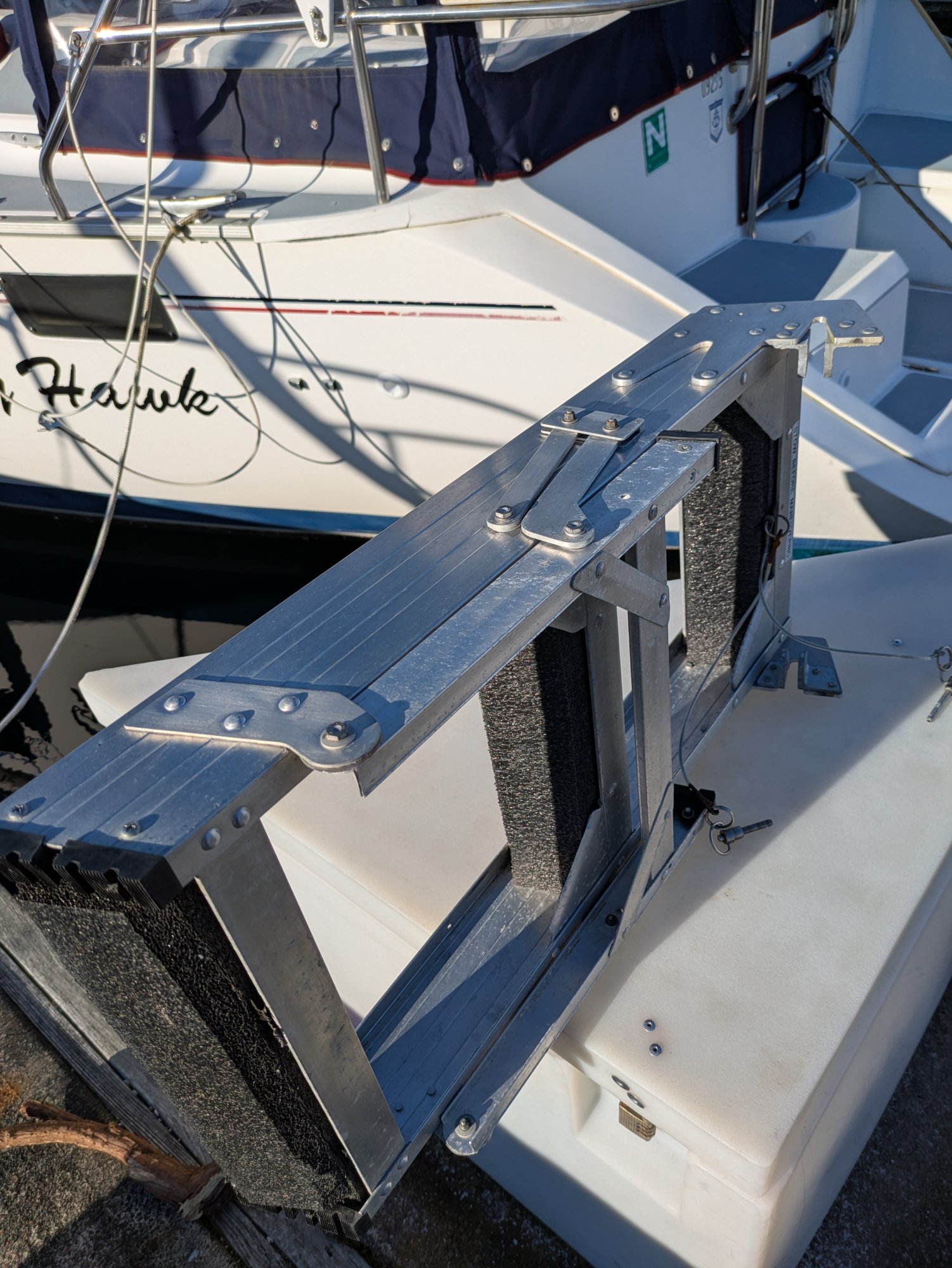

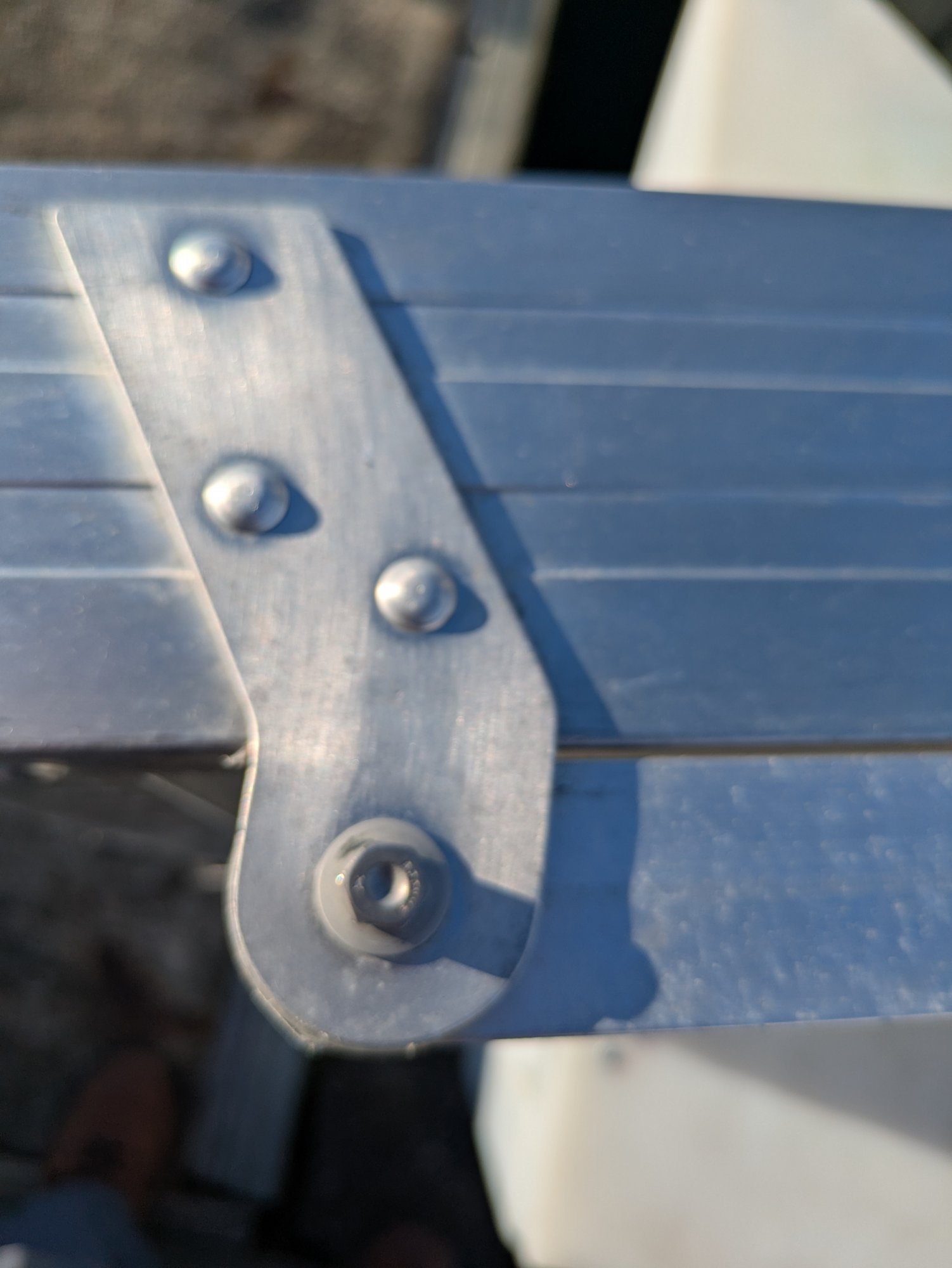

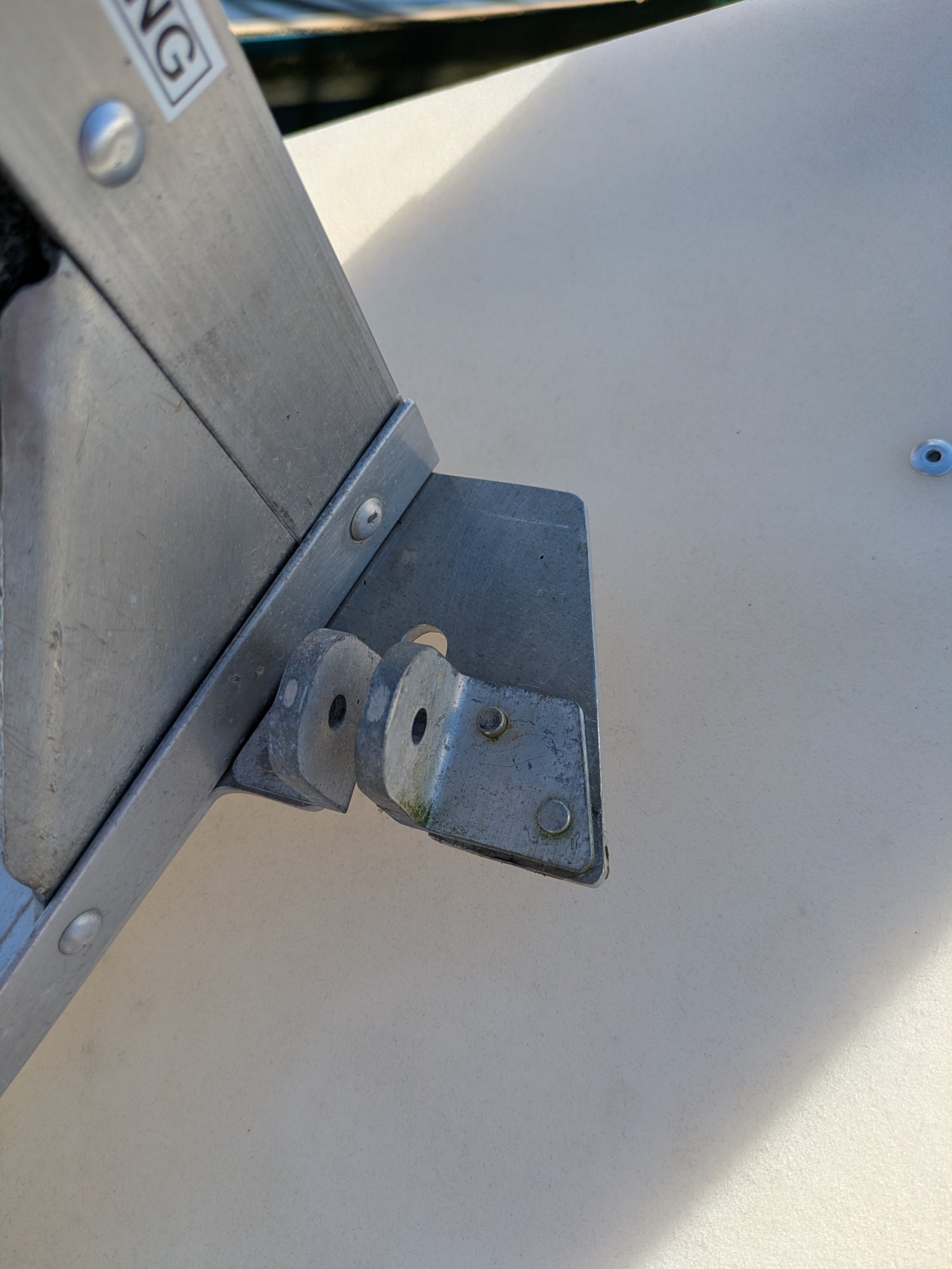

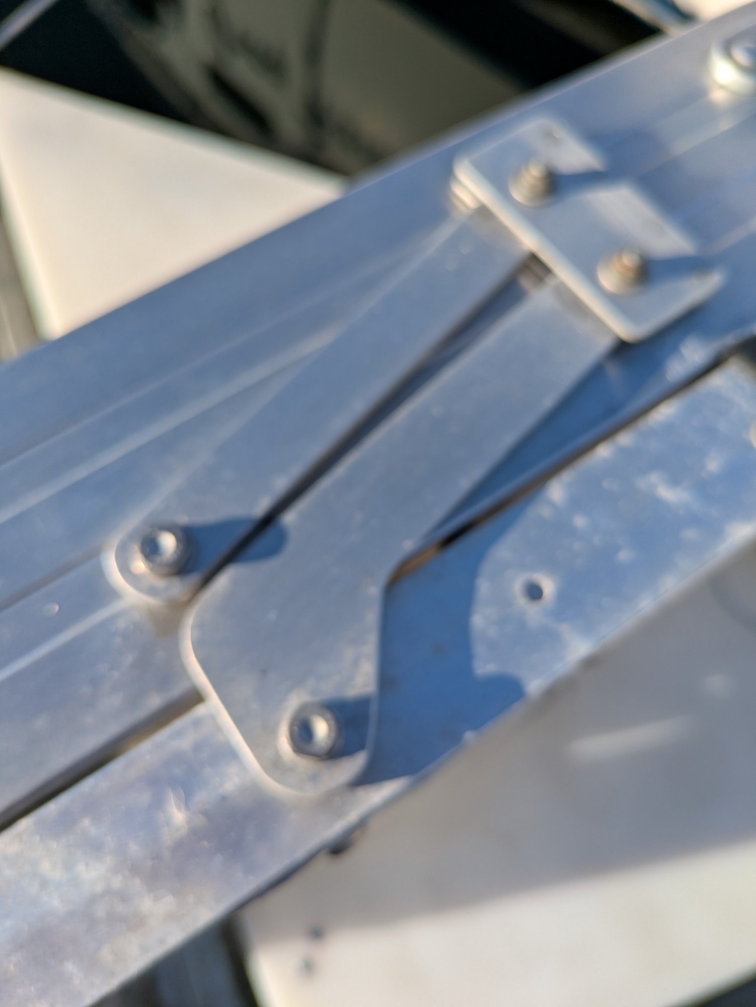

If your boat has an extruded stair rail, this might work for you...
I modified a cheap step ladder. It is secured to the rail with pip pins and has positive floatation glued under the steps. It folds flat and is stowed between the top life line and toe rail when not in use. Remember to stow it prior to any docking maneuvers! I'll try to get better pics for you.
