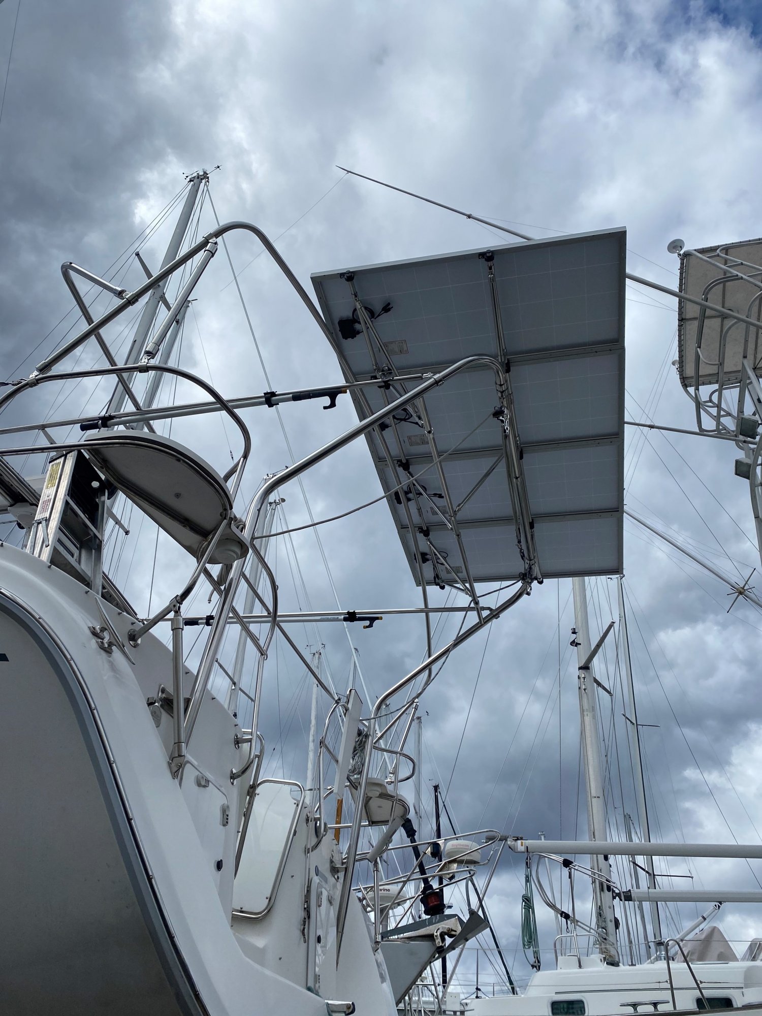

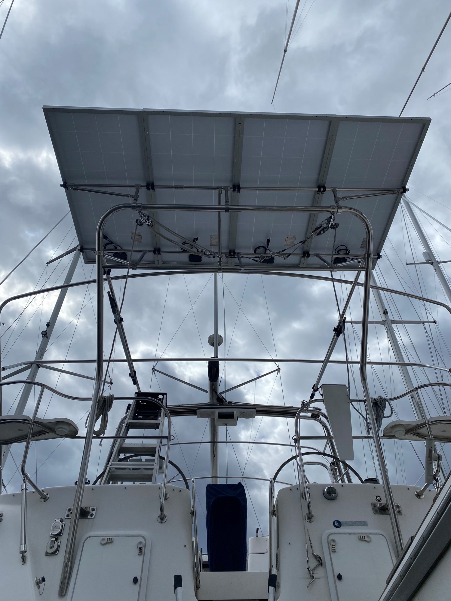

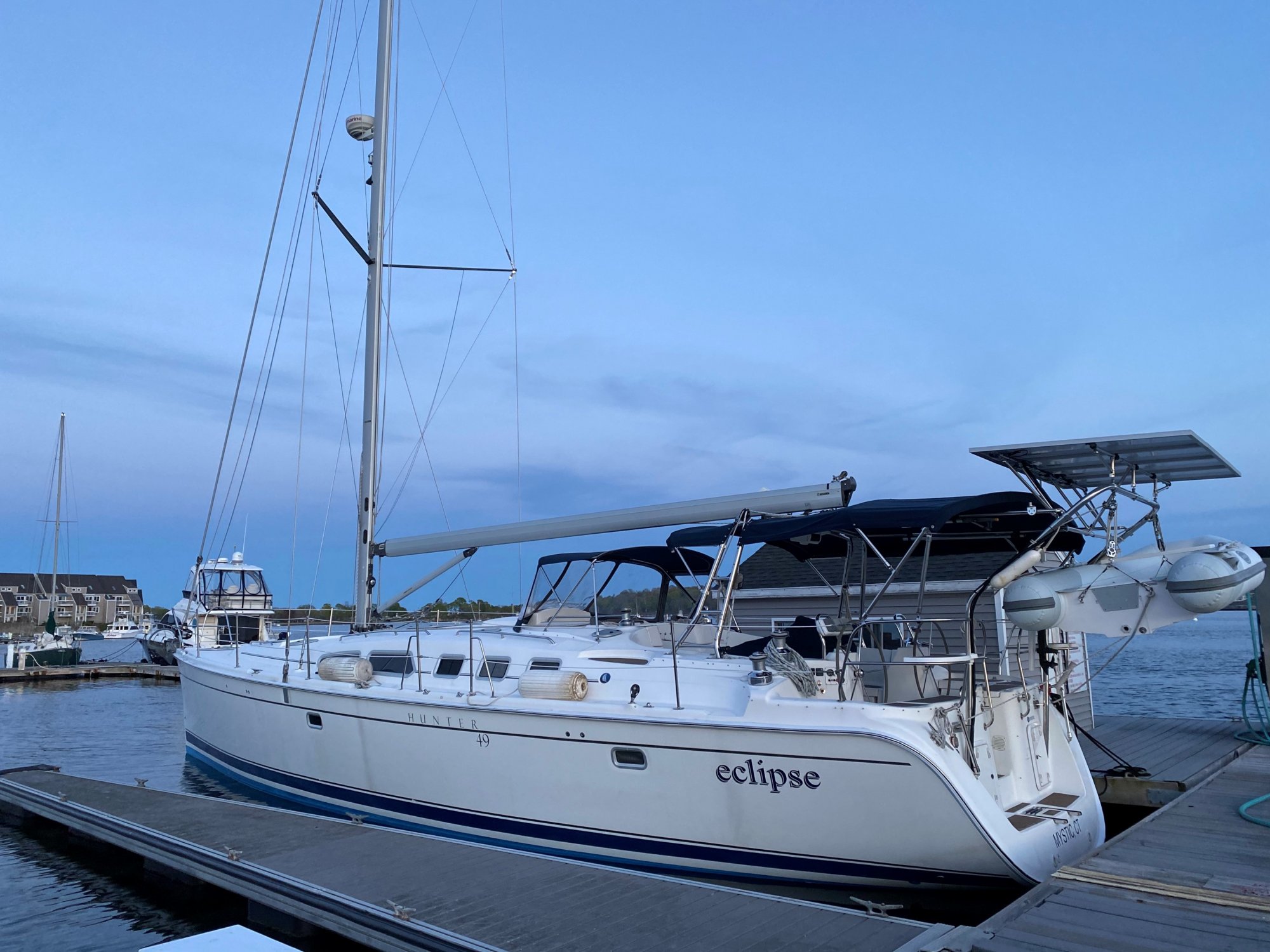

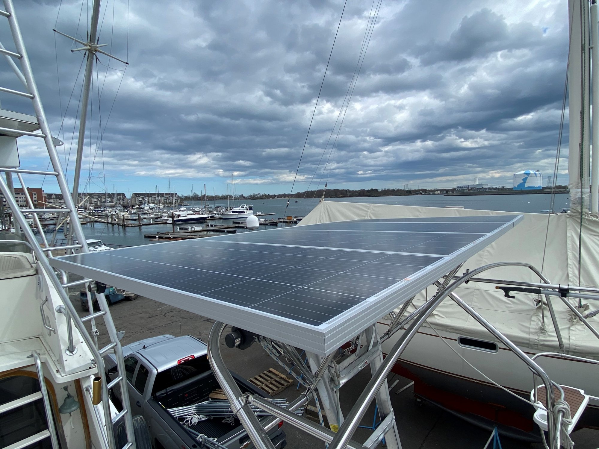

Here are some pics of my installation back in the spring of '21. I installed four 200 watt panels. All bimini connections are riveted with stainless rivets in place of the set screws (at least one per connection) which I did post assembly and after these pictures were taken. I mounted the panels as far back as I could to avoid shading and they remain outside of my winter cover. The wiring runs down the outside of the port davit support and then into stern through the bottom of the boat up to the nav table area. I installed my solar controller and a Blue Sea on/off switch below the nav table on the removable panel insert. From there it is a short run to the house bank. The install has been in place for over 4 years with no issues.

Very nice looking install. Thanks for the details.
I have the same rear davit arch and may do something very similar. My panels are a fair bit bigger, so I'm still considering a solid bimini from the Mainsail Traveler Arch aft.
