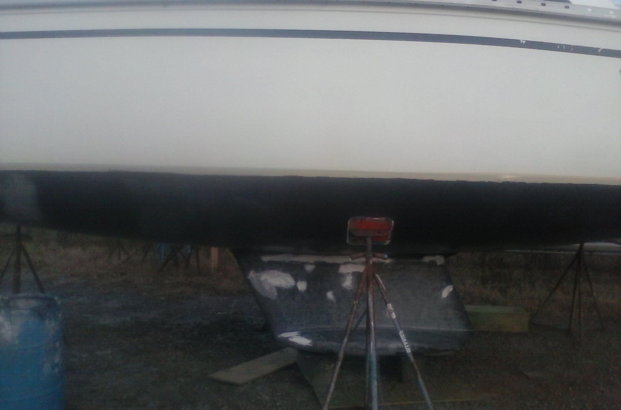

My keel is damaged. Wings are turned up and separated from hull. I need a new one. Can anyone please point me in the right direction? Need a rudder also.

Given the damage you are reporting, it sounds like you had a hard grounding or the boat was dropped. If either of those happened, it is quite likely that the damage extends far beyond the keel and rudder. If you haven't had a good surveyor look at the boat, you should and you should contact your insurance company. Damage can include extensive delimitation in the hull, especially in the area just behind the keel and extensive damage to the structural members that support the cabin sole and add rigidity to the hull.
My guess is replacing the keel and rudder will cost close to $20K. If there is additional structural damage $20K would be a very low estimate.

Thank you. Yes, keel was ok, but after being stuck for 5 days and dragging boat out over sandbars, damage was done. Insurance and surveyor are engaged. We hope there was no further damage although it took on water from keel area. I reached out to Mars metal so far. My guess is they'll total boat, so I will have to do all this.

Would you take this opportunity to change to deep keel? Wings are more pain than gain....from my experience. Hit submerged 3 times, bent both left and right Wings slightly upward. Now looks like mantra ray Wings :)

If the damage is only to those little winglets on the keel, I'd be inclined to take them right off. I doubt they had much to the boat's performance and the weight difference wouldn't be that much. This is assuming the rest of the boat has no significant damage.
A few years ago I contacted Mars Metals about changing a 6' draft keel to one of their shorter bulb keels. The cost was close to $10K about 10 years ago and that did not include transporting the boat to Toronto.

There are 3 Hunter 466s on Yacht World listing for ~$150K. Assuming you have the boat insured at agreed hull value for an amount close to that number, then the insurance company is not likely to total the boat. The cost of the repairs would need to be well north of 50% of the value. This repair will be expensive, but not close to a total. If the cost to repair is exceeds the companies threshold, then I wouldn't want to sail the boat unless all the repairs are made. The company will also want you to purchase the boat, they won't just give you the money and the boat.

Whether or not there is damage to the keel stub and fiberglass, the keel will need to be dropped and rebedded. That will take a couple of guys a couple days to do. Then there is any cosmetic damage. Painting the hull or gel coating will be $10K or more. Lots of expensive prep work.
Is there damage to the rudder tube? Will that need replacing or repair?
How did the boat get stuck? How fast was the boat traveling? Water entering near the keel, suggest some deeper damage to keel stub.

I’d be a little leery about sailing without the winglets. Not sure how much they weigh but being at the very bottom of the keel they must contribute greatly to your stability. The winglets I’m told also reduce the pitching motion as well. My 466 has the 6’6” fin keel and it is a bit tender. Not sure I would whack em off and rock on. My 2cents.

Perhaps you could look into removing the winglets and have a lead shoe added to either side near the bottom to restore the weight. I know people have done that to avoid increasing draft but improving stability.

The 466 bulb-wing keel has 9,500 lbs of lead ballast. The winglets look fairly small, even if they weigh a couple hundred pounds it would only reduce the ballast by about 2%. Would that make a difference? Yes. Would it be a difference that was noticeable? I'm not so certain.

The 466 deep fin is 9500. The shoal draft is 9680. 6’6” versus 5’6”. I just know mine is a bit tender and shallower lighter will not improve things.
