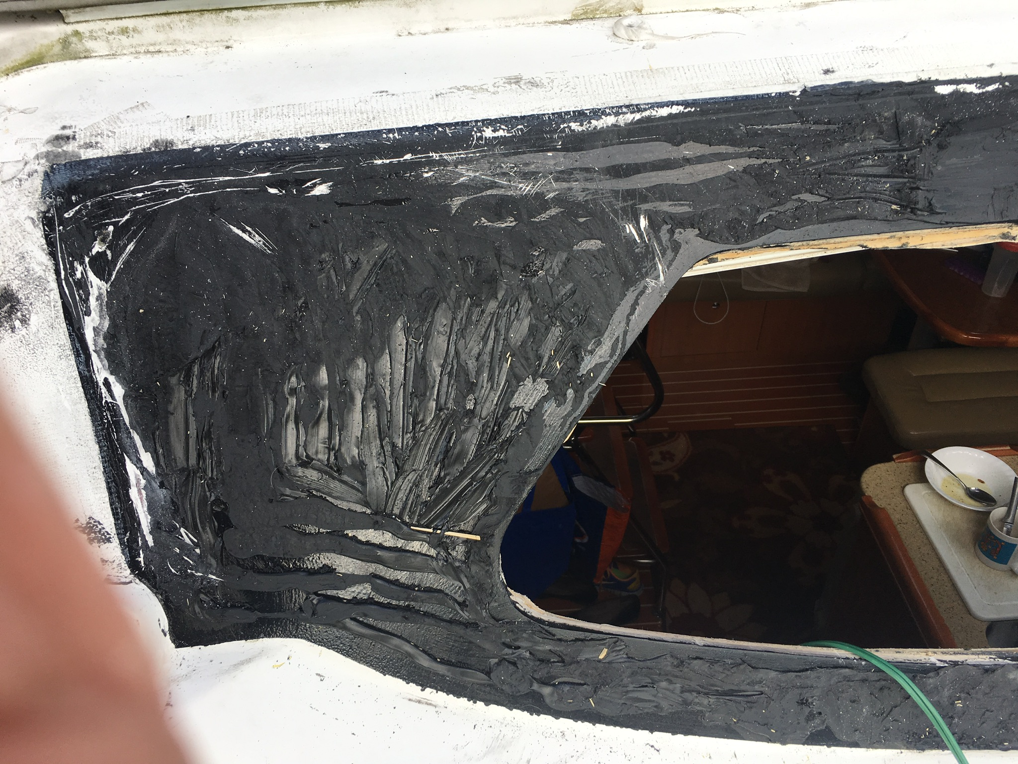

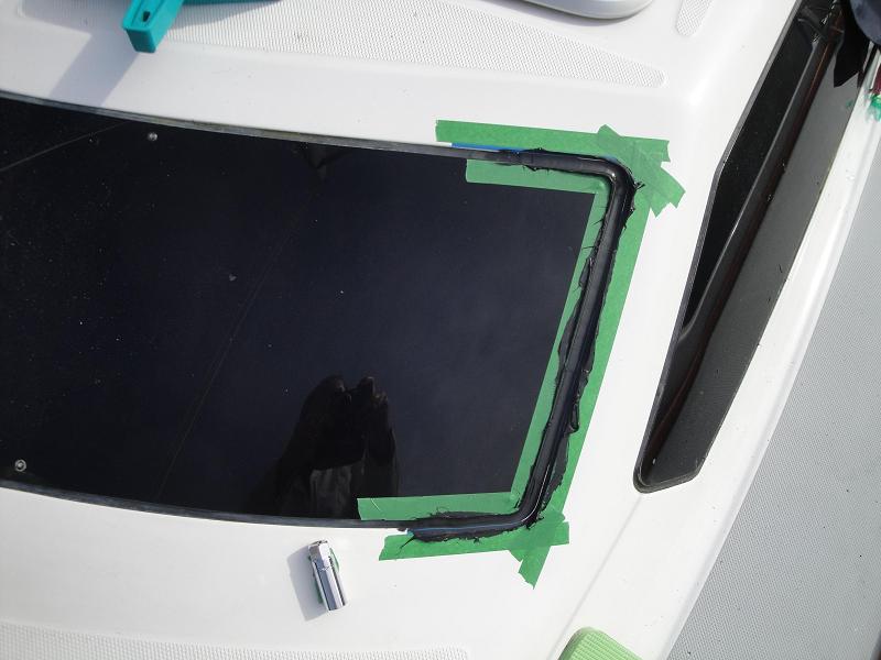

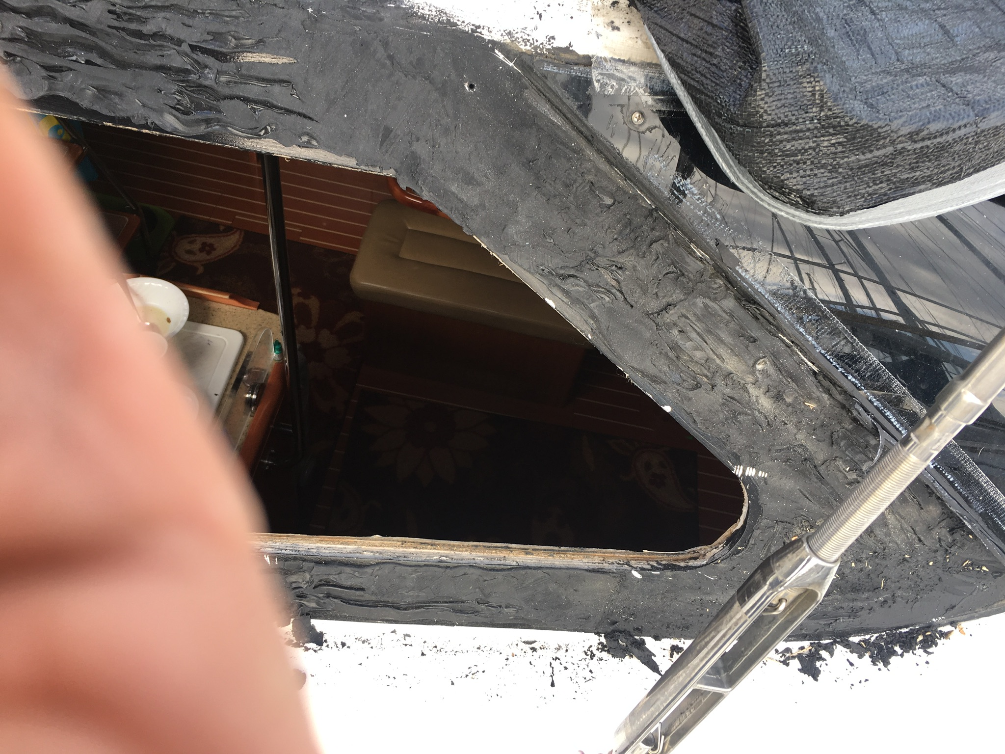

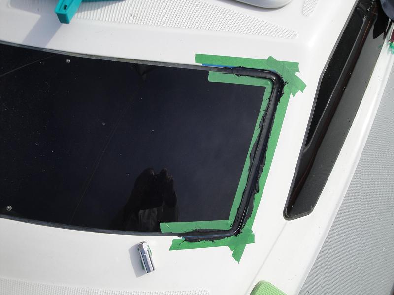

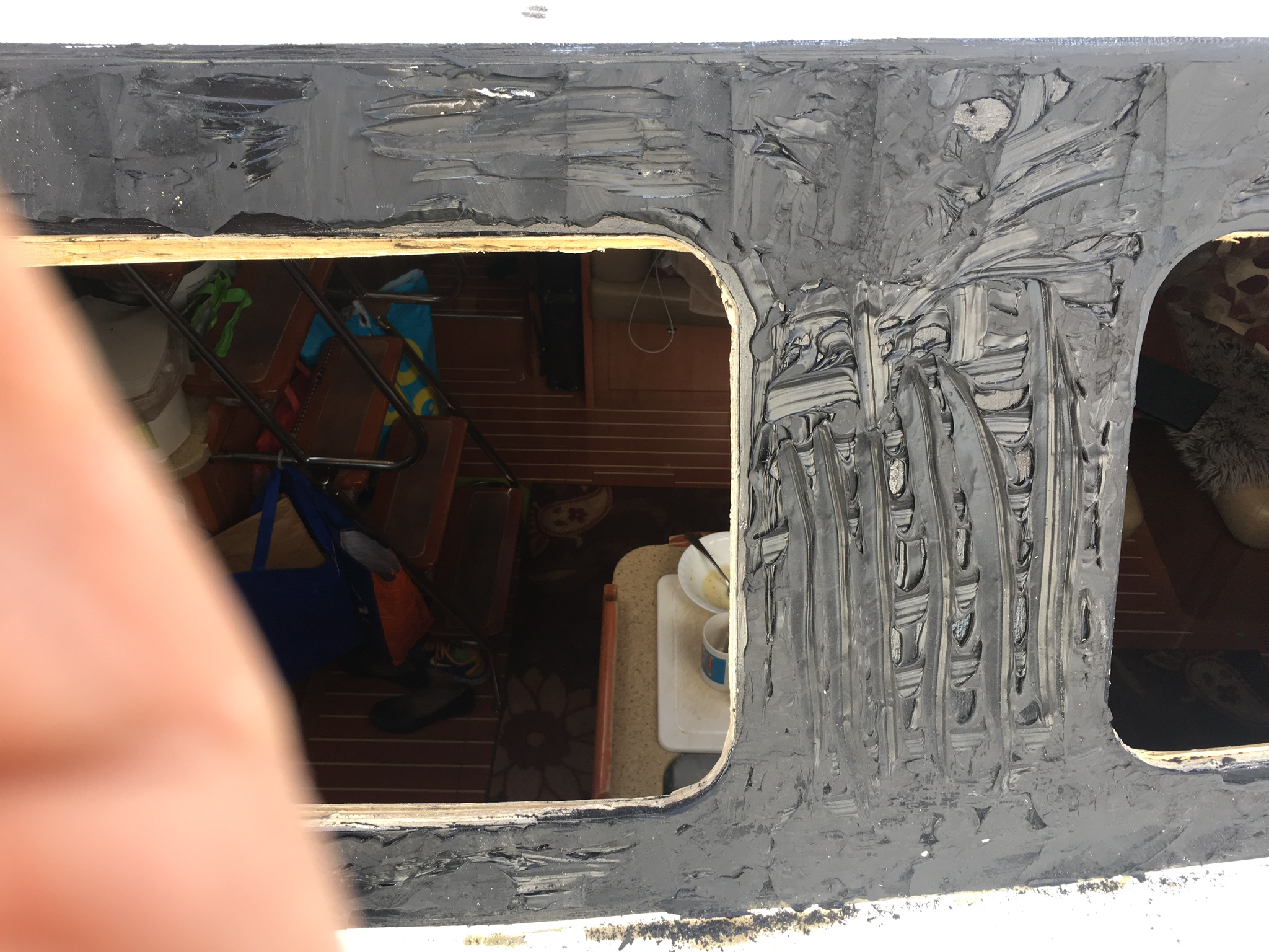

Time for an update.
Since I've posted this, the window has been taken out and in the process was broken. Attached are pictures off the calking that was applied and would like to know if this is normal. The "professionals" that installed the window as identified by the hunter dealer from Vancouver BC called this normal applied. And it still leaked. He will not take ownership of poor workmanship.
Your thoughts.

It's not the issue its the poor repair using unqualified as it seems "professionals" although I know 3 other 45 CC's with the same issue and it's on the starboard side
