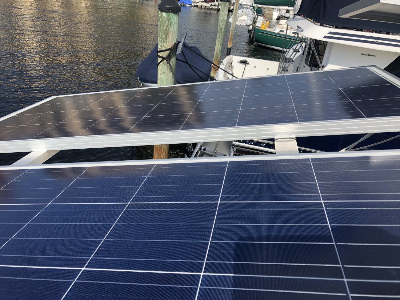

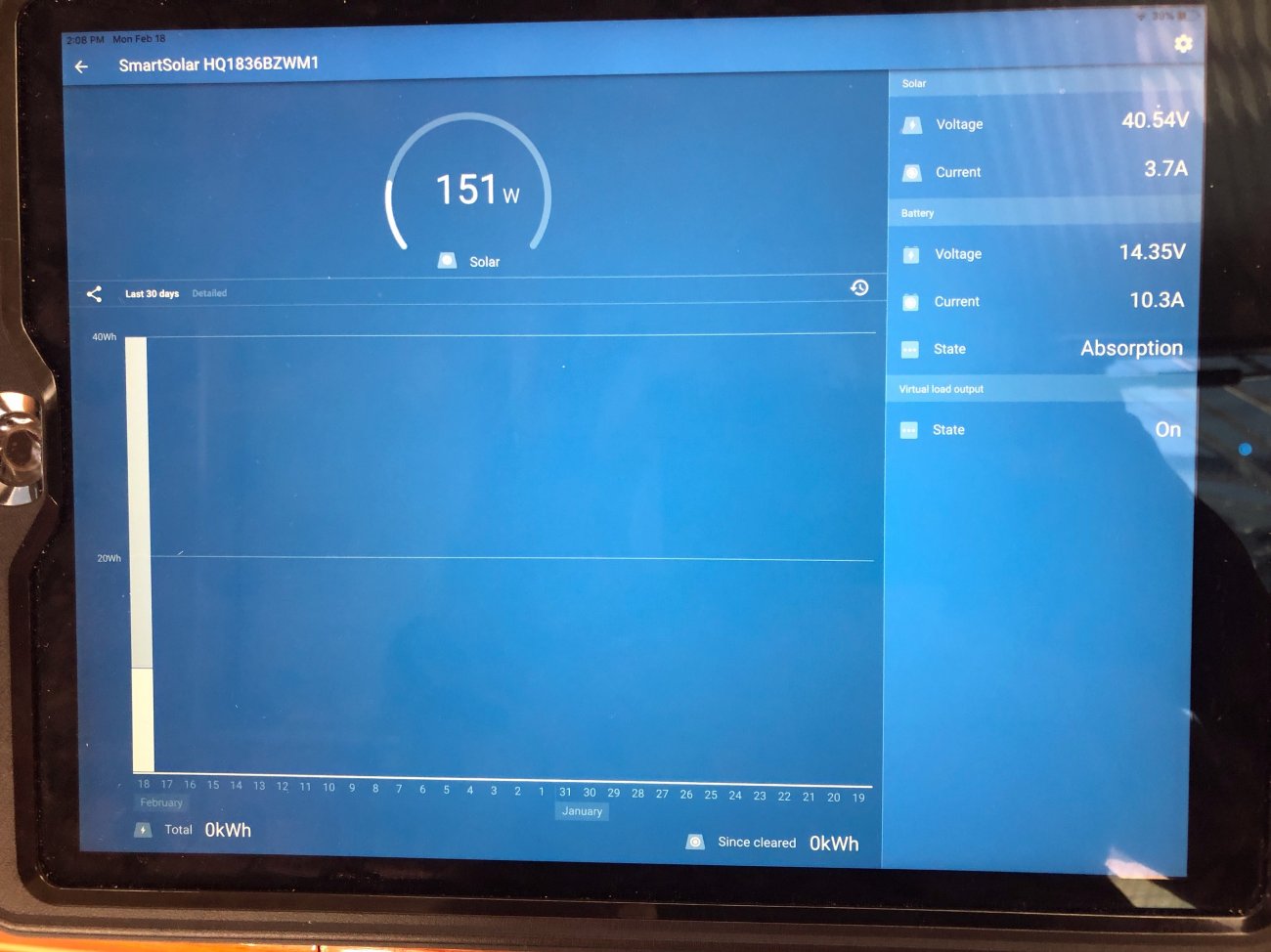

I now have four 160 watt Solarland panels, mounted above the Bimini and Kato davit. Also a Victron controller and battery monitor with Bluetooth. These are the photos:

Be interested how the panels are working. Can you run your fridge and freezer overnight off of the batteries? What type of battery bank? How long does it take to recharge the batteries? Nice installation!

So been testing them out and have to say they work great. Turned shore power off and ran the entertainment system and fridge and freezer and lights and inverter to charge phones and tablet. Had the bank down 125 Ah. Fully recovered the next day mid day estimated. Granted it was a sunny day. Next test is on a rainy day. Battery bank is 3 Lifeline 4D batteries so I get about 250 Ah. Panels are 310 watts each 20 volt. I have them running in parallel to a combiner box.
One thing I need to sort out is how to secure the spare wire under the panels. Thinking some caulking

Tucker, don't caulk them. If you ever have to remove the panels it will be a mess. I rolled mine up and tie wrapped them. Then tie wrapped to the structure. I think you can see that in the earlier pictures I sent you. BTW mine work great! The short winter days were a problem with fully recharging the batteries but we were at anchor for 3 days and never had to start the engine or generator to recharge. Very very happy with our panels!
