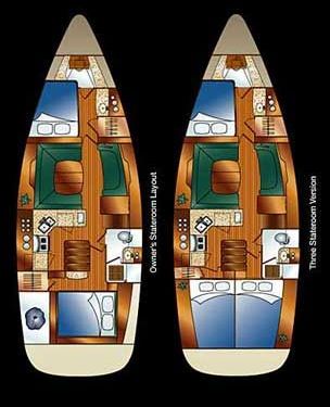

The newer GH 41 is beamier ( is that a word?) more forward and carries the beam further aft. The 410 ( left ) has more boat on the stern behind the aft cabin.
