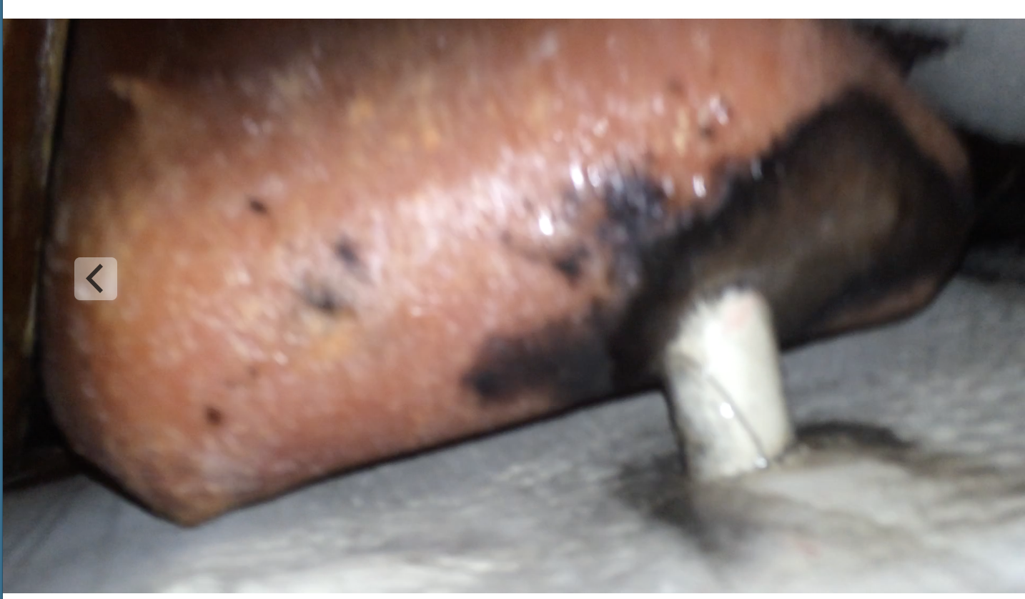

OK, since I promised to update when I discovered the source. It turns out that the anchor well has some corrosion. When it rains, any water in here slowly drips into the bulkhead below the cushions in the forward v-berth. I think I can fix it up from the inside of the anchor well. Attached is a screen shot from a video I took that shows the outside of the anchor well during a rain shower.
Thanks for all your suggestions!
We put her in the water yesterday and she sailed beautifully to her new berth.
