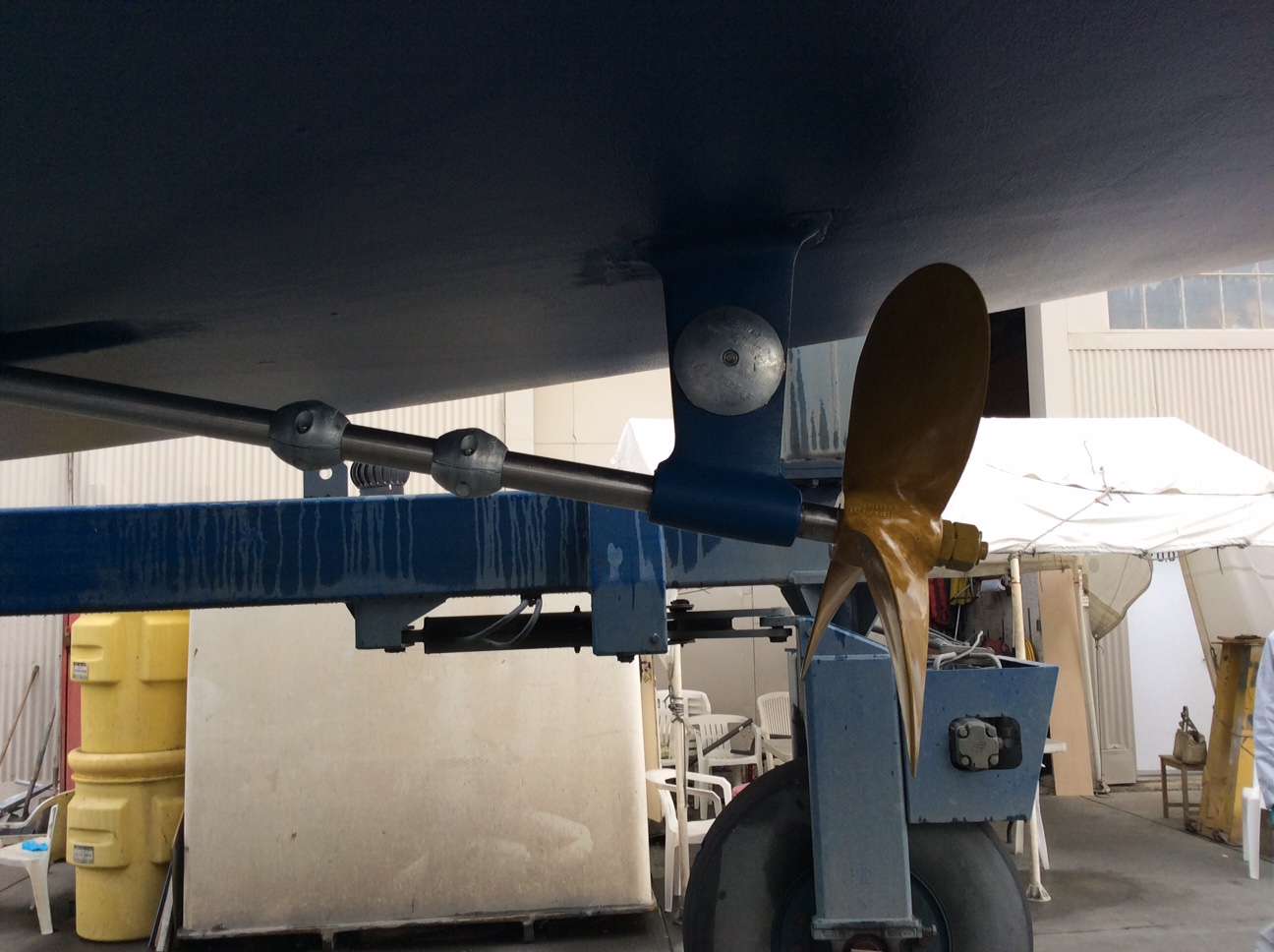

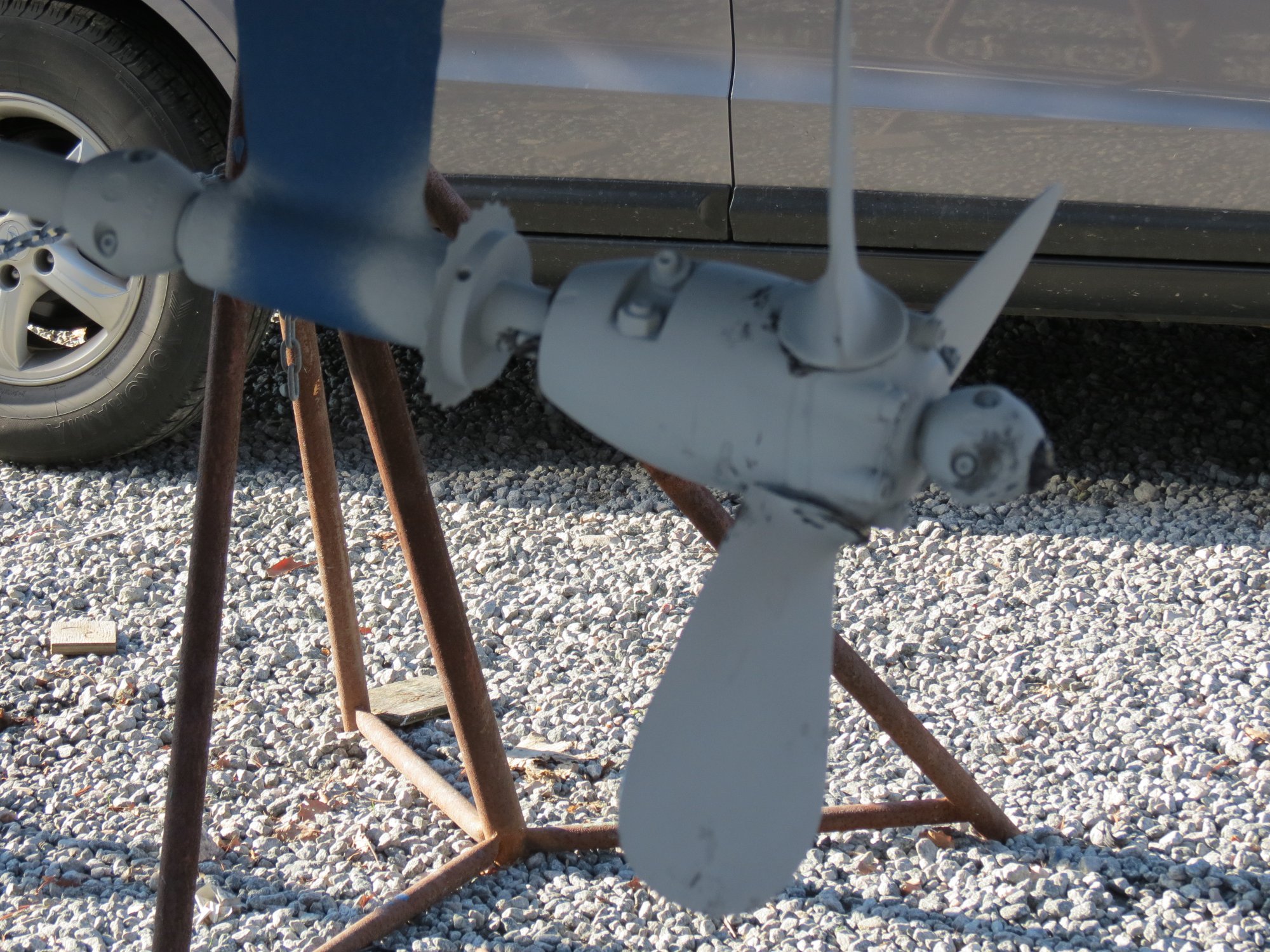

24,786
Ok What do you have right now. Do you have a picture of the prop?

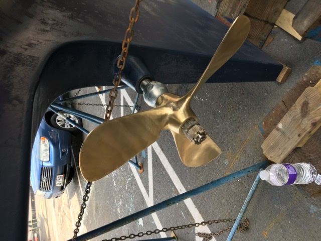

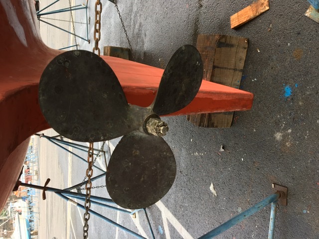

I wanted a similar results. I went from this original old design...
to this...
Big design change. If original had been a more modern prop, there would not have been as much change.

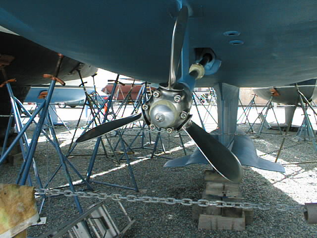

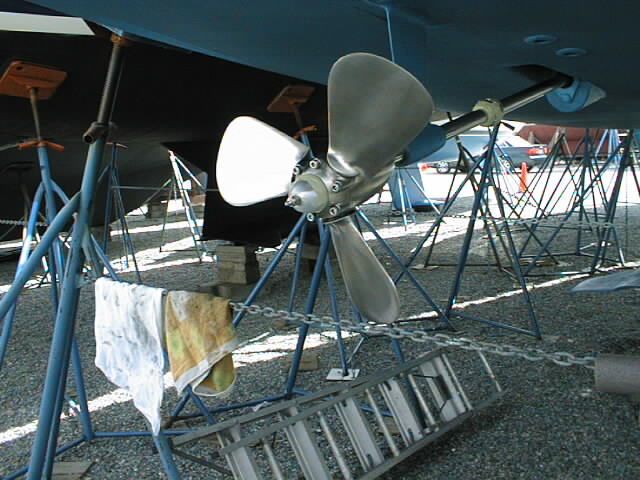

Many years ago I changed out the 2-blade for an AutoStream 3-blade feathering prop. At the time it was the only feathering prop that could be adjusted for pitch both forward and reverse in the water. Also able to be greased in the water too. Since I was concerned about getting the pitch exactly right I thought that was an advantage. But now I think other feathering props can be pitched in the water. and at the time the cost was about $500 less than the Max Prop.
Turned out that no pitch adjustment was required. It was perfect from the factory.
The other factor for me was that the AutoStream was stainless steel, so there is no metal dissimilarity between the shaft and the prop.
The performance change was impressive. Reverse thrust is like having power brakes. Forward thrust is greater and I am able to punch thru current and waves easier.
BTW, I don't race. I just figured that if I was going to upgrade, I may as well go for the best possible change with the least disadvantages. The only disadvantage of this prop was the cost.
What ever you do, if you decide on a folding or feathering prop, I would recommend installing a line cutter to protect the prop from entanglement damage.

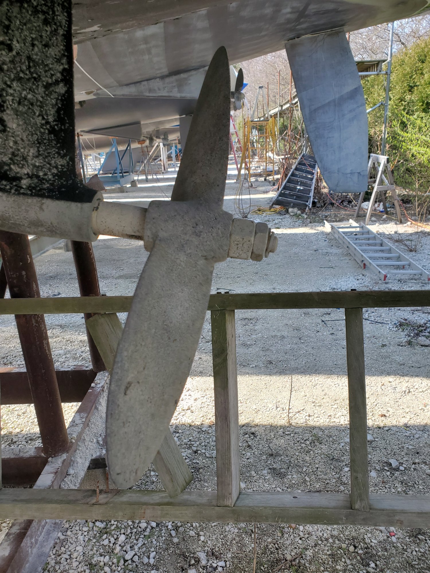

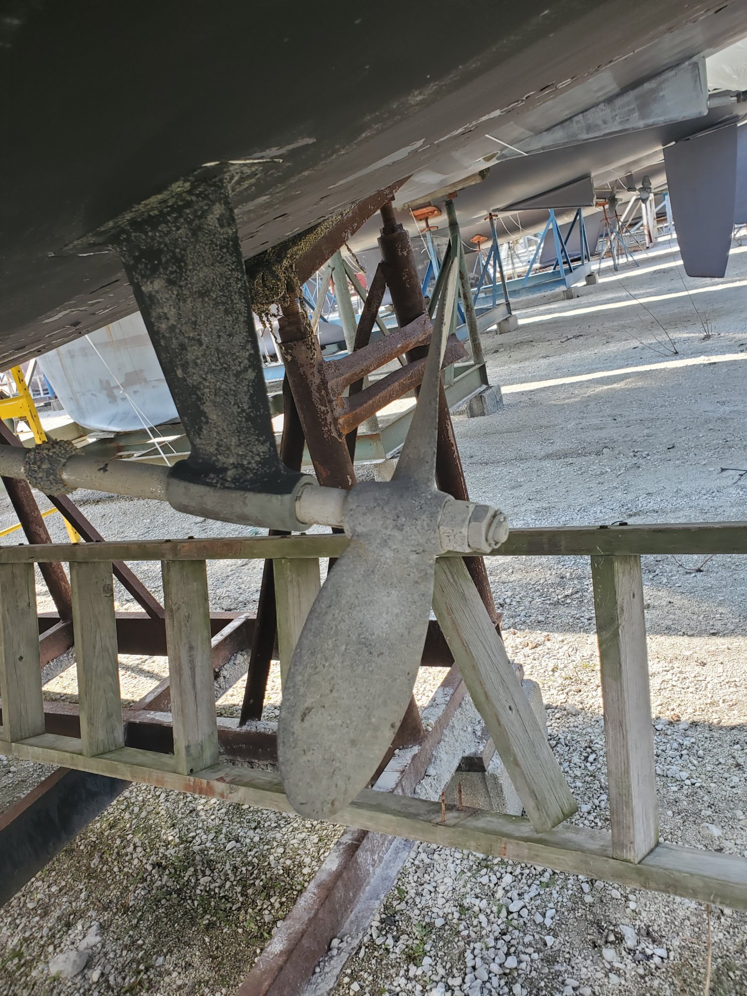

Ok. You have a decent design to a prop serving as “auxiliary” power for a sail boat. I think an investment in cleaning up the prop, perhaps even sending to a prop shop for a tune up would be worth it.
Two blades make less drag for a sail boat, especially when aligned behind the keel.
View attachment 177452View attachment 177453View attachment 177454
How well does the line cutter work? Do you have frequent need of it?
Being ignorant of diesel stuff on a sailboat..... how does the prop align? Does that happen by natural drag or do you have to set it somehow?
Jan 4, 2010
1,037
Farr 30 San Francisco
You align it, then put a mark on the prop shaft inside the boat. Then by looking at the mark, you can tell if you are aligned. Or get a folder like Flex-0-Fold. Reportedly they have excellent motoring performance as well as very low drag for good sailing performance
