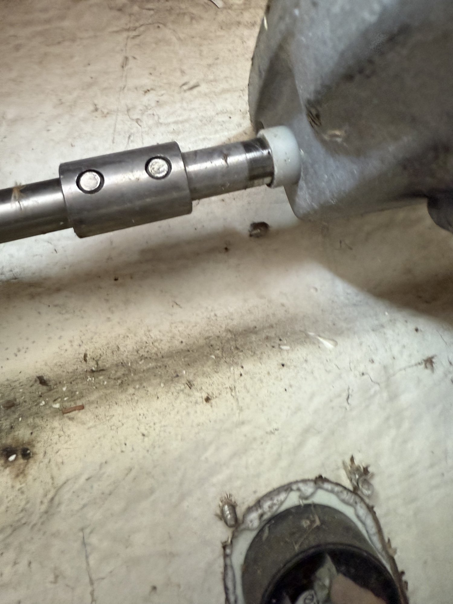

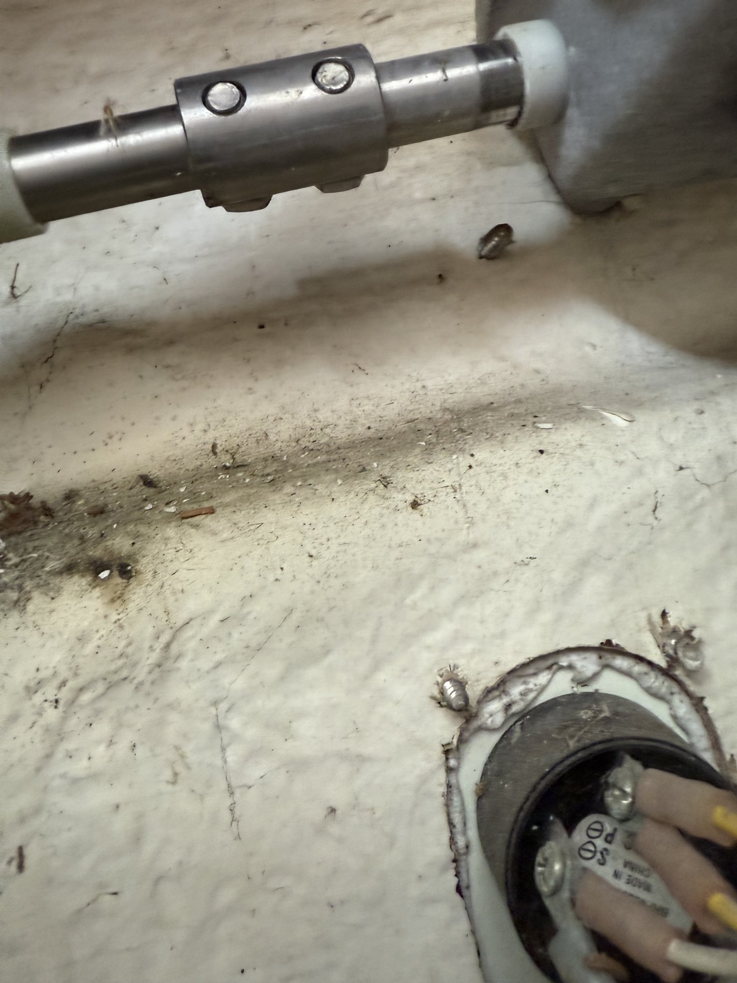

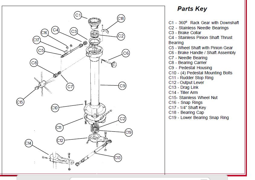

I have the CD-i Edson Steering and my brake is not working. From the Edson pdf it appears to be a collar that needs to be replaced, and you have to pretty much disassemble the steering column to replace it.
Has anyone done this?
Also .......how to lubricate the lower needle bearings????
