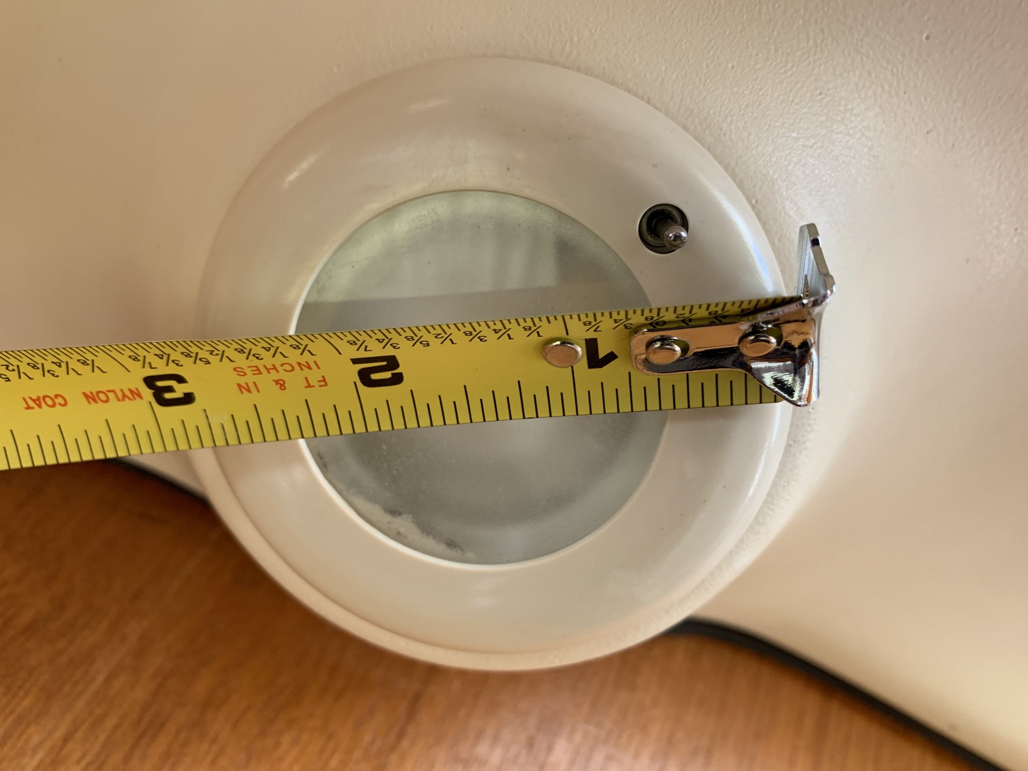

Hey Guys, looking at swapping out our cabin lights with led. Question 1, how do I get access to bulb ( I'm sure these things are getting brittle after 20 years). Question 2, any ideas regarding replacement? Thanks,

A photo of the lights and their inside and outside dimensions would help. Do they have an integral switch? Do they have a ring you can pop off to get access to the light? You might be able to match the light and buy them from this site SailboatOwners.com search .

Sorry for the later reply, just got back to the boat yesterday. Attached is a picture of the light in question.

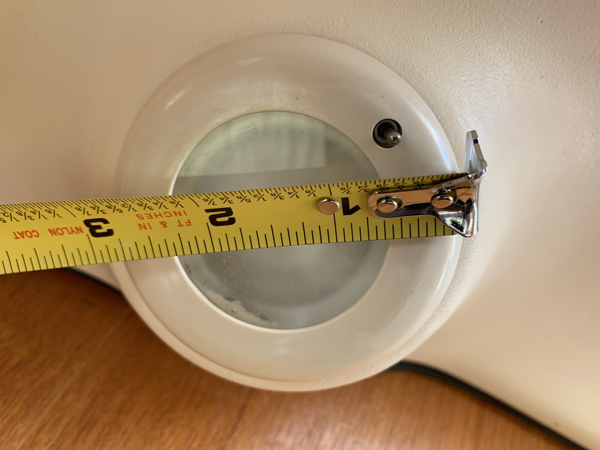

Sorry for the later reply, just got back to the boat yesterday. Attached is a picture of the light in question.View attachment 196662
Gary, the white bezel snaps on and off the base, using a small screwdriver or fingernails to pry it loose. Be careful though as the glass lens is loose in the bezel and easy to drop. I believe the LED bulb is a side pin G4. I bought mine at marinebeam.com about 5 years ago. They are also available on the store site here. edited: I had posted a bad link see next post for correct link. Interesting, the corresponding part for the H340 is white, not beige.
