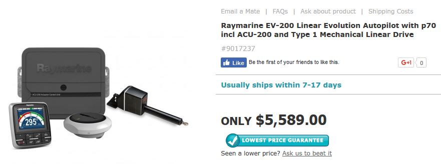

Hi Hugo
You must use EV200 with Liner Drive type 2 for your boat. EV100 is TOO SMALL. it will be able to handle your 38ft on light winds only.
I have published few photos related to installation of my latest Raymarine EVO Autopilot on Hunter 38 - search for topic "
Hunter 38 - Saloon Deadlights". Hope it will be similar on Hunter 380.
Good luck
Sergey

Hunter 38 Auckland
Check attached picture - this is the pack which I have bought. Please disregard price - it is NZ dollars. I am sure you will pay half price in USA :)

You are correct Terry! Go with larger system if you can!!! I am glad with my EVO200 choice over EVO100 (double price...). I am racing / cruising this boat with my wife only so my pilot works basically as third crew member - great helmsman in all conditions especially during tacks, jibes, sales changes, etc.
