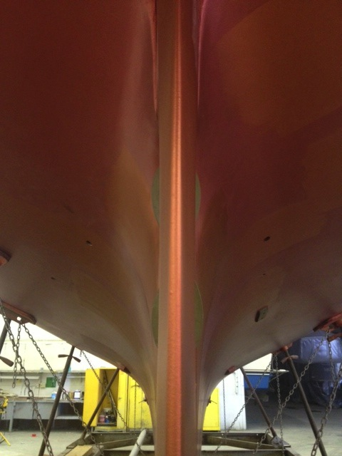

the OP asked about props. so lets talk props and how it can affect the sailing of a boat. just the sailing part, not the motoring.
this is aeolus. two bladed, fixed prop, michigan wheel "sailing prop", held in place by a brake on the shaft. this is how the alden company designed the boat to be used. racing, cruising, just sailing, this is how my boat works.
next, lets talk about the science of props on sailboats while the boat is under sail. it's very easy to test the differences and measure the differences. take a motorboat, mount a 40' pole in the bow in the middle of the pole. tie 2 J35's to each end of the pole. one with a three bladed prop. one with a folding prop. start motoring. have a scale attached to each tow line. read the drag differences at say every 1/4 knot up to say 10 knots. now you can start comparing drag differences through the whole spectrum of the the boat sailing from A to B. more considerations. does the drag of the prop affect the function of the foils, the waters drag on the hull surfaces. so, running, reaching, beating, the drag might affect the boat differently in each mode. all the foils must work well to get good VMG's. dragged water will change the rudder/ foil dynamics.
lots to consider to just 'sail your boat well'
