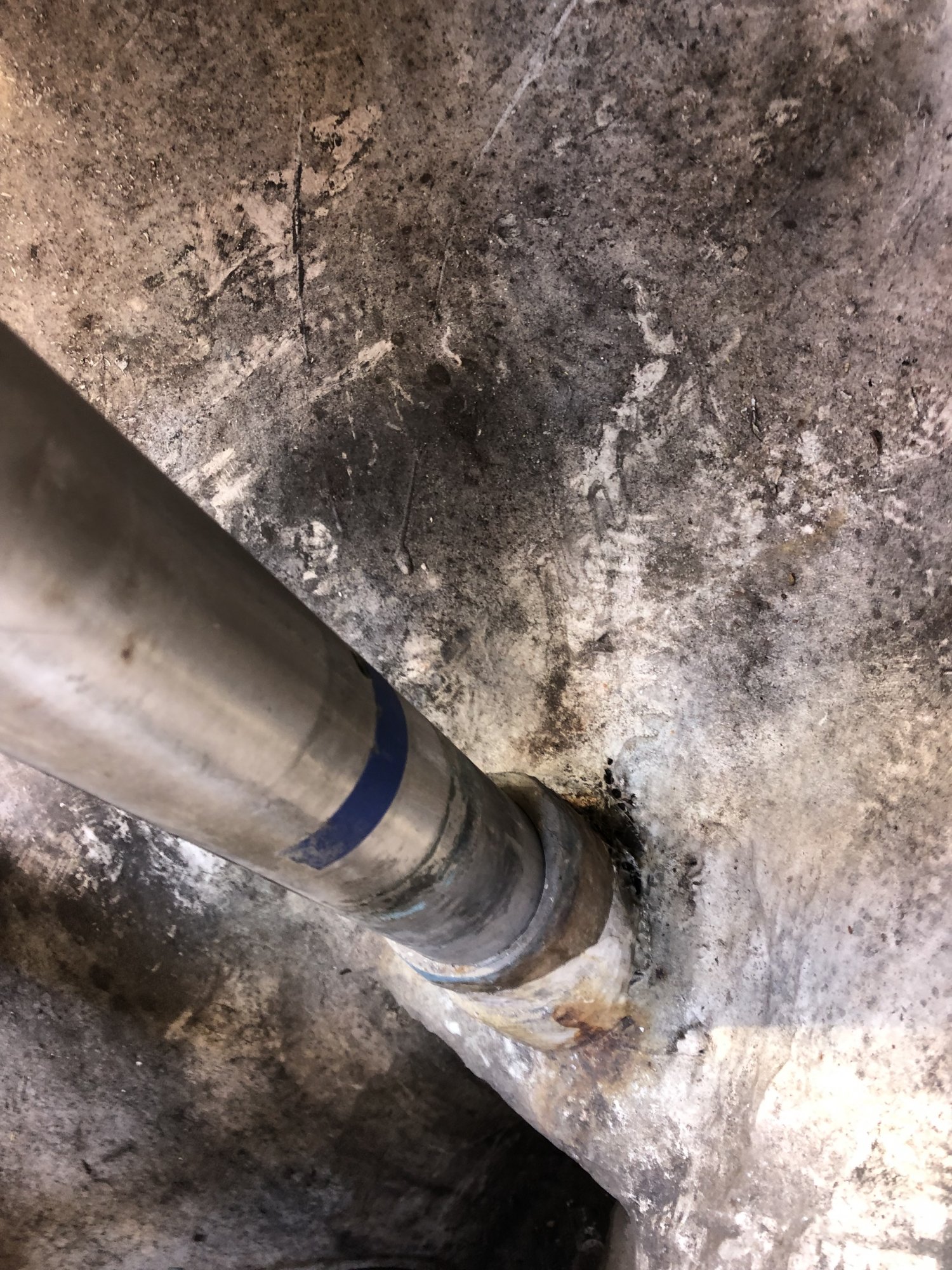

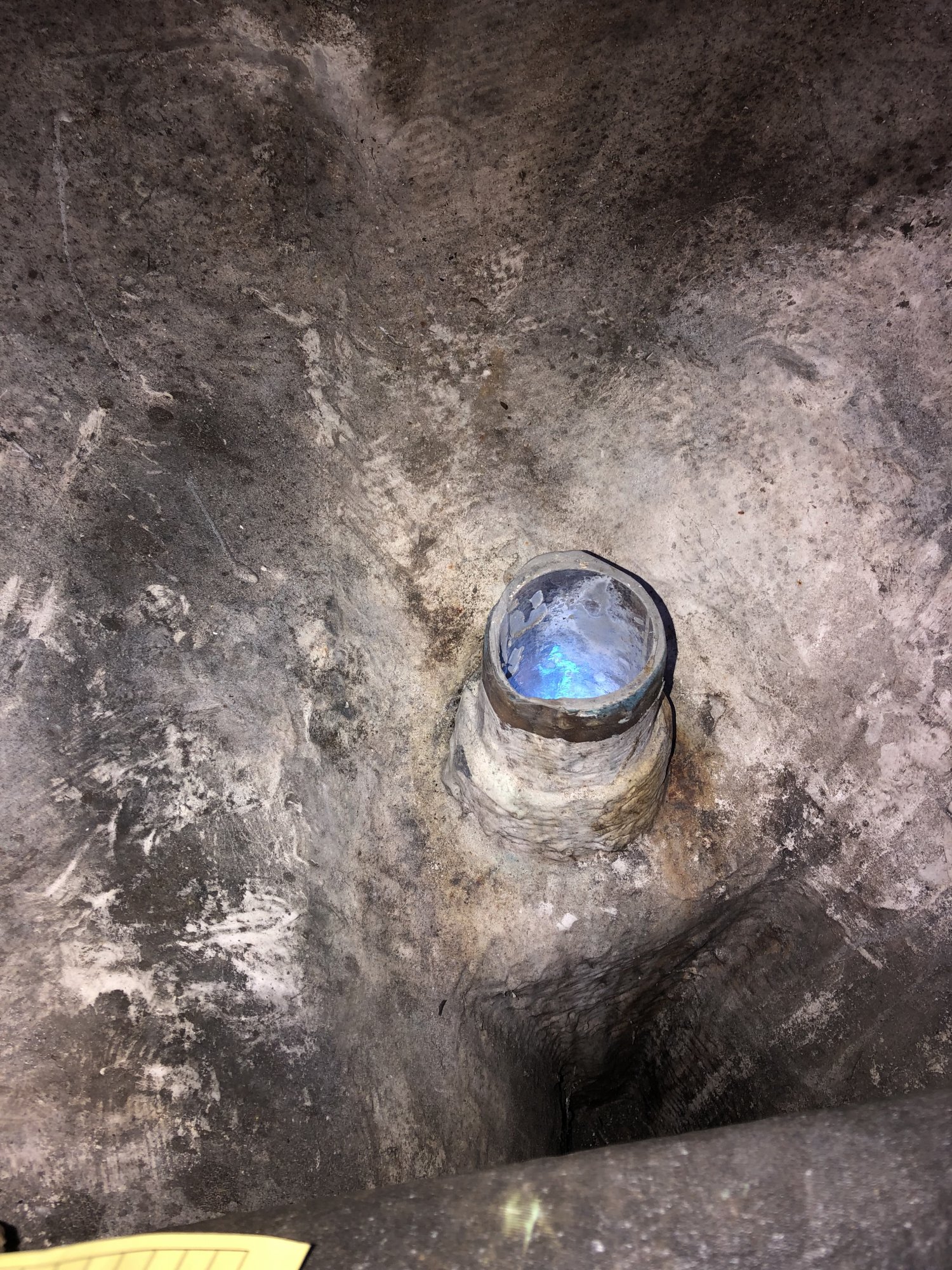

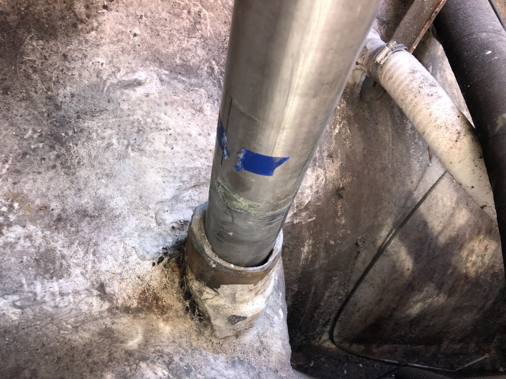

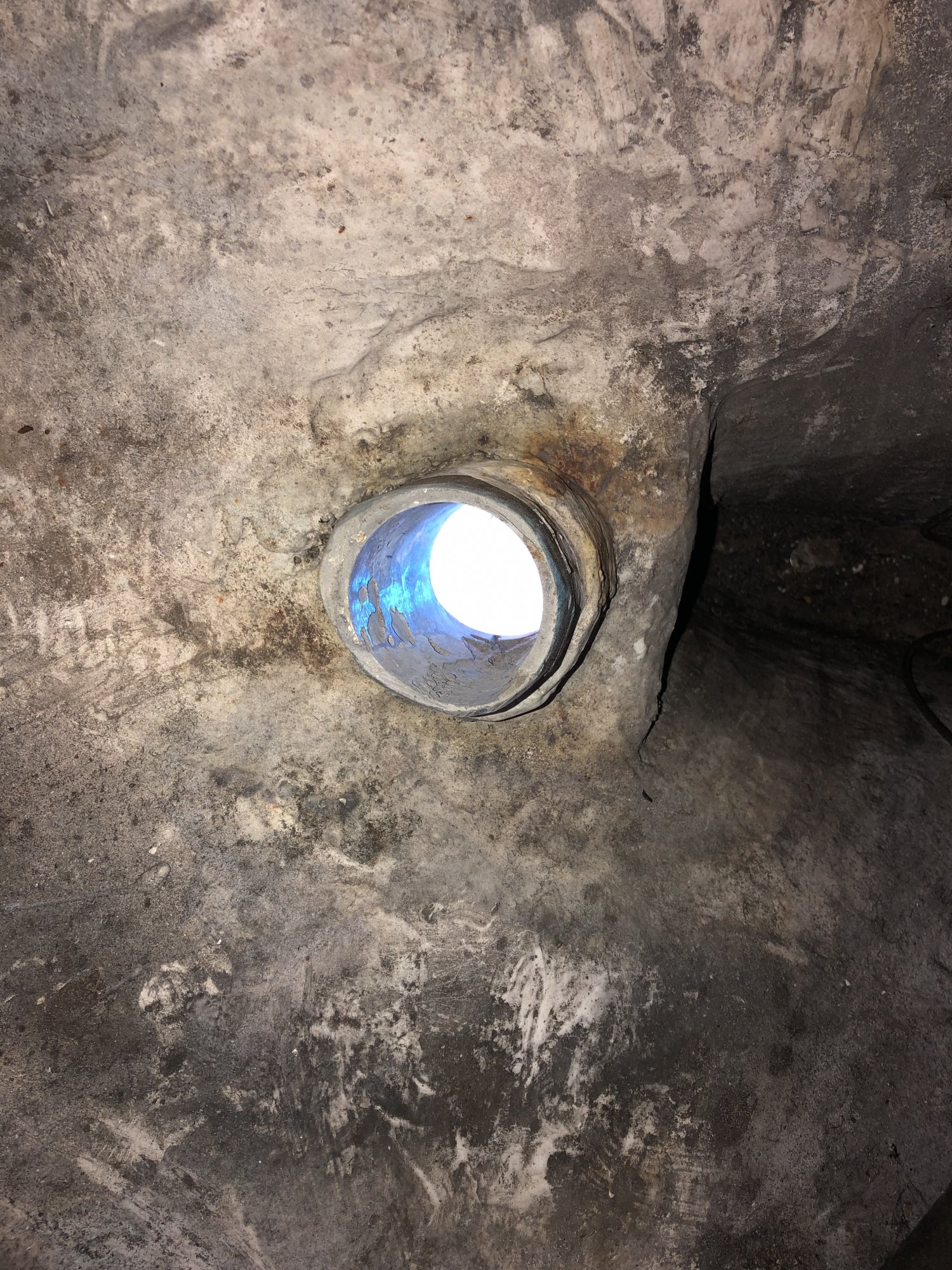

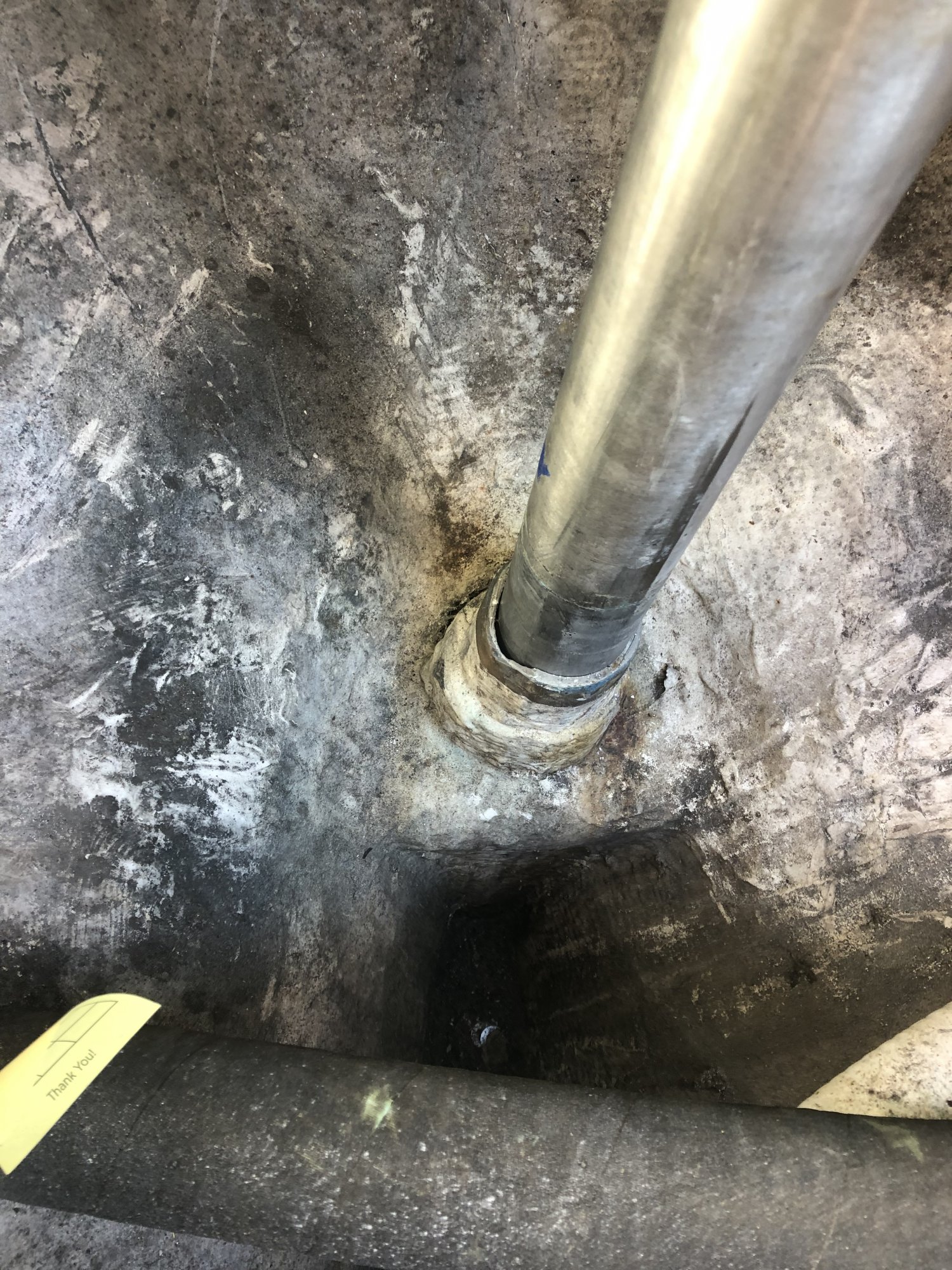

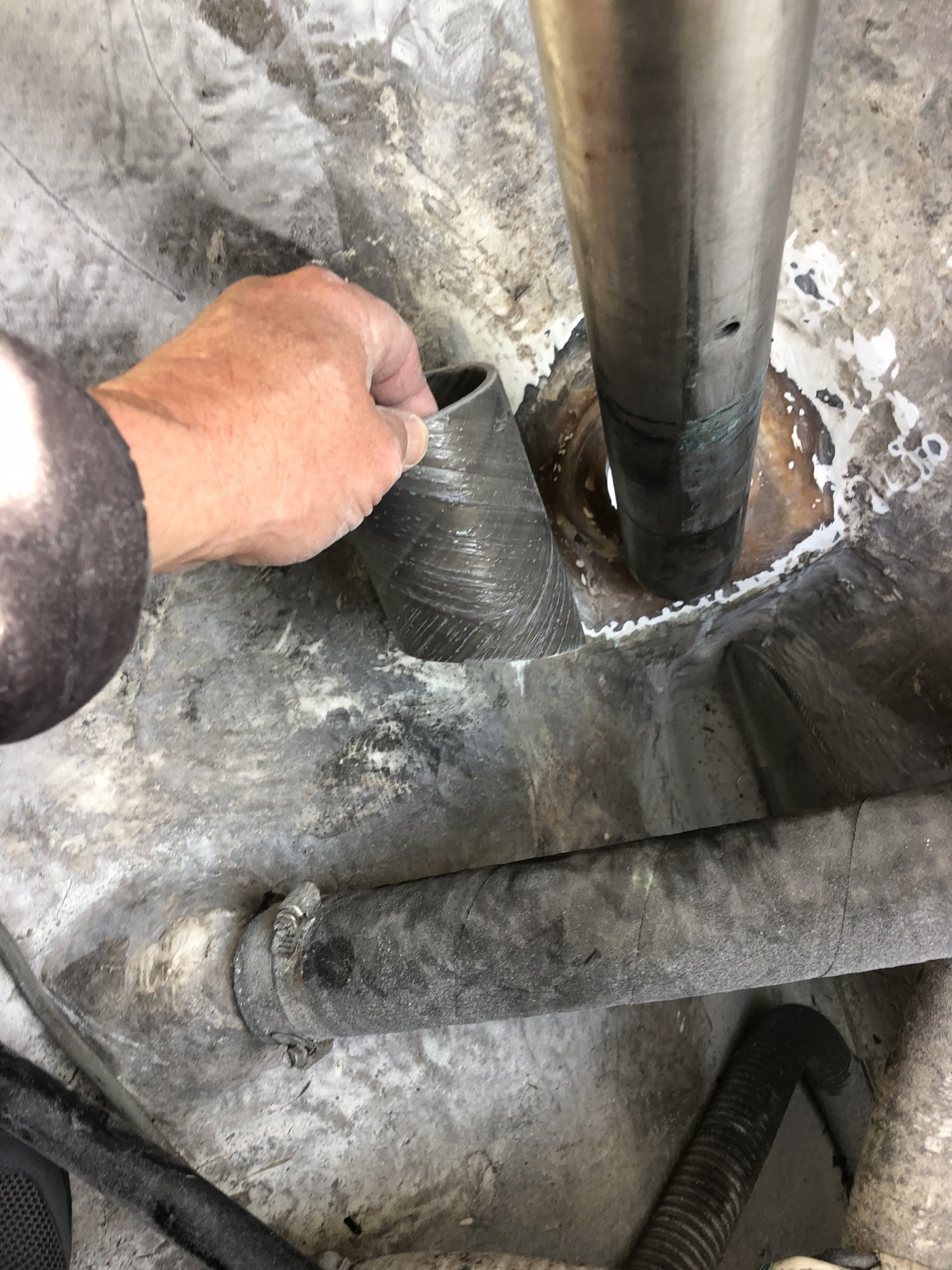

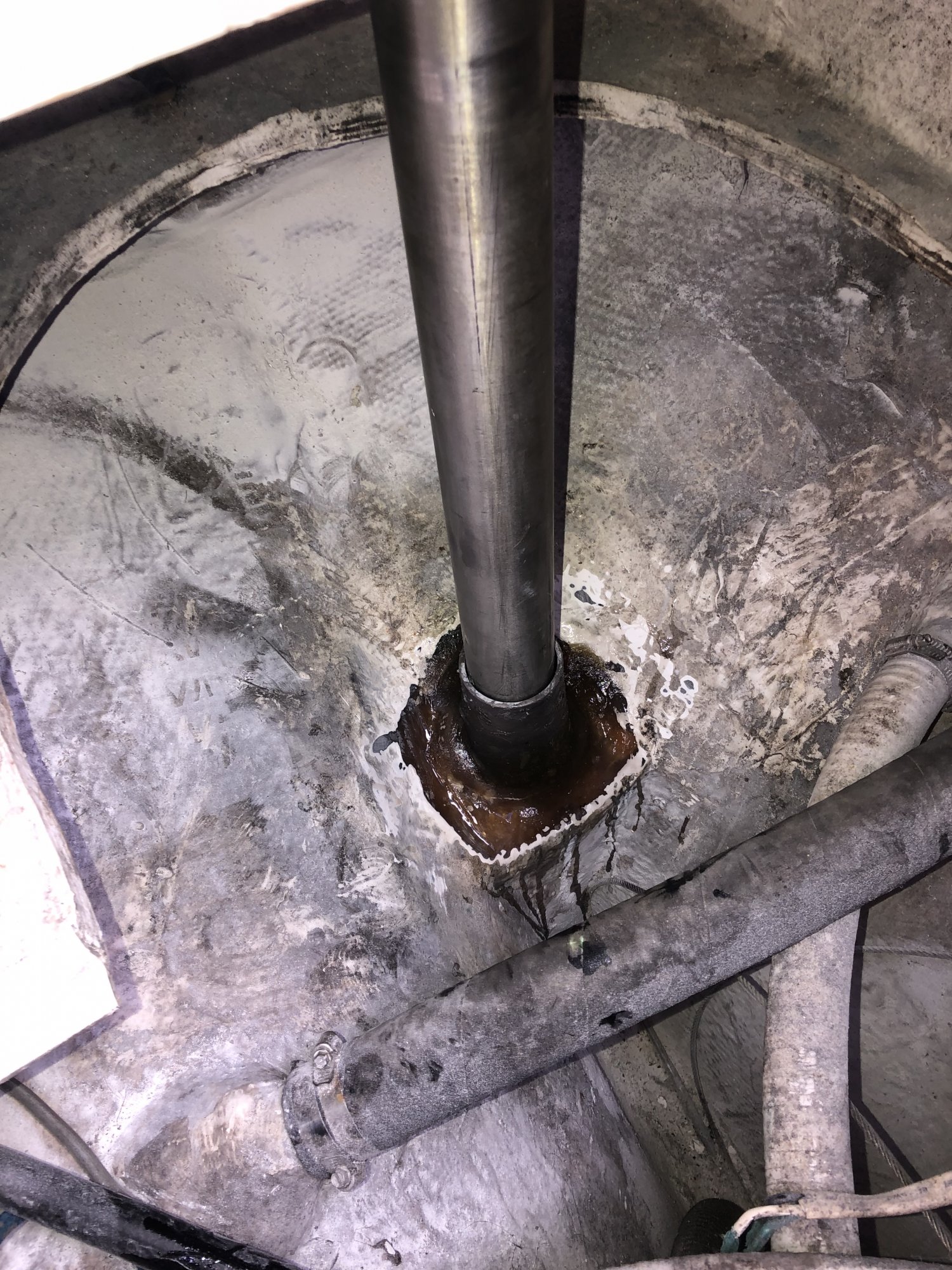

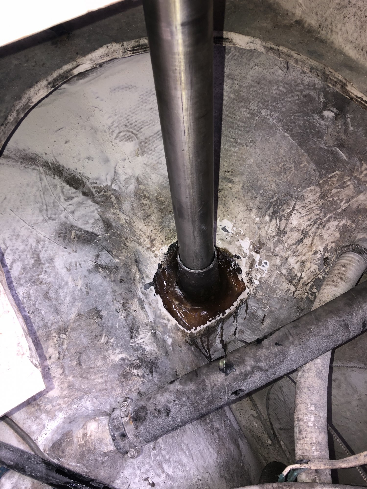

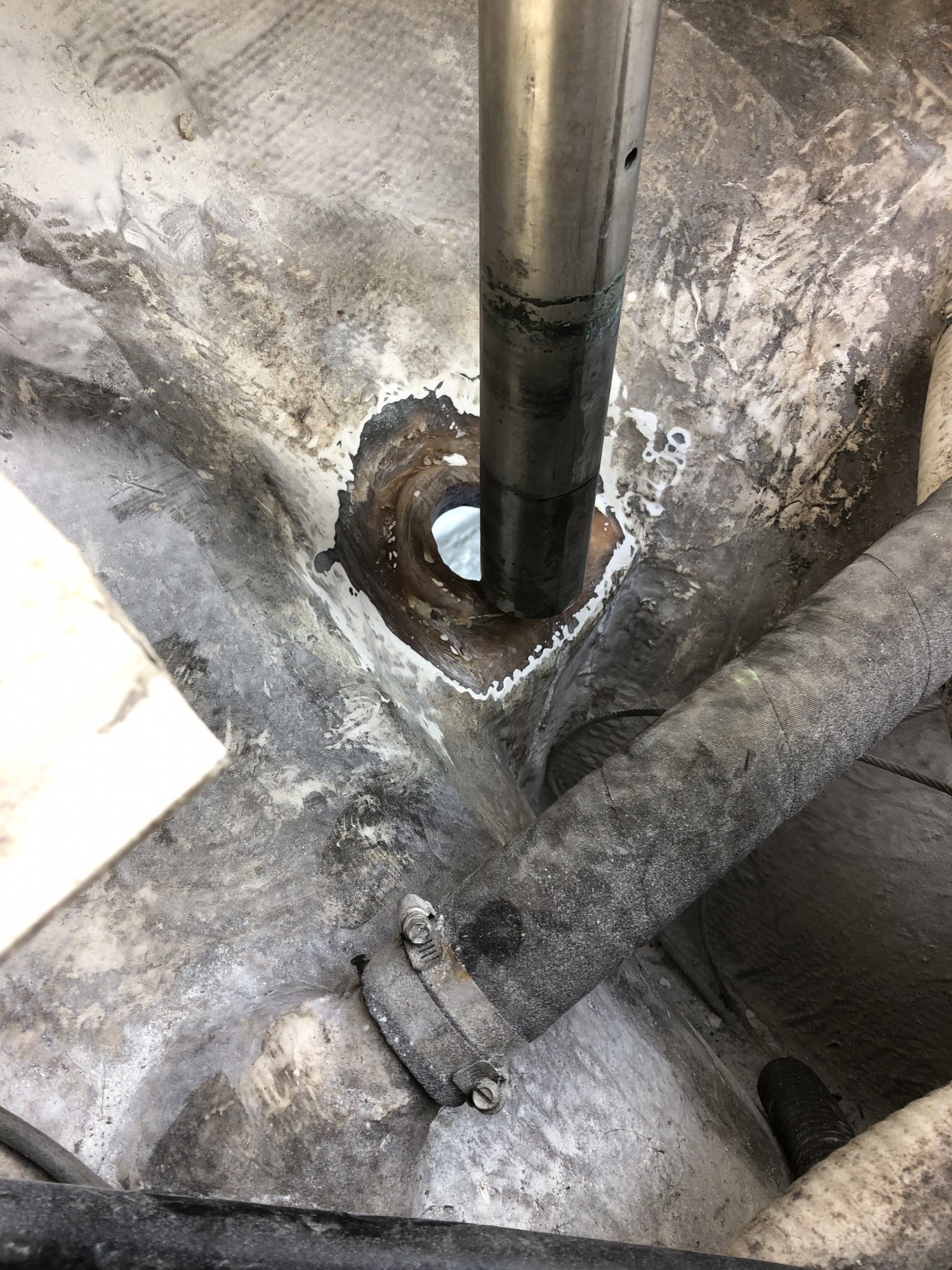

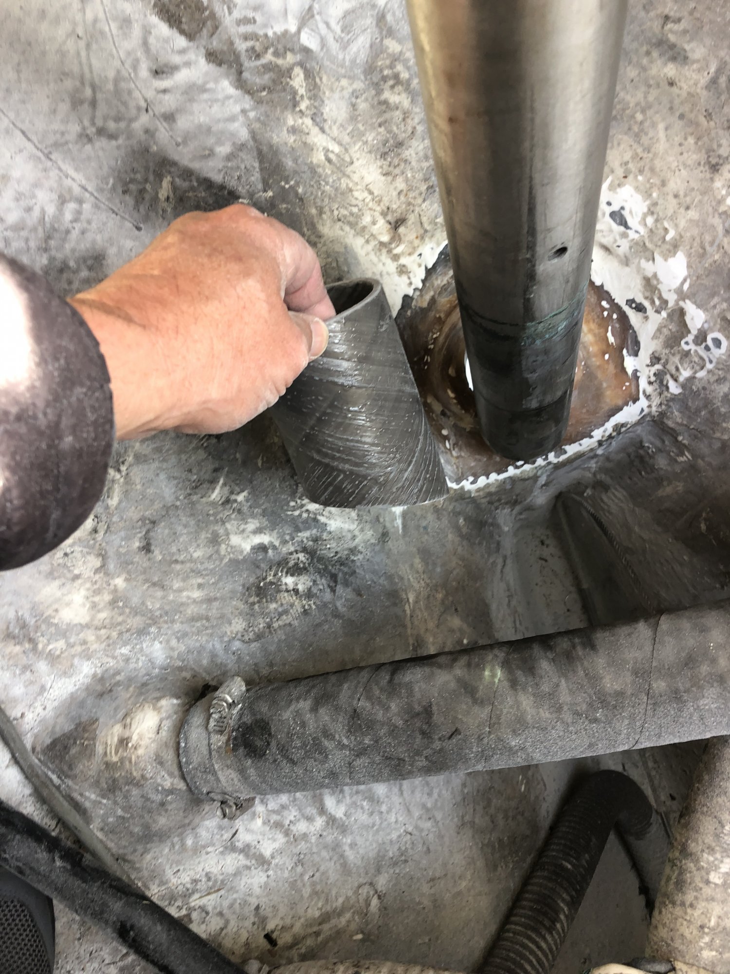

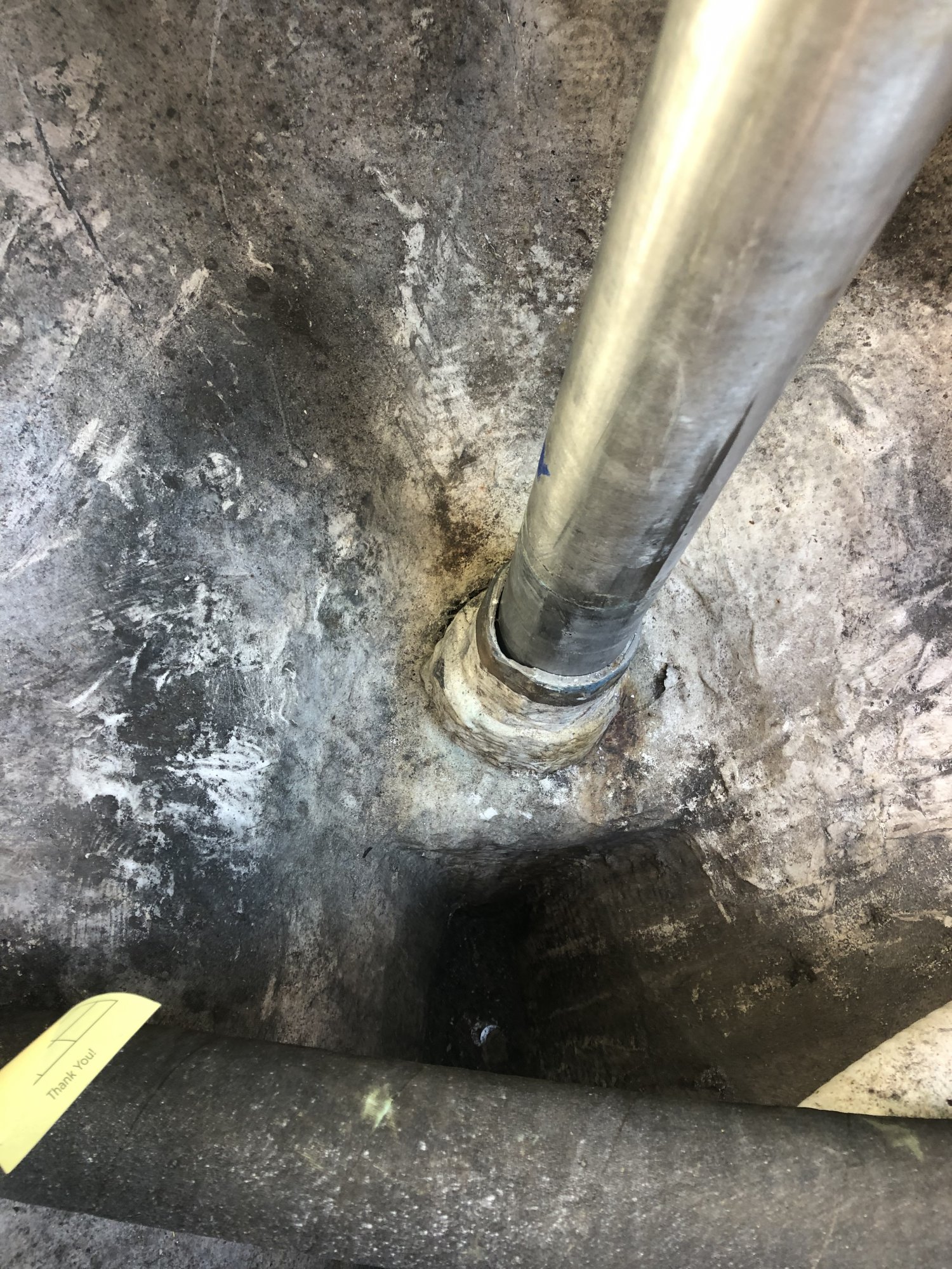

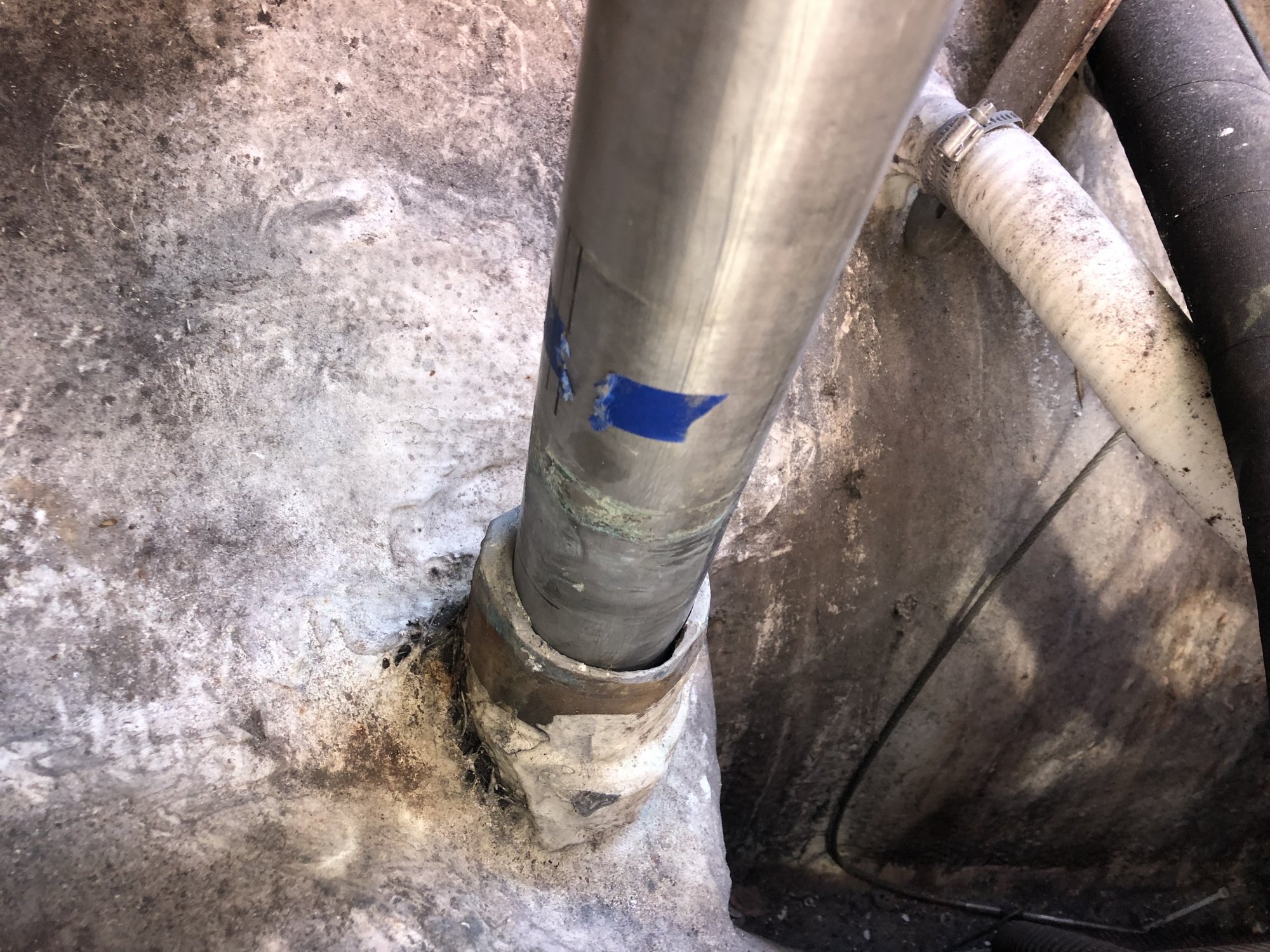

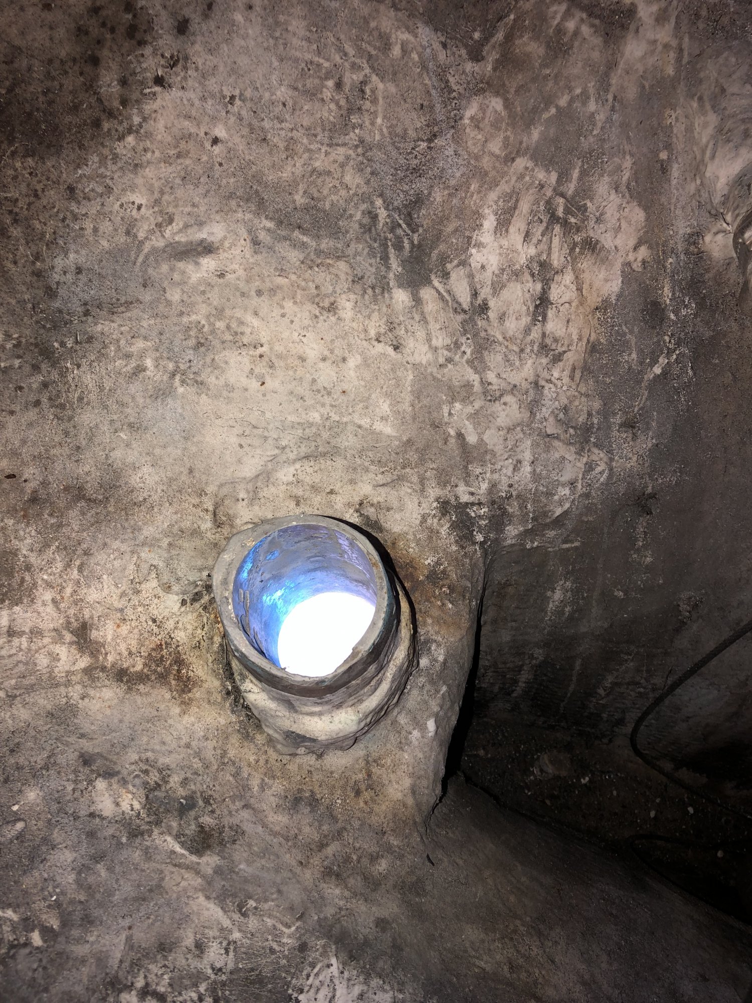

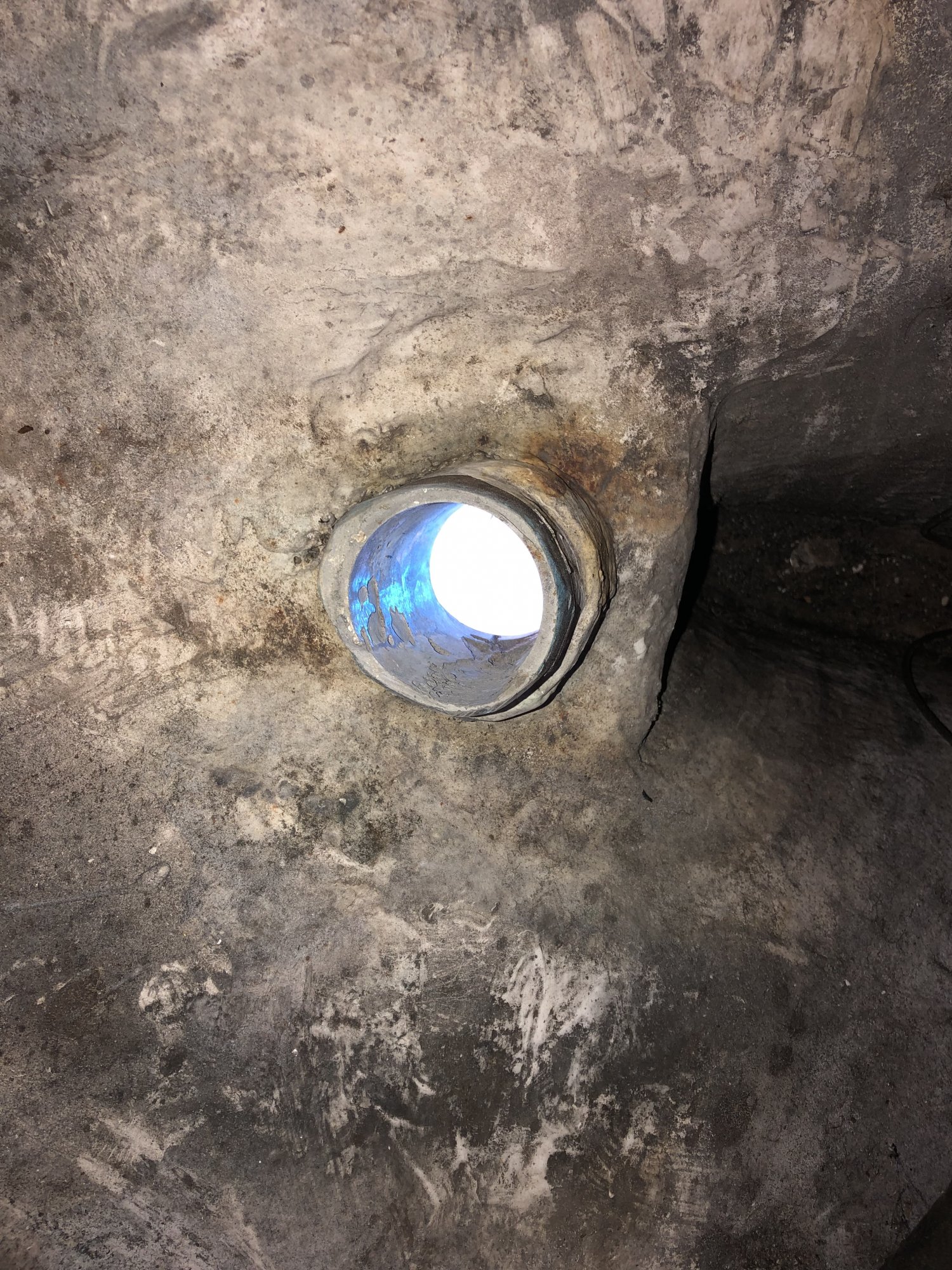

Looking for input from any H37C owners who have addressed/upgraded/repaired the lower rudder bearing.
Because I have offshore plans for my boat, I’m looking to beef up (in particular) the lower rudder bearing. I’ve attached photos of mine, both with the rudder post in and out. You can see the uneven wear of the fiberglass tube coming up from the “volcano”. Before putting in the new rudder from Foss Foam I’m curious as to how others (Angus has chimed in—Thank you!) have addressed this.
I’m curious if anyone has figured out the original fabrication of this area. Is there a separate fiberglass tube which was stuffed into the “volcano” beneath all the way to the bottom, and then glassed around above it? Or was the fiberglass tube, to which the hose attaches, placed on top of the “volcano” and glassed in?
I’m toying with getting rid of the fiberglass tube/hose/packing gland in favor of a Tides Marine lower bearing with integrated seal. Has anyone done this?
Anyone grind off an uneven tube (like mine) from the volcano and glass in a new structural fiberglass tube to accommadate the 2.5” rudder shaft?
Thanks in advance for your input.

On my H37C, I just followed the method recommended in the West System Fiberglass Boat Repair and Maintenance manual. That is to say I waxed the rudder shaft, put the rudder in place with modelling clay sealing the bottom of the rudder tube and filled the "volcano" with some epoxy resin mixed with graphite power. I had a moment of panic when the rudder seemed stuck in the tube, but it came back out with a bit of wiggling. The rudder tube was back to spec again and there was no play in the rudder...success! Don't overthink this.

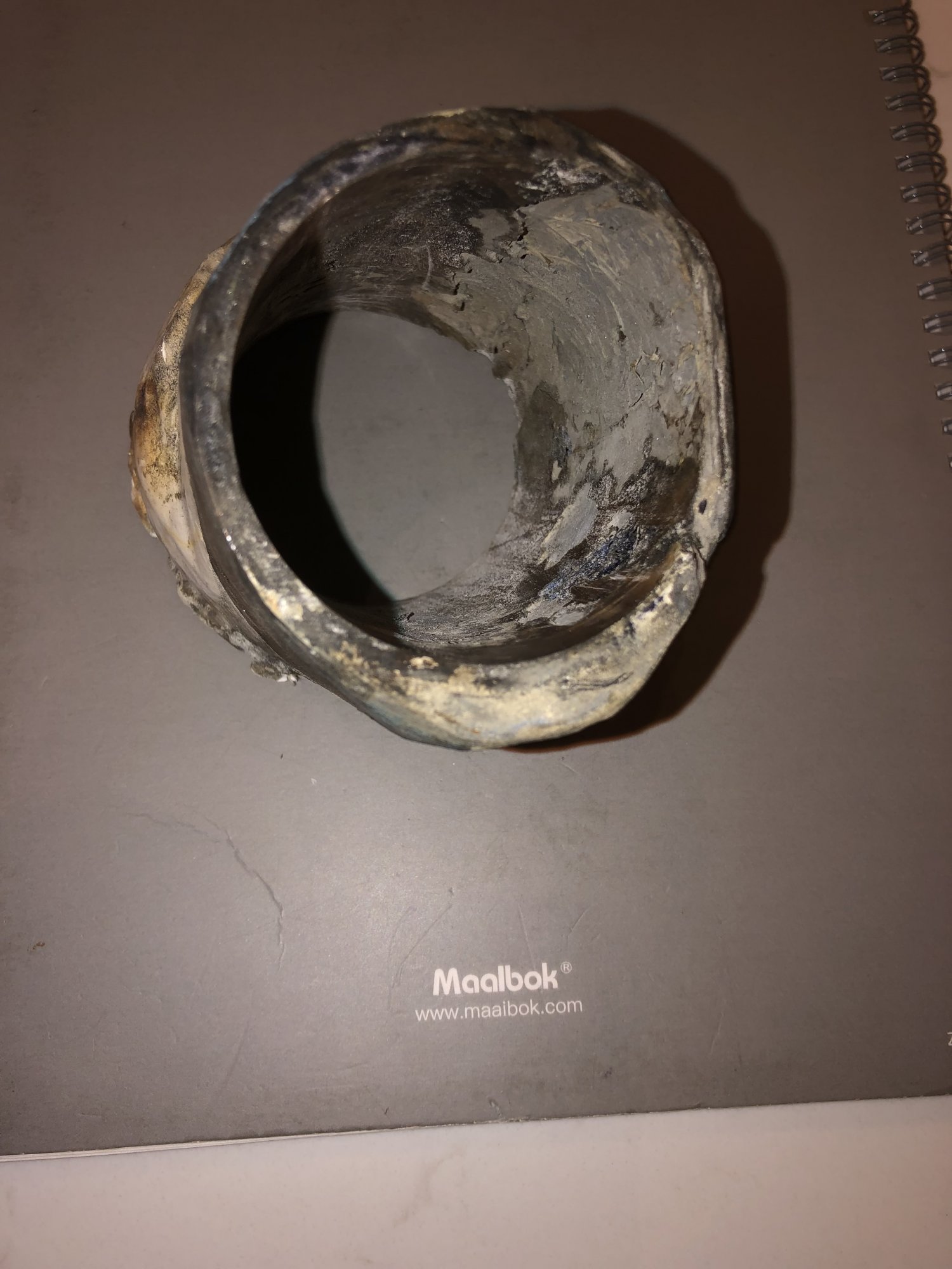

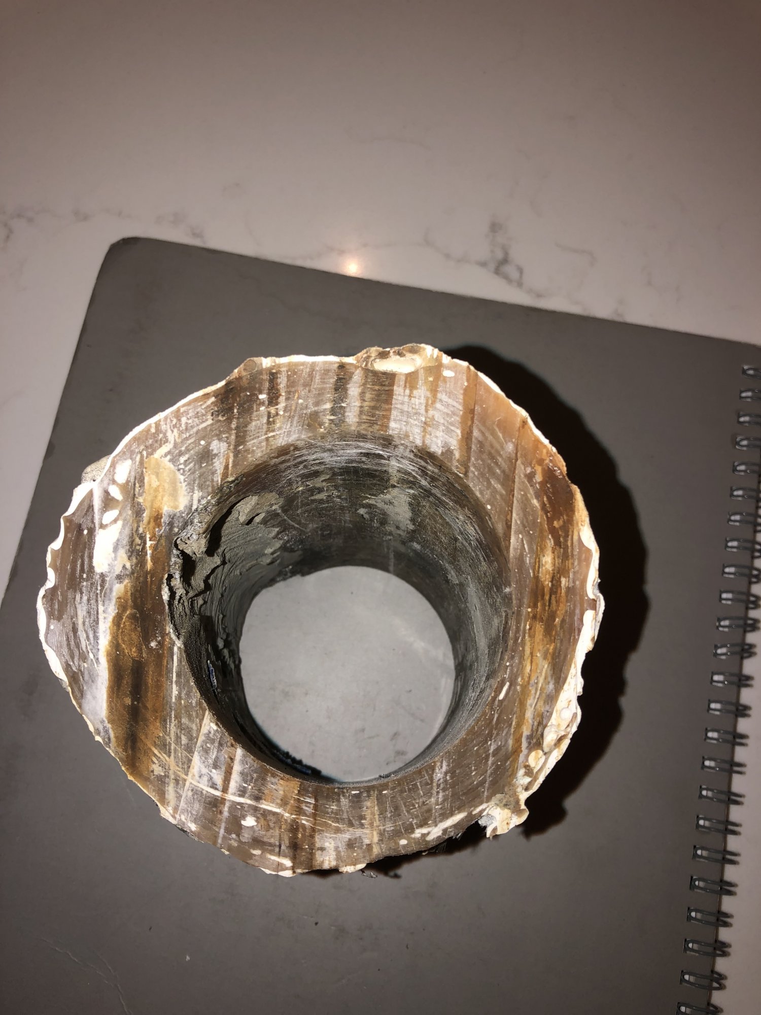

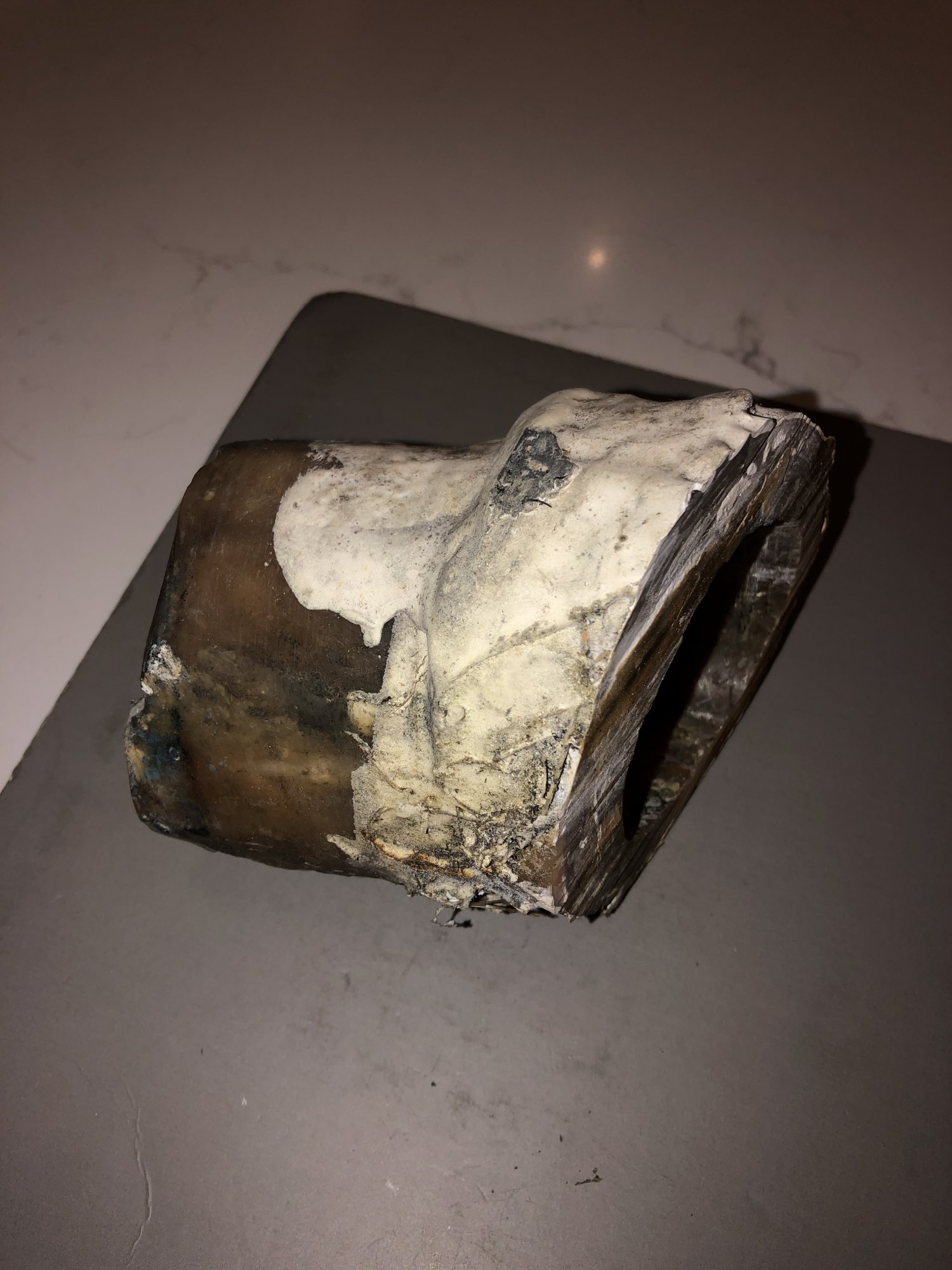

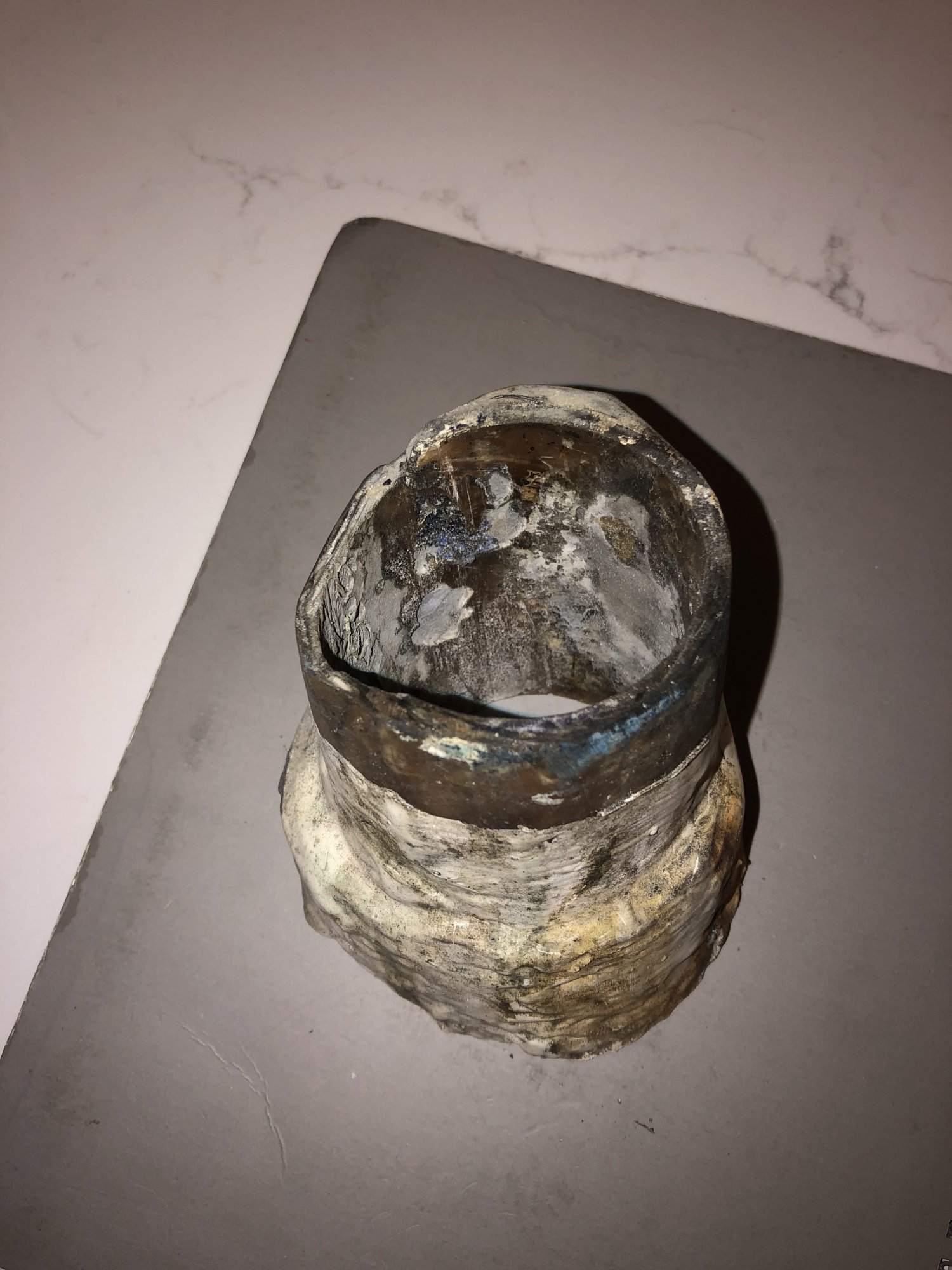

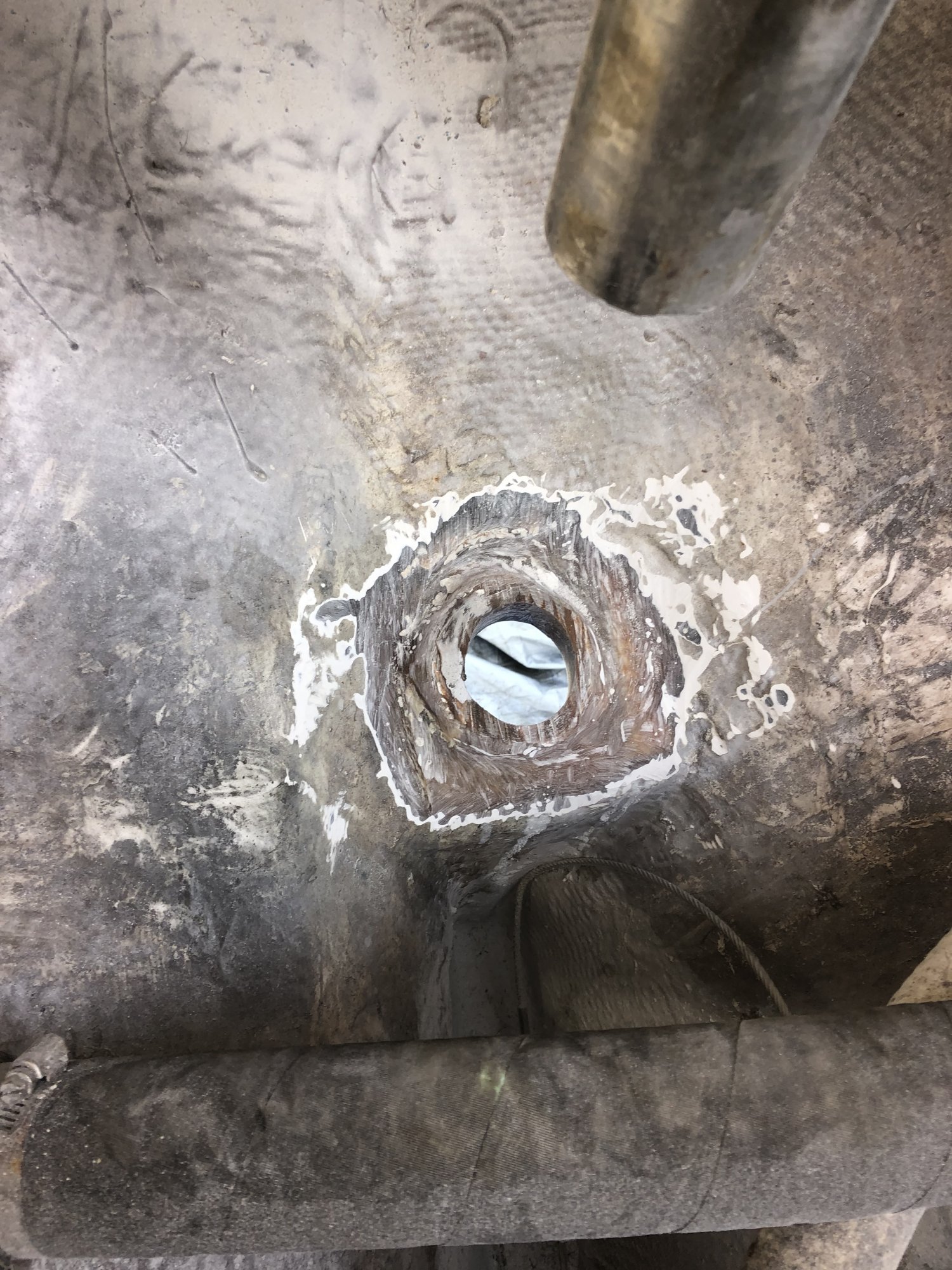

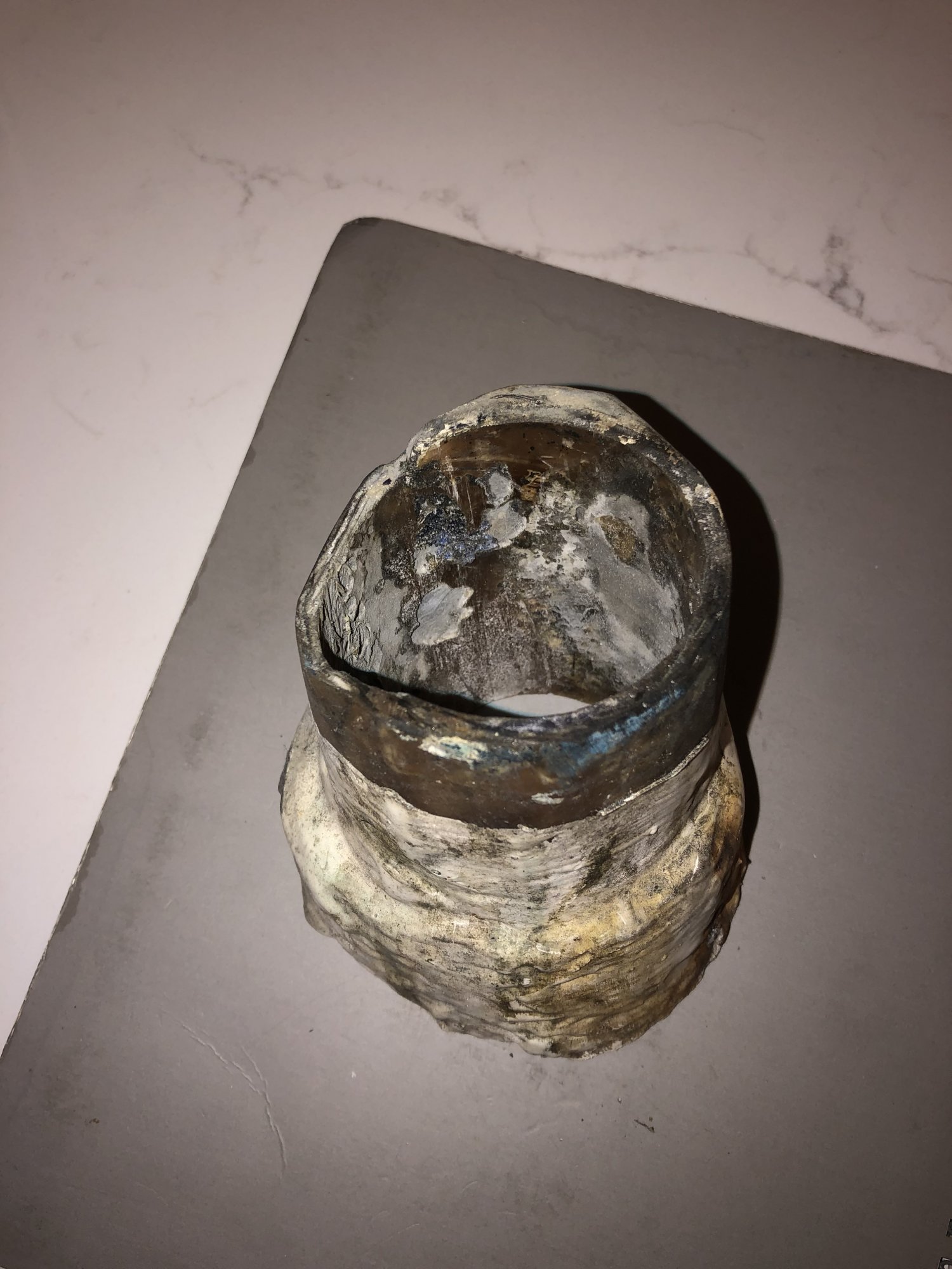

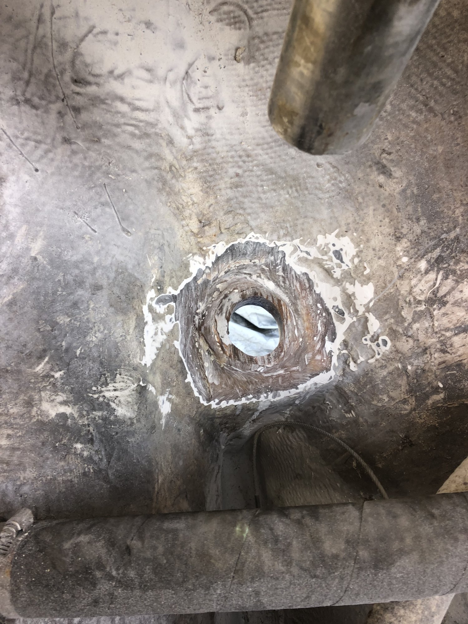

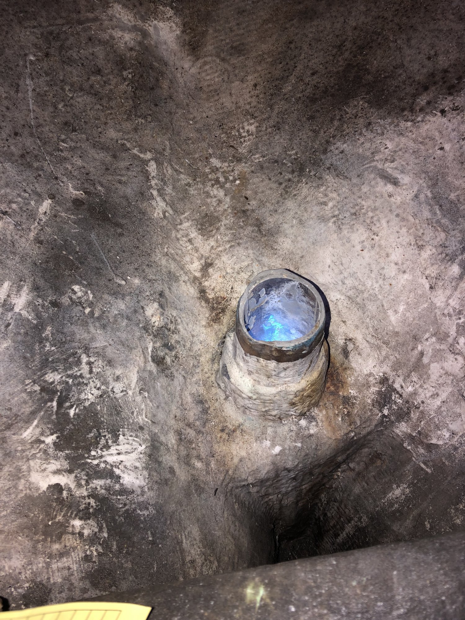

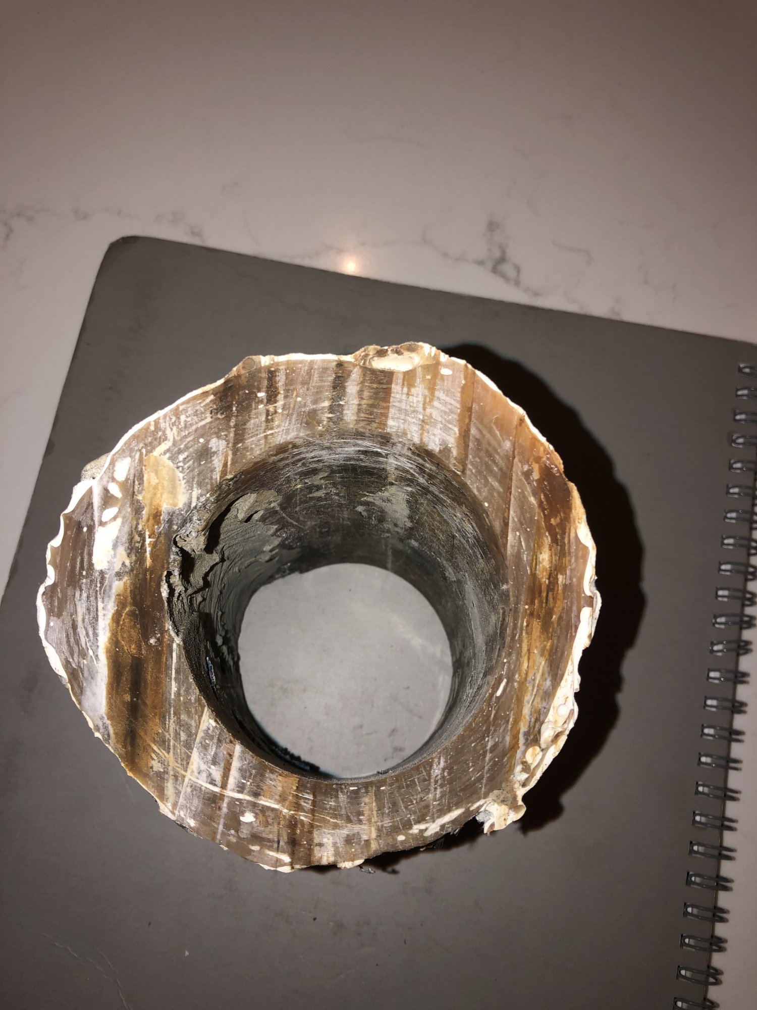

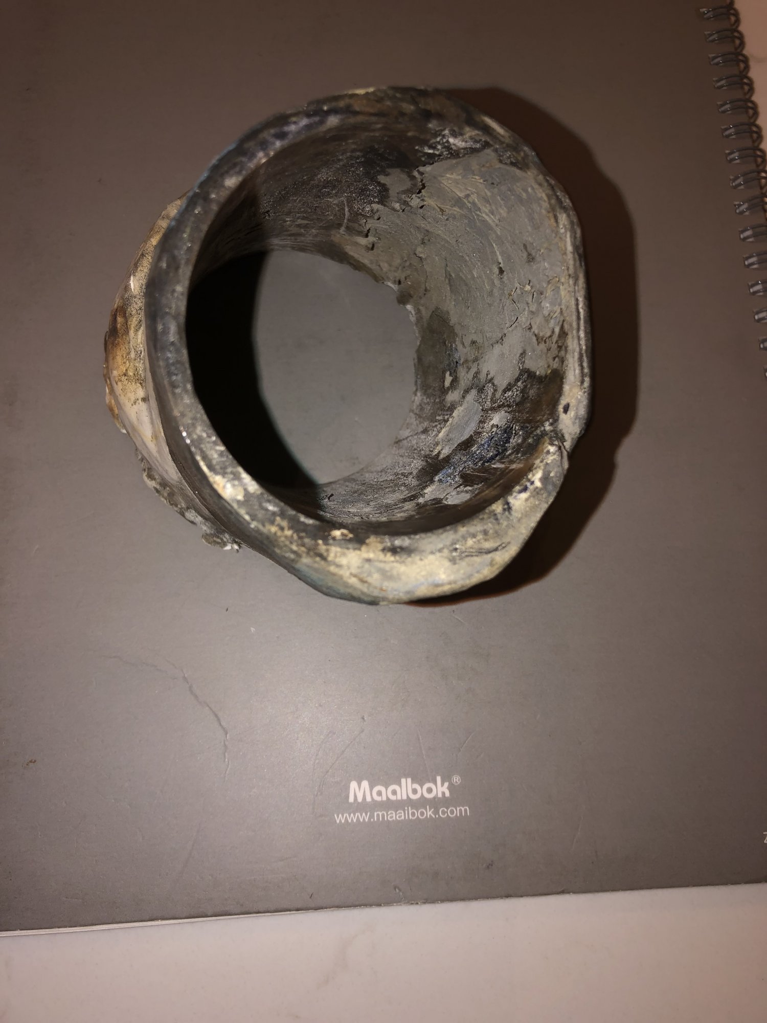

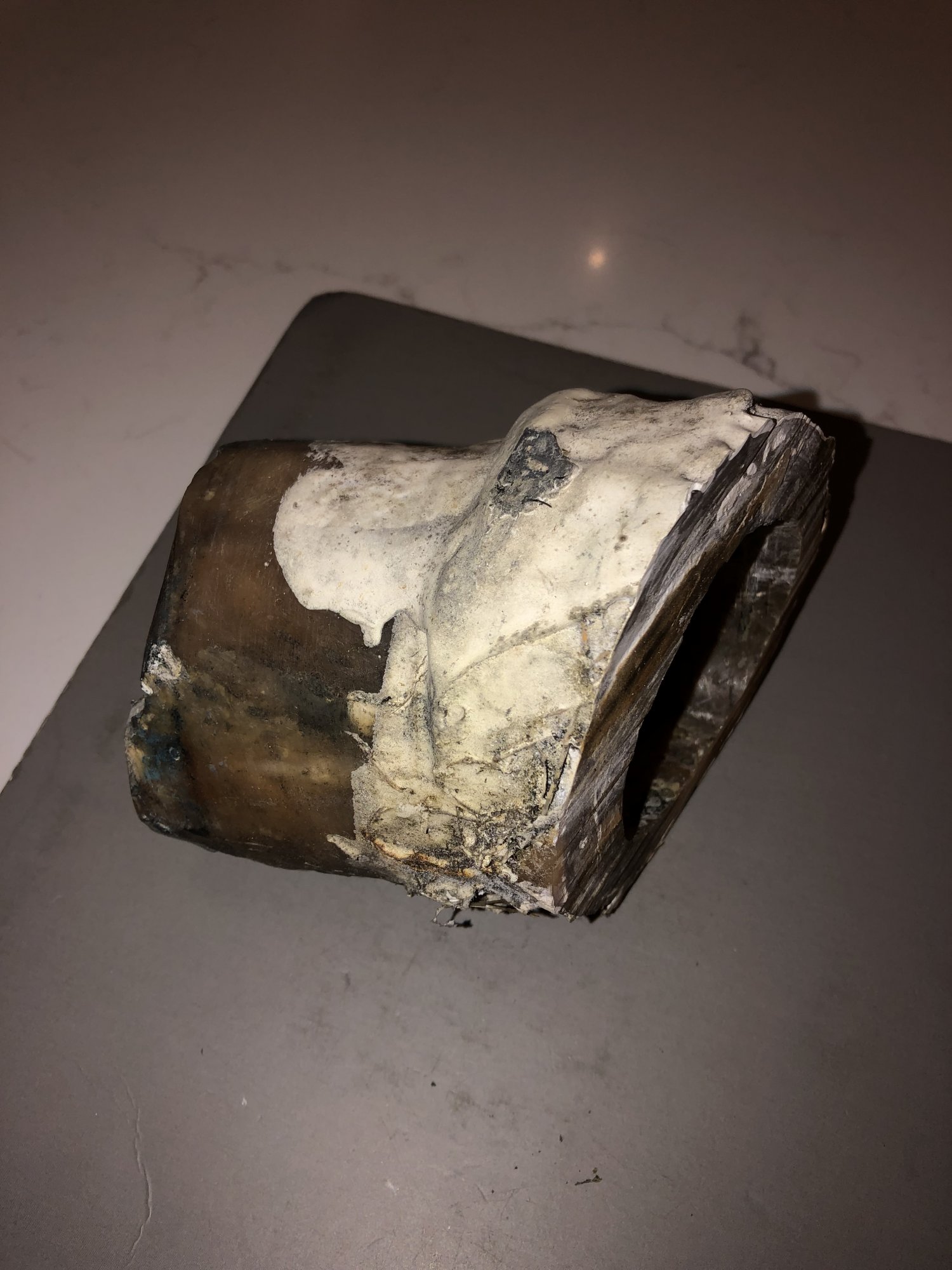

An update on the rudder replacement and rebuilding of the lower bearing (Volcano). I’ve attached some photos of the removed Volcano from the boat. You can see that the original glassing was very rough and uneven. It was removed by a worker in the yard who used a sawzall with a long flexible blade, and simple cut right to left. The first two photos show the volcano removed.
The next four photos show the removed volcano from different angles.

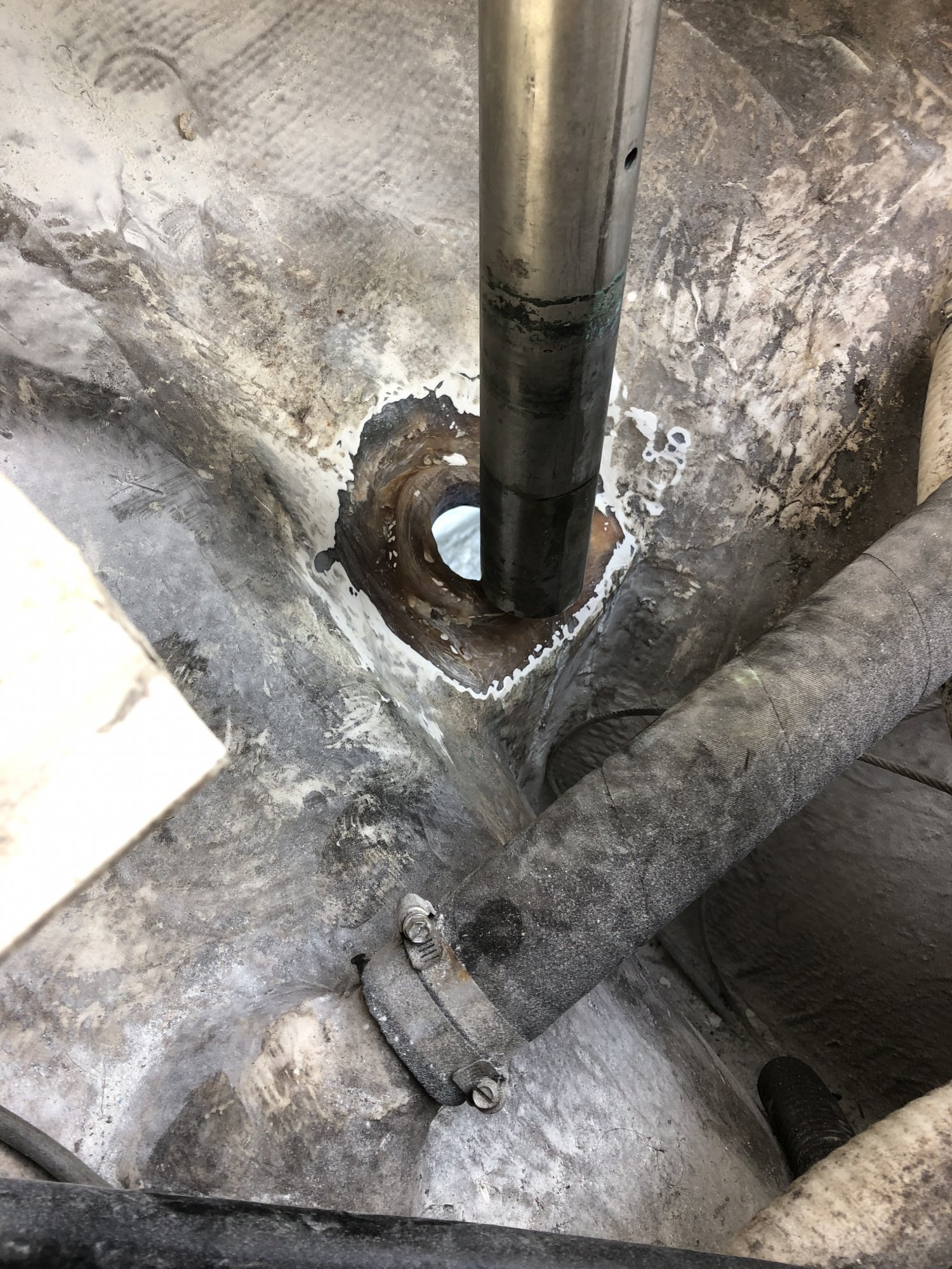

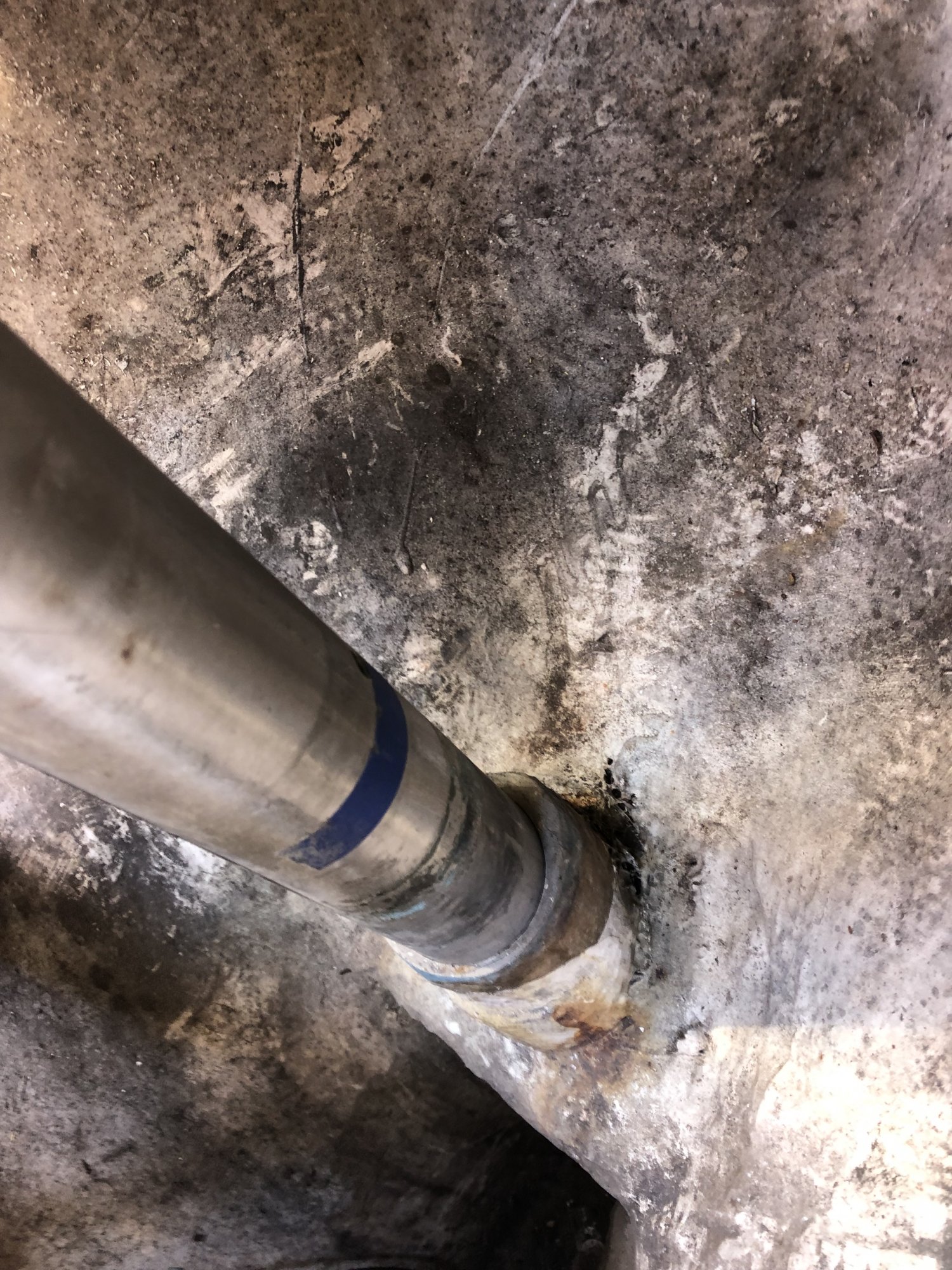

We then used the old rudder shaft—cut just above the blade—to position the new fiberglass rudder tube over the exit hole in the bottom of the boat. The right tube for this is Centek rudder tube and has the precise outside (3”) and inside diameters ( 2 7/8”) to accommodate the (1) existing rudder stuffing box, (2) the shaft log hose (3” ID), and (3) the rudder shaft diameter (2 1/2”). The fiberglass tube (1 foot) and shaft log hose were sourced from Fisheries Supply here is Seattle:
The old shaft was suspended by a 2.5” shaft collar above the upper bearing on the strongback. The shaft was then waxed where it would pass through the new lower bearing tube. After cutting the new lower bearing tube to match the angle of the removed volcano, we set it in some thickened epoxy and positioned it so the space between the old 2.5” shaft and the inside diameter of the new fiberglass tube was consistent all the way around. Then some light glassing was done around the tube and it was left to set up overnight (last photo).
Since then, a couple of fiberglass gussets were glassed into the forward portion of the new tube, and additional glass reinforcement is slated for this weekend. The result should be an improvement on the original. I‘m scheduled to install the new rudder this coming week, then I’ll bolt all the steering related things back together.
Hope this helps others thinking of tackling this.

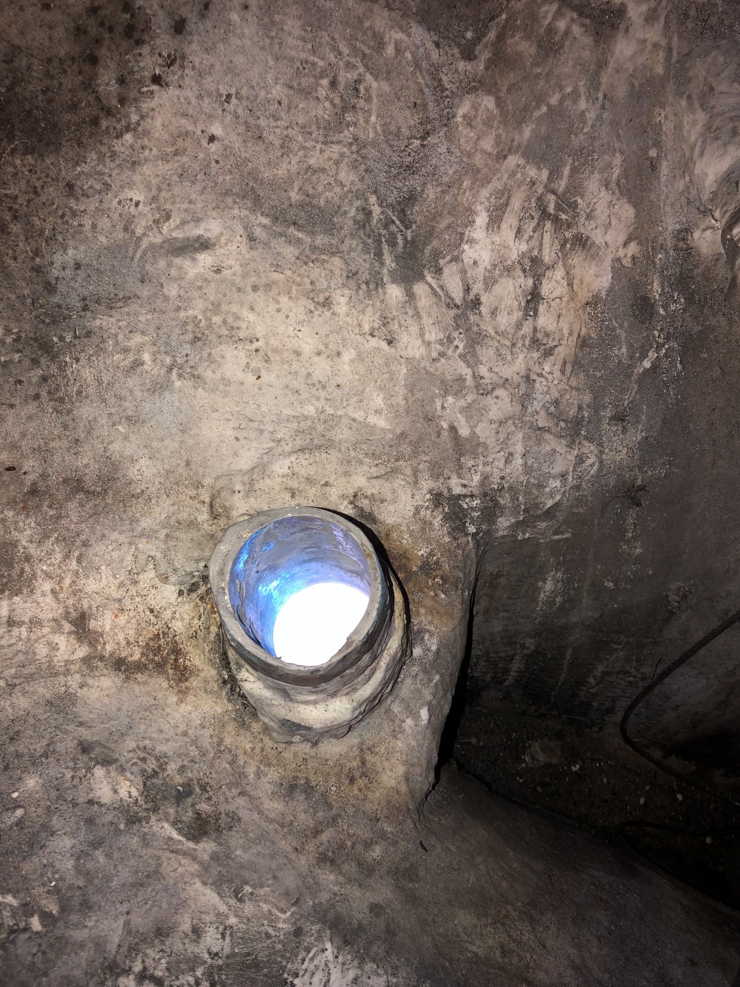

Correction to the post above. The new Centek rudder tube has an inside diameter of 2 5/8”, not 2 7/8“. Also attaching a photo of the new tube cut just prior to glassing.
