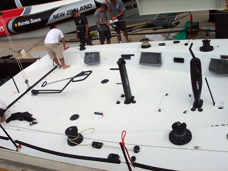

People have certainly put tillers on big boats though, I remember a bunch of sixty foot B.O.C. boats from the eighties that were tiller steering. I attached an image of a current Trans Pac 52 sporting a tiller just because I think it's funny people here seem to have this notion that the Hunter 37 is too much of a beast to tame with a stick.
