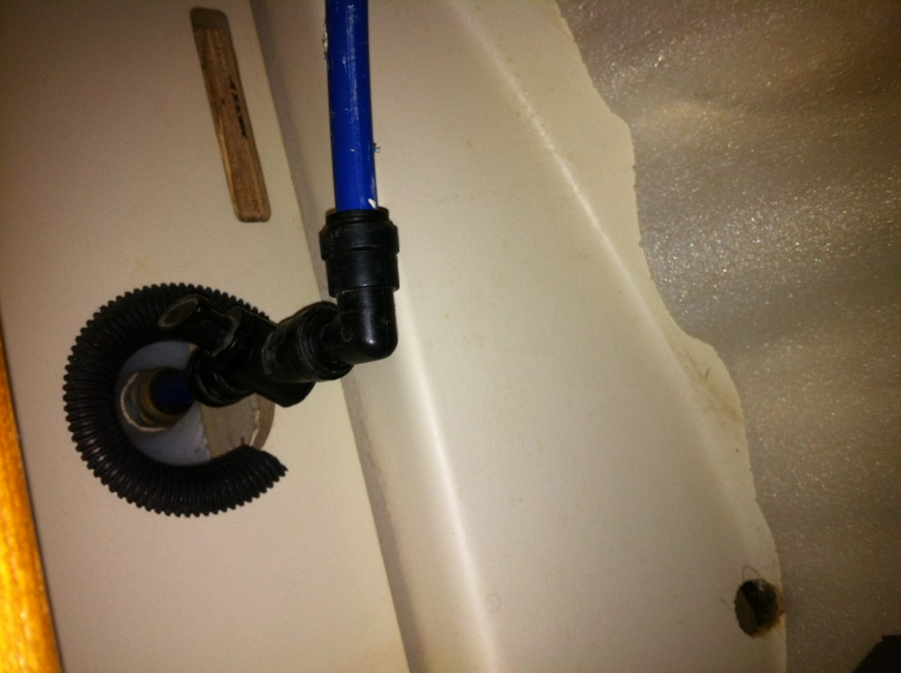

H38 2004 build. If similar setup the water line to the pump leaves the tank at the aft bottom end and then runs to the pump under the galley. There is a valve on tank exit. Picture is sideways (thanks Steve), bleue pipe goes to the right. Access by the storage area under V- berth.
EDIT: There is no tap to empty the tank, just unplug the pipe from the valve, push the plastic ring in before pulling on the pipe, look for Seatech fittings how-to if yours are similar.

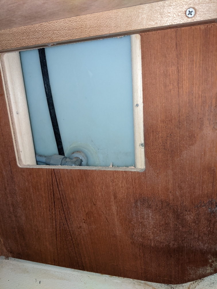

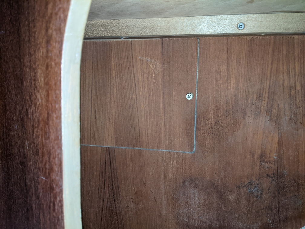

I think I found my shut off (I'll explain the "think" in a moment).

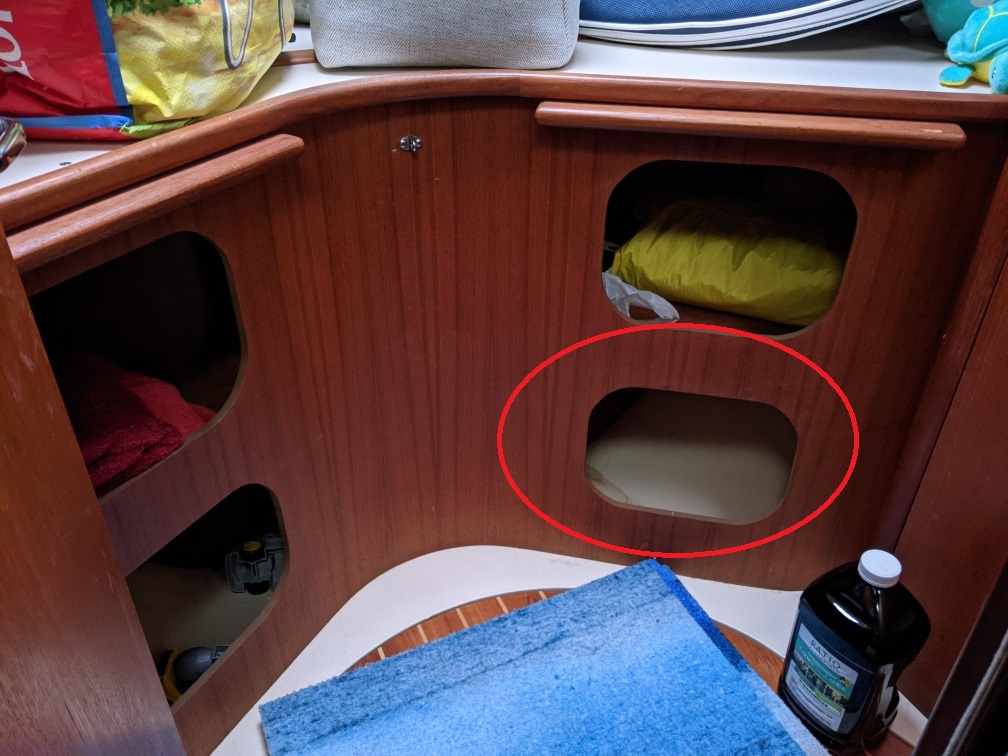

When looking at the vberth there are 4 cubbies, two on top two on the bottom. I found a screwed in access panel in the bottom starboard cubby--exactly where I'd expect the water line to come out of the tank.
I was able to remove one screw, but my screw driver was too long to fit in the space to remove the second screw. I'd already put all my tools away as we were getting ready to leave the boat, so I didn't dig out my stubby screwdriver to confirm--but I'm 98% sure that's the access. I'm heading back up this coming weekend, I'll confirm and snap some pics to add to the thread.

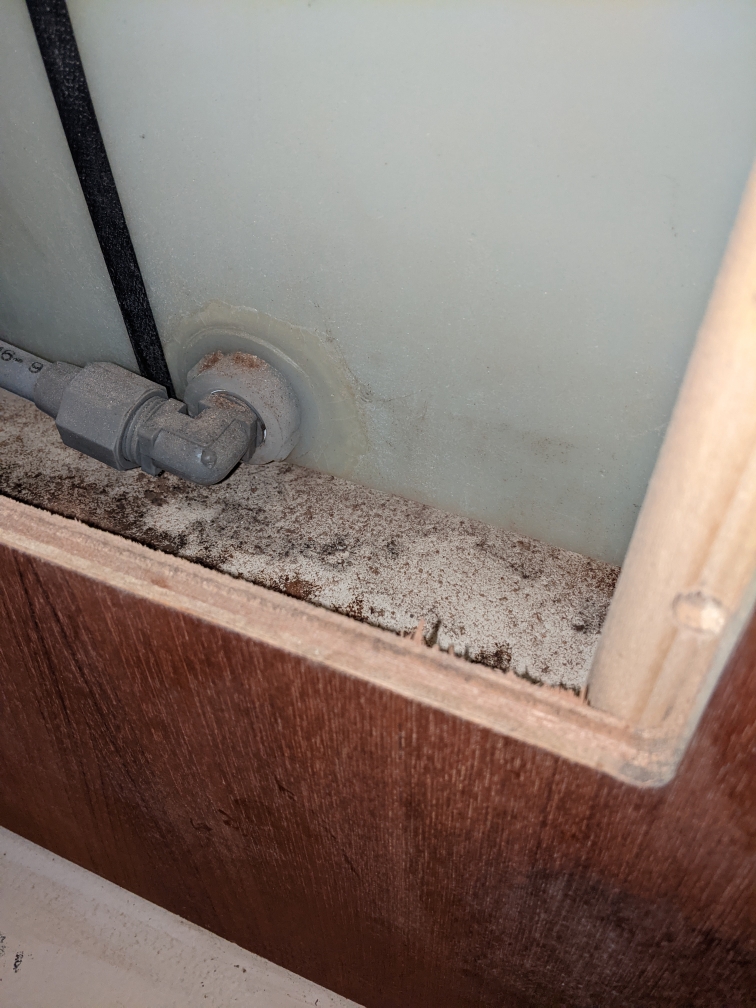

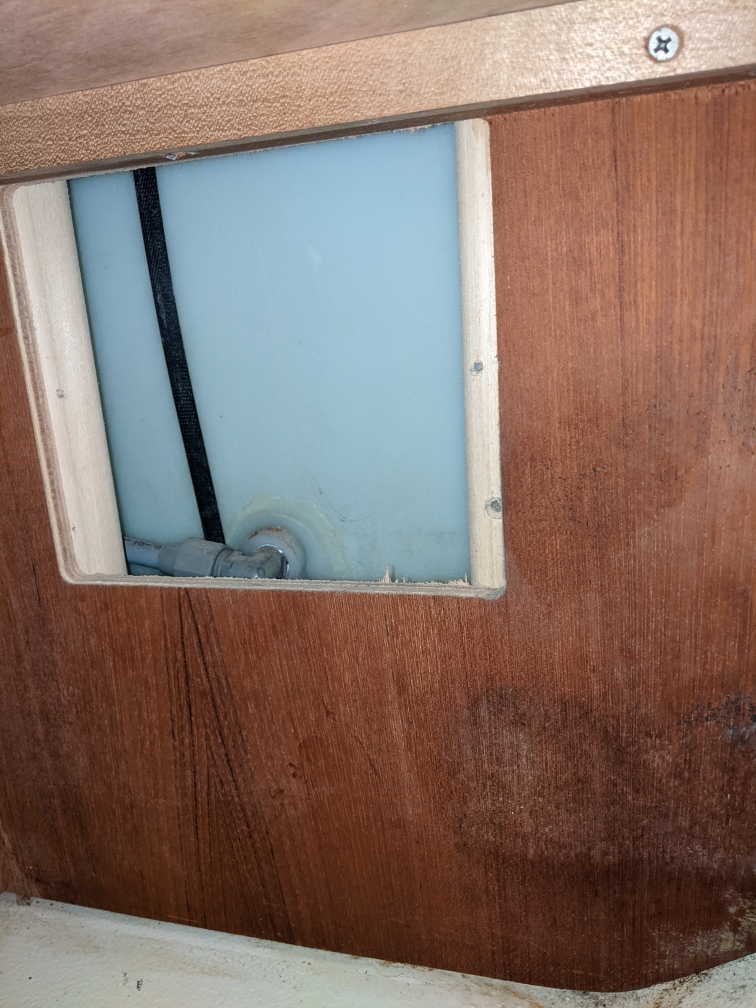

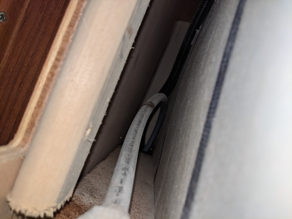

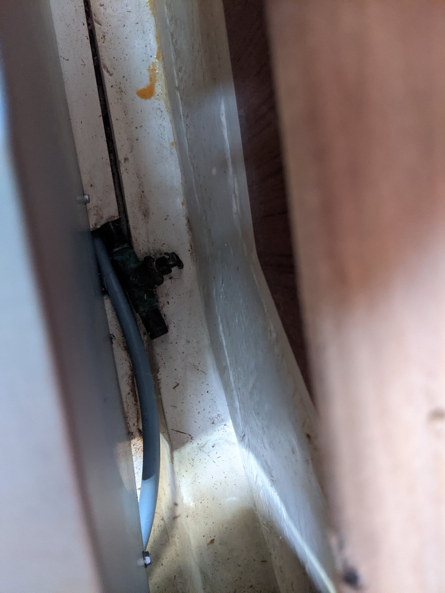

Thanks, @senang ! Unfortunately, the 376 set up is a bit different. I'm posting this as resolution/info for some future 376 owner searching the archives for this info.

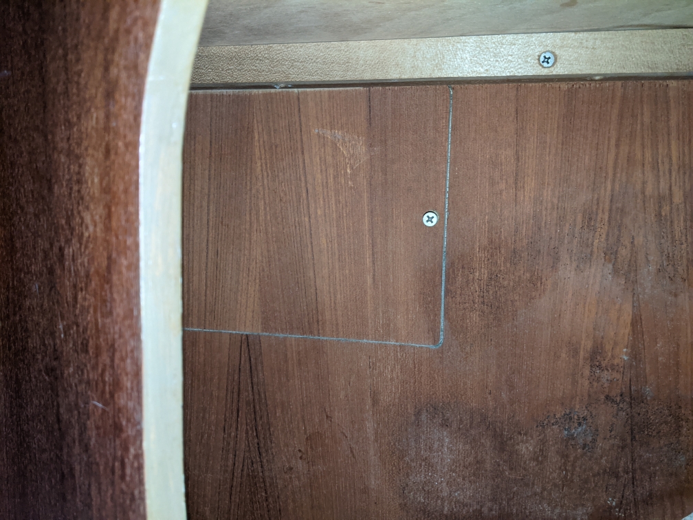

Here's some pics of the access for the 376. It is in the lower right starboard cubby behind an access panel. There is NOT a shut off on the tank, I may add one at some point in the future IF there is enough space (access is tight). It's interesting--they (Hunter) ran the water line to the port side of the boat where it loops down and under the flooring. From there it loops and then runs the starboard side of the boat where it pops up and connects to the pump. The entire run is NOT visible or accessible (from what I can see)--if there were ever an issue with the line I think it would have to be re-run through a different path (or some holes would need to be cut in the fiberglass under the flooring).
The down side to this set up--the fiberglass under the tank pipe leaks directly to the bottom of the cubby which is abutted against the holly flooring....disconnecting that pipe to drain the tank will mostly flood the cabin sole. I disconnected further down where I could guide the flow a little better, but generally draining this tank and avoiding a flood with out running the pump is currently NOT easy. This time around I just ran my faucets to drain the tank then cleaned up the water that remained when I disconnected the hose from the tank. I'm going to add some tee's next year so that I can connect a hose and drain into the bilge.
